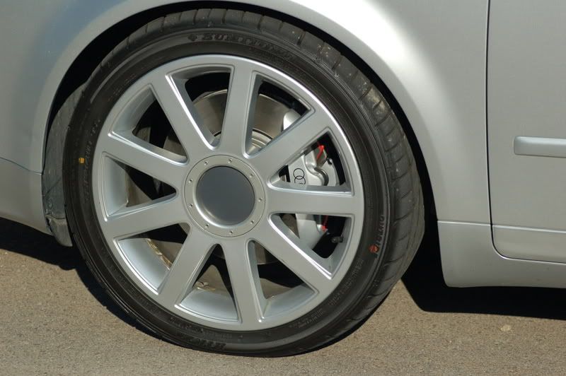

    Will my 18 inch RS6 reps (not sure on the brand) clear B5 S4 front brakes?
    What's the offset? I have RS6 reps and my HP2s fit without an issue. I think the stock ET on the USP wheels require spacers... I think the factory ones are ET45.

    ^^ This is what I've heard. The OEM USPs are either ET45 or ET43. Can't remember which exactly.

    Damn K I need to go home and get my offset. is there another style of caliper other than HP2?
    The B6S4/B7A4 Calipers fit without issue on the USP wheels. I'm not sure how to look up what calipers the RS6s use, but if you could find some specs on those you might be able to figure it out. My guess is they are the same as the B6S4. C5 RS6 right?

    Not from a B5 S4 their referred to as HP2s. My reps are an ET30 offset and have enough clearance...
    Don't mind the under pressure tire...

    Yea, the HP2 calipers are the specific calipers from B5 S4s, some Allroads and other C5 platform Audis as well as the W8 Passats (I think). They never used them on the B6 from the factory.
