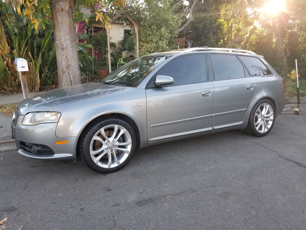

    And this past weekend, I finished up another step in bringing the Avant project car back from being a half step away from the junkyard. Bought it with a bucket full of codes, a holed cam follower and chain rattle at start up. Two weeks ago I started the timing chain adventure...
    Was not sure exactly what to expect, but found this:
    About half the lower guide was missing and the top guide was split in half and the tensioner shaft riding right on the chain. Half of the top guide was wedged between the tensioner and the cam phaser. I took all the precaution I could and fashioned a custom piece of wood to go between the breaker bar and the fire wall to keep that poly drive fully seated and not get out of alignment. Well yeah, that did not work. The thing moved with a loud snap and I am thinking to myself, oh, it came loose. No such luck, it snapped all the poly splines off the bolt, the Assenmacher tool was unphased, but had a piece of the bolt in every groove.
    When I pushed around on the tensioner, I could see the cam phaser moving a little bit. My understanding of the cam phaser is that it should not move/rotate unless the N whatever number gives it oil pressure. Well there was no oil pressure going on, so why was the cam phaser moving? So, to be sure, I cut off the chain with a sawzall and sure enough, the cam phaser moved 15-20 degrees back and forth with ease. Time to order a new cam phaser.
    Long story short, I took a different route and rather than take off the cam girdle, I cut the cam phaser off just on the phaser side of the chain teeth. This cuts the bolt right at the bottom of the chamfer and is about a .150 inch (about 4mm for ROW) clear of the cam. I took the bolt stud out of the cam with 2 fingers. Taking the old cam phaser apart, sure enough, the counter bore that the spring loaded button sits in was totally deformed, it was basically a ramp allowing the cam phase to be whatever it wanted whenever it wanted. No timing codes though, go figure.
    The car is back together, no more chain rattle for 3-4 seconds at startup and no more clack-dack at idle. Soooo quiet, it is hard to believe.

    Nice work. Also, nice looking car - especially like the wheels. From the photo the front looks it's sitting a bit higher than the rear.
    Wheels were from a 2014 S4, $150 for the set, hard to pass that up for OEM wheels. The wide fives it came with were curbed badly, they are in the back yard waiting on a re-furb for spare/winter set.
    The front has the usual S-Line gap that is bigger than the rear. The car is kind of backed into the curb, so it looks worse in this picture than it really is. Maybe B5 caps someday to even it out.
    Still a few things on the list but nothing is urgent, LCA and I will move the S4 brakes from the sedan to the Avant when I put the Brembos on the sedan. I am going to do some logging and if everything is checking out, I might even tune it.

    Very jealous…..
    Every b7 s-line is like that. Avants are particularly reverse raked.
