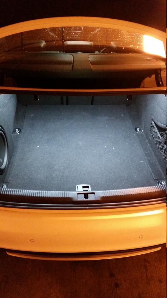

    Thanks but my whole idea is not running wires, disconnecting, reconnecting... I will continue on my research for a lower voltage sub. i am sure must be some out there.
    Planning to wait few more responsed before i jump in the pool with the compD series from kicker. Plus i am not looking for a crazy bass, feeling that i have a subwoofer in my car, because the OEM one is like is really not there.

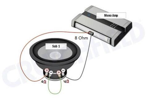

    I found this.
    This could be very helpful for all of us just wanting to swap the sub.
    no need to do it only for a 8ohm one, we can use a dual coil 4 ohm and connect it like this. THis will show the amp like there is 1 8ohm connected

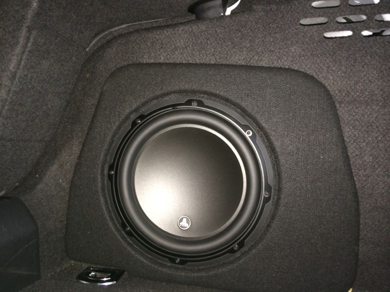

    With the understanding that anyone who wants to "do it right" and get the best performance improvement needs to change the amp driving the sub, can knowledgeable folks chime in here for the best recommendations of "drop in" subs that will be an improvement while being powered under the factory amp.
    I would like a little more bass, especially from the lower frequencies, but do not need a really booming system. I am hoping to just swap the sub (knowing this isn't ideal and I can't expect a huge improvement with stock amp) and take it from there. Would appreciate any suggestions of a good speaker to use given the seemingly limited available power.
    The kicker comp 10c4 is a starting place...

    Quote Originally Posted by gendry View Post

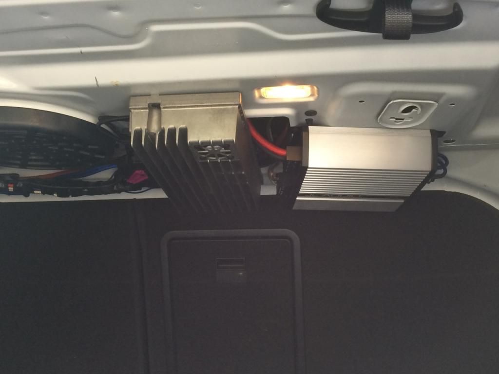

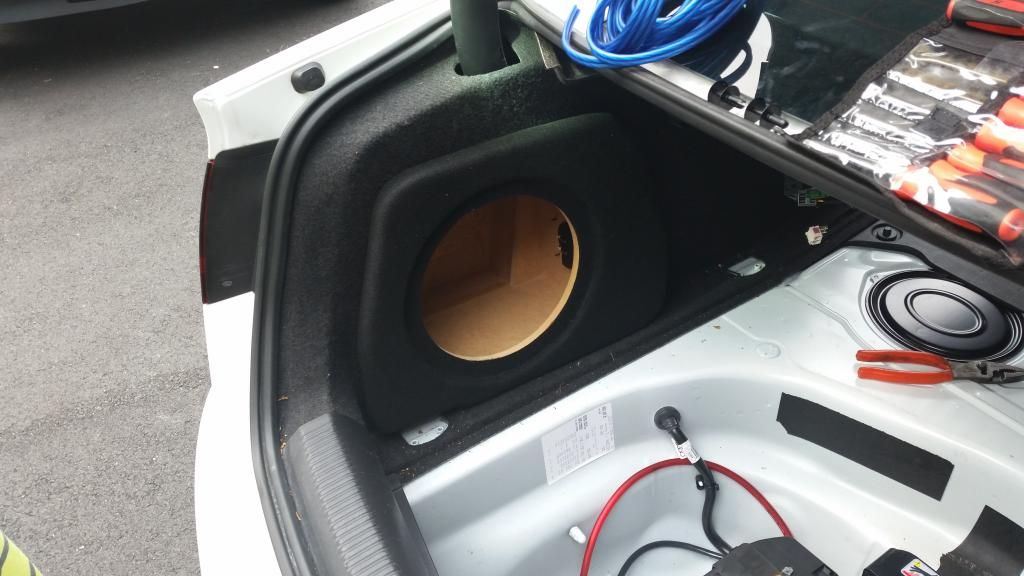

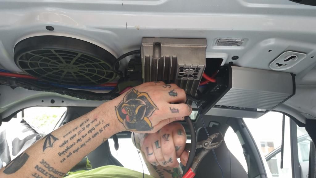

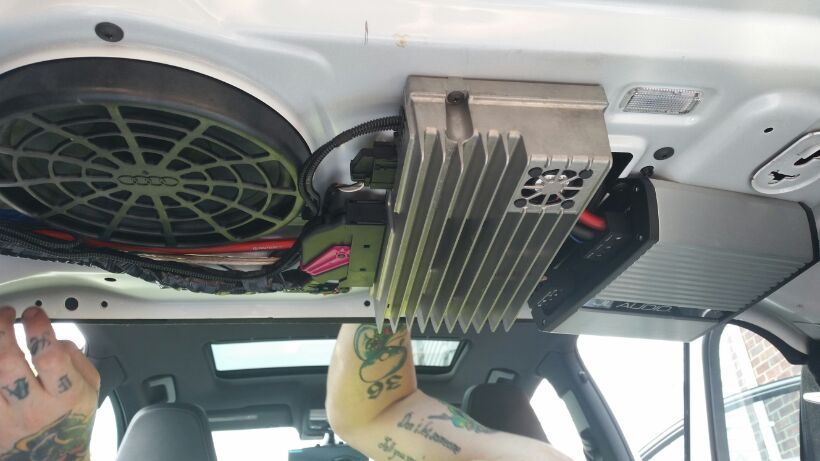

    Bringing the thread back to life. i did the sub and amp installation. i used the blue yellow and white yellow to get the signal that comes into my amp. got a monoblock with lpf and is active just in case.
    HEre is the amp http://www.bossaudio.com/auto/car-au...-audio-r1100m/
    Big question here is the input sensitivity.
    i have 2 options 100mV-2V or 2-4V what should i select to match the factory HU?
    ANy one here had the same issue? or can you take a look into your amp and let me know what should i choose?
    PS: if anyone used a different selection of cables to tap and get the input signal to the amp let me know.

    whats the story with that enclosure? custom made? or stealth box? that install looks sick.

    Quote Originally Posted by Dirty Jersey View Post
    This thread was very helpful upgrading my sub.
    Nice install, where you ground the amps?

    I won't requote the pictures but...
    - did you have to relocate the BO Unit for that enclosure?
    - where did you patch into the factory system? the BO wires? or directly into the existing sub wires
    - where did you get the enclosure

    Quote Originally Posted by doug97gxe View Post
    Not my system but I can see that he relocated the factory amp as well as the new amp to the bottom of the package tray. Using a LOC (line out converter) you can tap the wires into the factory subwoofer and that box looks to definitely be a custom made enclosure. Only thing I would suggest to Dirty Jersey is to remove the factory B&O sub itself...... it will sound much better as the new sub will cause the B&O sub (if it's still hooked up) to be inaccurate along with not allowing for the air of the new sub to pass into the cabin of the car. I initially tried to use my new sub with the B&O hooked up, without it hooked up and completely removed....... completely removed made a world of difference.

    Quote Originally Posted by MVR 155 View Post
    ok thanks... i just bought an ID Max 10 and getting ready to head to my installer
    the JL Amp he is running has a built-in LO converter that would work well enough to be used.
    everything else you said is spot on.
    your installer has to the tools and knowledge to figure out if the line going into the BO amp is high or low and can go from there also.

    Quote Originally Posted by mr shickadance View Post
    I know that some amps have the built in LOC...... wasn't sure if that one did so I mentioned the LOC to the guy making the inquiry.

    Now all we need is a source for that enclosure !!!

    that enclosure is a custom fiberglass one, any local car audio place that doesn't rhyme with est-buy will be able to do it. Expect to pay about 4-5 for it

    no its not fiberglass .. its mdf

    true, your right, didn;t look at the pictures close enough hah

    Any one have the dimensions for the amp? Looking for one that will just "snap in" to the space below the B&O amp.
    Thanks for the help!
