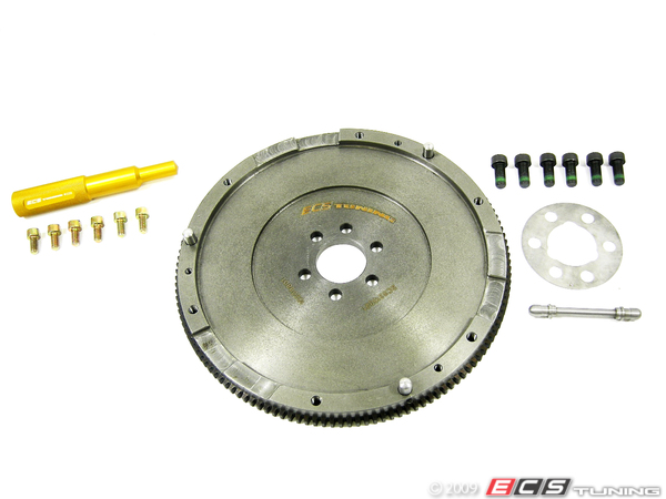

    Get the ECS RA4 flywheel for a B5 (ECS# 12084 - $349.00) and order just the slave cylinder push rod from them for the B6 (ECS#8745 - $19.95) and order a B5 S4 clutch kit from Vast Performance (Stage 1 - $399.95). The flywheels are the same on B5 and B6. ECS basically chargers $100 for that slave cylinder push rod they make when you buy it in the kit. I bought just the push rod for $20. This would get you a setup that will hold pretty much anything your A4 will make and have the stock-like drive-ability (>$800).

    Now that is the kind of advice I'm looking for! Thank you. I'm liking the cost on that combo, I'll go check out the parts online in a second.
    It sounds like you run this setup yourself, you must be happy with it? I'm having a shop do the install for me, did you do yours yourself or have a shop install it?

    The plus side to having the ECS flywheel is you can run pretty much any B5 S4 clutch setup you want. Purchasing everything this way save a lot of money Vs. buying a packaged Spec/ CM 240mm setup.
    Well not 100% true, the ECS flywheel will only work with a full face disk. To use a 6 puck the flywheel has to be be modified so that the springs on the puck disk doesn't hit the bolts. 1 down side to the flywheel is it is really light which means there will be a good amount of gear rattle. This is why most companies make heavier steel flywheels which is better for daily driven AWD cars, the heavier flywheels really help the heavier the car is. Really light flywheels are better suited for FWD cars which have way less drive line resistance.

    The B6 light weight flywheel already comes with the push rod. No need to order it separately. Not sure why there was such a big difference between the B5/B6 flywheel prices. It has been adjusted.

    That's good you guys adjusted the pricing for the B6. Back when I ordered mine, the phone operator couldn't tell me why there was a $100 price difference between the B5 and B6 versions. I just figured ECS was charging $100 for the pushrod, so I ordered the B5 version and then order the pushrod separately. Saved $80 going that route. I also see you lowered the price on the RA4 kit. Back when I ordered mine, it was more cost effective to order the flywheel and S4 clutch kit separate than the kit. Didn't make much sense to me.....
    M-Hood - You are right about the modifications needed to fit a puck style disc, but the OP has an APR 1+. Needless to say, a stock S4 type setup would be more than sufficient. Just giving some cost effective options besides $1,000+ prepackaged 240mm setups offered by most companies.
    Pairing this flywheel with an aftermarket option (Vast) will save some money and hold as much HP/TQ as some $1,000+ kits out there. In any event, going with the ECS flywheel and Vast stage 1 will cost you around $800 after shipping. Compare to $900 before shipping for the ECS stage II setup.

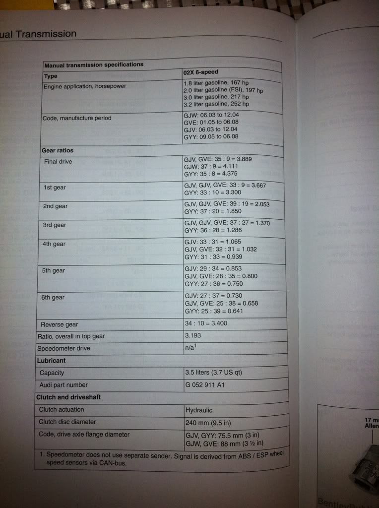

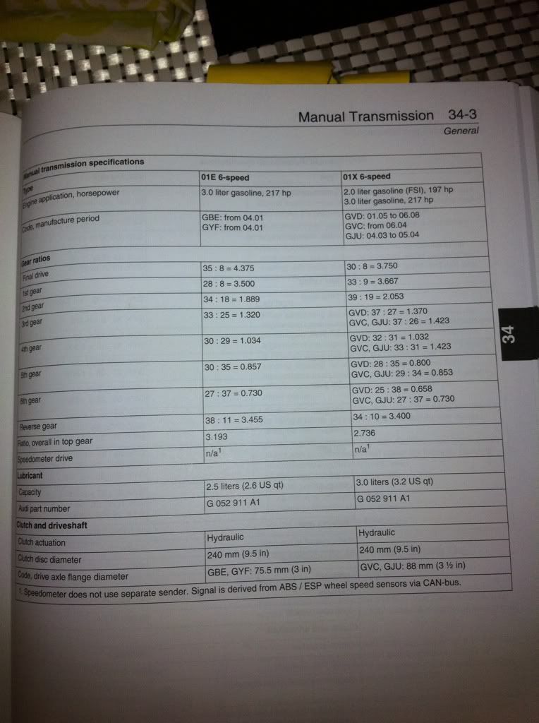

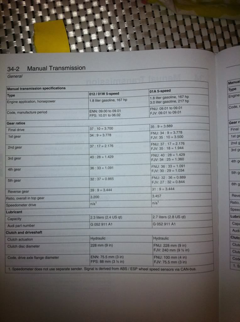

    The Bentley manual I have says that my 2004 1.8t 6-speed (02X) has a 240mm disc. Wouldn't that mean I could bolt up a S4 240mm disc all else being equal?
    Or did I misread it. ETKA says all 1.8t's have a 228mm clutch and its the 3.0s that have the 240mm.
    You must have misread it. All of the 1.8t's (5 speed and 6 speed) came with a 228mm clutch/flywheel. As for the 6 speed and 240mm clutch, it must have been talking about the B7 A4 2.0T which uses the same transmission as the late B6 A4 1.8t with the 6 speed.

    Alright so i checked the bentley when I got home and in fact I was right, at least about them saying its a 240mm clutch:
    02X Trans:
    01E & 01X:
    01A:
    Anyway not trying to start an argument, and Mike, I know you deal with a LOT of clutches so I just want to confirm that the Bentley is wrong. My Trans code is GJW so its definitely a 02X.
    -CP

    Good to know! So im guessing the CM 240mm flywheel included in the FX100-300 etc kits uses a billet flywheel?

    If you go to the Valeo single mass flywheel (which is also significantly cheaper than the OEM dual mass), the disc size is upped from the factory 228mm to 240mm. This is also why any upgraded clutch kit for the 2002 1.8t's come with a 240mm flywheel. There are not any aftermarket kits I know of that utilize a 228mm flywheel. This allows you to bolt on whatever clutch disc and pressure plate you want. I went with the S4's as it's rated for the 300+ ft-lbs that the V8 has, thus, more holding power from a stock, chipped, 1.8t.
    I had installed:
    Valeo Single-Mass 240mm flywheel
    Valeo OE Replacement B6 S4 clutch disc and pressure plate
    OE Slave Cylinder
    Also, to note, I have a 2002 A4 1.8t 5-speed and this all bolts right up and works great. No squeaks, no rattles, just an OE feel clutch with a slightly stronger hold rating.

    See post #23, I dont think the valeo single mass flywheel/clutch kit comes in 240mm. Where did you get yours from?

    Clutch/flywheel are part of the engine not the transmission. The 058/06A come with a 228mm clutch/flywheel, the 06B comes with a 240mm. So on the A4 1.8t the transmission code has nothing to do with the clutch/flywheel. I think that might be where the confusion might be when it comes to the Bentley since it is mixing the clutch info in with the transmission info.
    Quote Originally Posted by Turbo_Whip View Post
    Yes, the CM 240mm FX100-FX400 all come with a steel flywheel. The test CM 240mm kit came with a billet aluminum flywheel, but after that 1 it has been nothing but billet steel since it is better for a daily driver.

    Been dealing with A4 1.8t clutch kits for 10+ years and that would be news to me and I have had the Valeo clutch/flywheel kit in my hand right at Clutch Masters and pretty sure it was 228mm. Nearly all of the clutch/flywheel kits on the market for the A4 1.8t are 228mm. The ones that offer 240mm conversion kits are Clutch Masters, Spec and ECS.
    Wish to post up a Valeo part number for a 240mm A4 1.8t Flywheel?
