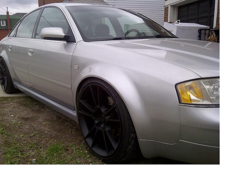

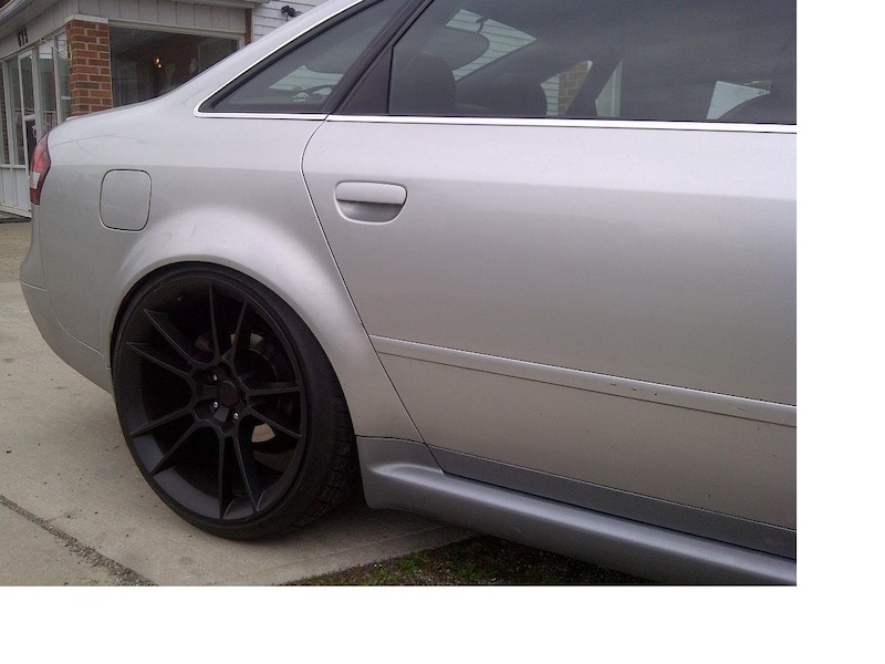

    Well, I still havent got the heads back from the shop. In the meantime, Ive done a few more mods
    JHM short shifter (med spring) and derlin knob
    LED tail lights
    Plastidipped the wheels black :)
    After doing the wheels, all the chrome trim is really starting to bug me. It will be next to be blacked out when I have the time, along with the mirrors.

    Starting to look like a muscle car, in a good way.
    Clear corner those headlights already!

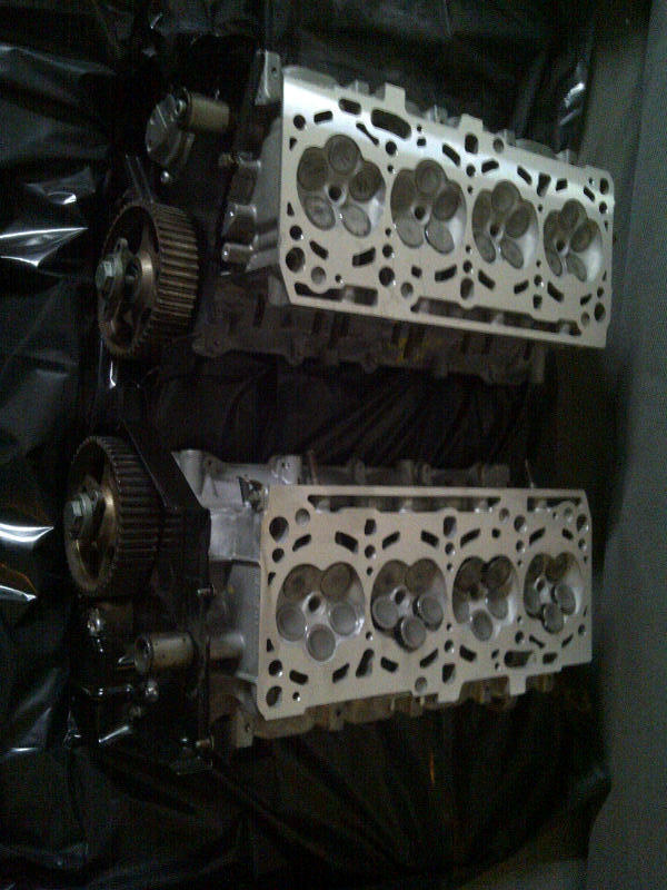

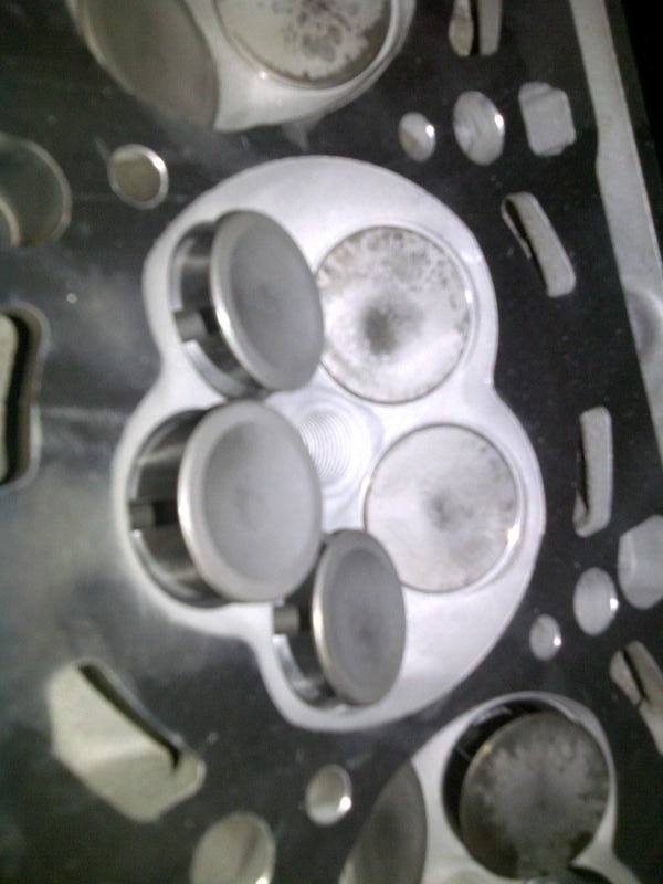

    Finally got the heads back from the shop! Ported, polished, and all cleaned up. Apparently, quite a lot of work was done on the porting.

    Yeah, me too. We will soon see if the porting experiment nets me a nice HP gain, or if it was a waste of seventeen hundred bucks. Fingers crossed :)

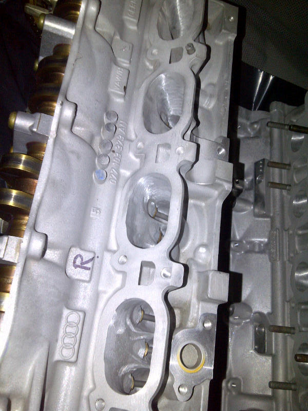

    Gord Bush who did the head work, said that he did quite a bit of porting on the exhaust side, IIRC. He said that it should really open things up up top. We will see. I hope I dont lose too much on the low end. With your headers, I think your car would probably benefit even more. Anyway, we will have to see what happens with mine.

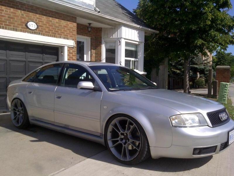

    latest pic
