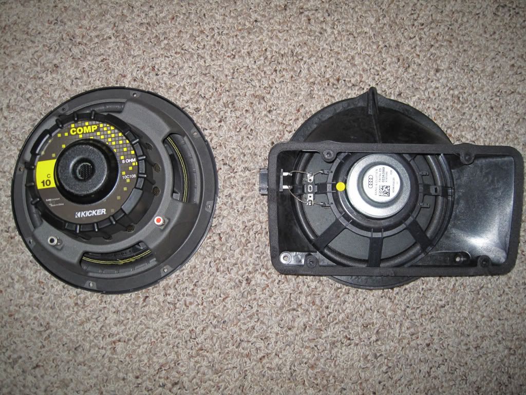

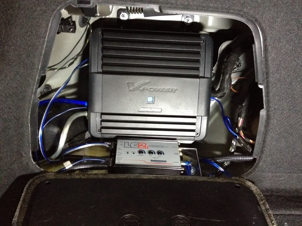

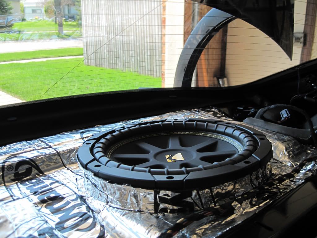

    I went with a 10" 10C108 Kicker subwoofer. It fit perfectly with a spacer in the stock location. It was a nice improvement over the original BO subwoofer and with the stock amp. I later added an active LOC and an Alpine M500 amp to drive the sub, which improved the sound even more so. Spent less than $300, didn't sacrifice any trunk space and couldn't be happier with the results.

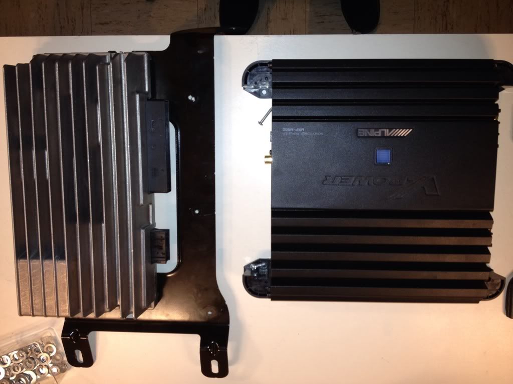

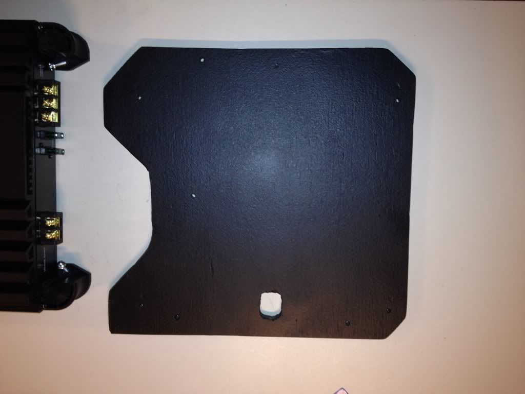

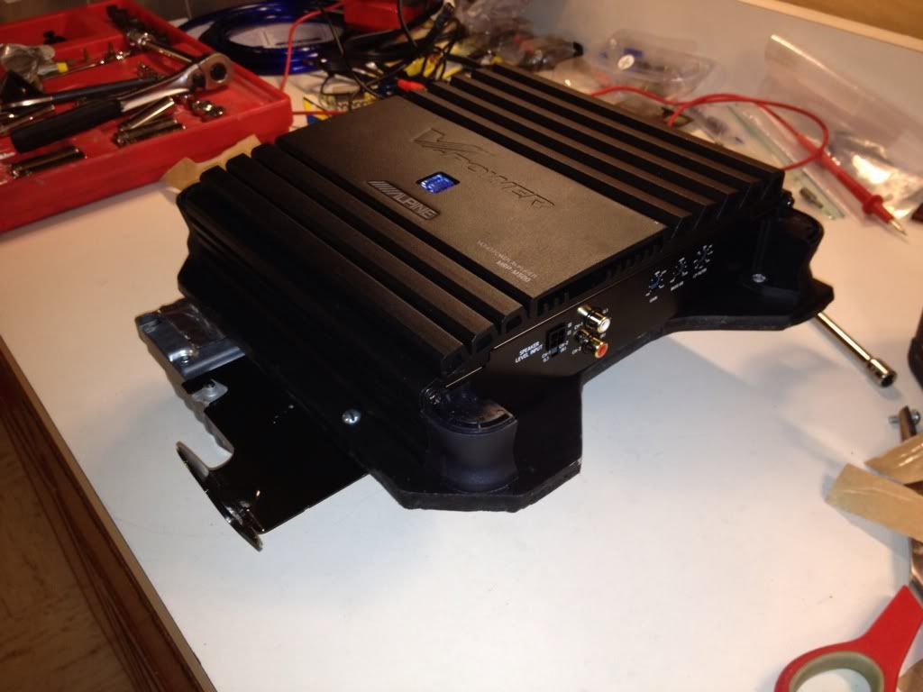

    The stock amp was installed upside down, on the back side of the factory mounting bracket.
    Made a plate to mount the Alpine amp on the stock amp bracket, and mounted the OEM amp on the backside.
    The stock amp is mounted behind the Alpine amp.

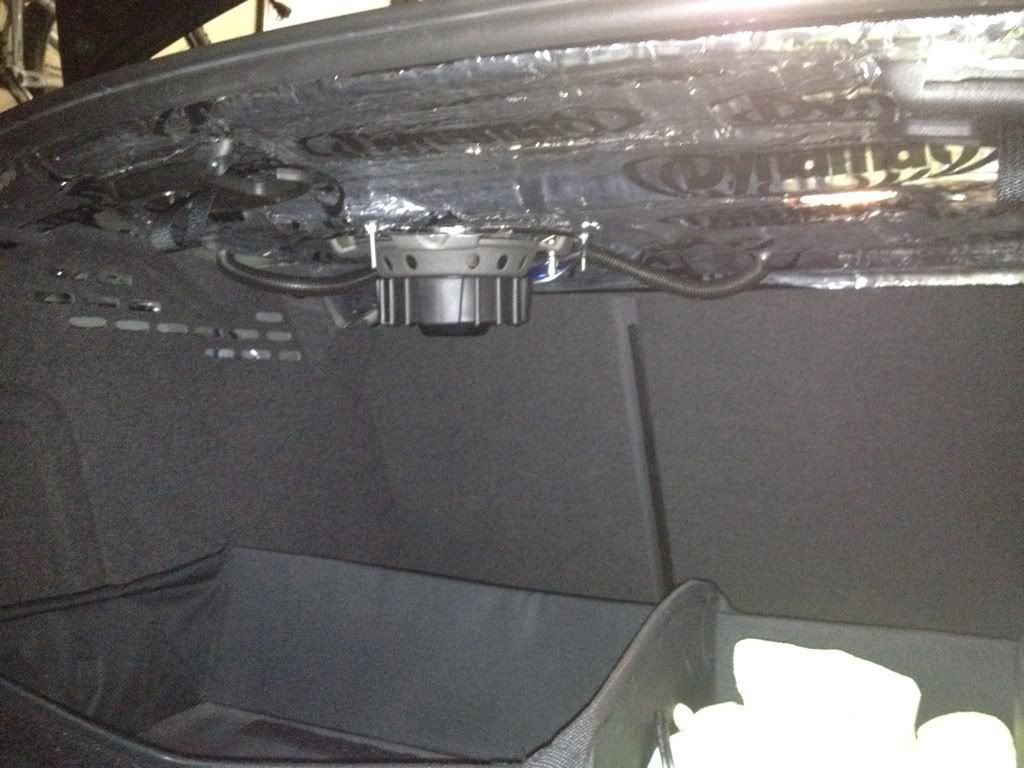

    Thanks A LOT for posting this. Will save me tons of time when I start this project....SO just to verify, the back deck lid went back on with no issues?
    Any pics of sub from inside the trunk? Like how it hangs down?
    Also, it looks like you replaced the stock amp entirely. Is this true? How did you power the rest of the car if so? Not sure why Im so confused from the pics. I need to take a look at my own trunk to see what im missing here.

    Just took a picture of the trunk. Really does not hang too low. The spacer above the deck uses up at least an inch.
    The stock amp is mounted behind the Alpine amp - see photos above on the mounting of the two amps. Stock amp will not be visible once the assemby is installed the vehicle, but it is there!
    Back lid went on without issues.

    Ok, saw the pics again...makes sense about the sub!
