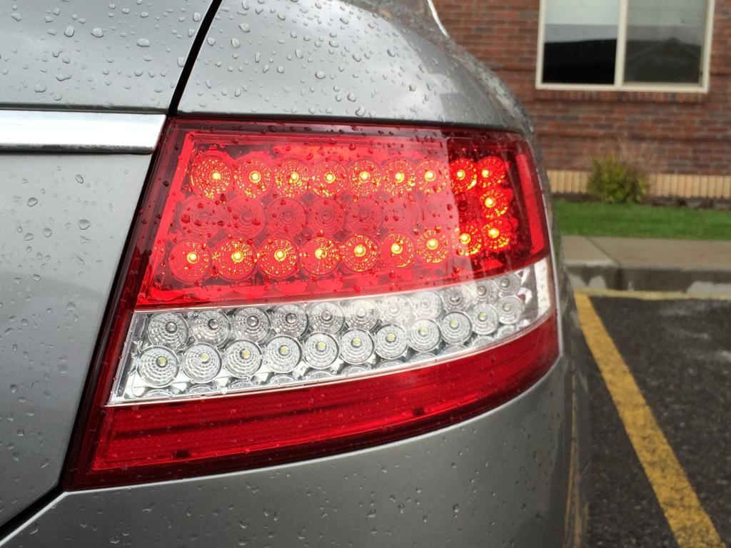

    73992
    brooklyn New York
    hey formula, let us know how that install goes.

    I do believe every US A6 C6 came with LED tail lights (The LED strip at the top). In Europe i do believe the standard tail lights use only halogen bulbs?
    So i do believe coding is required but its just switching the car to think that these are the non-LED lights. Very easy, but requires a VAG-Com.
    Will update when i get them. Shipping is probably going to take a while.

    Sorry for the late response, the lights worked out great! I think they make the car look much newer. The shipping took forever and the lights were at customs for around 2 weeks..... (Damn you Sons of Anarchy!)
    Coding them wasn't as straightforward as I thought it would be, and took me a little while to figure out. The instructions say that you only have to subtract (0131072 = Highline) from your comfort system coding value, but it never accepted it. I finally figured out that you first have to subtract (0004096 = SAE Rear Lights) and then the 131072 for it to accept the code and get them fully functioning.
    Results:
    By the way, does anyone have any recommendations for a product to get rid of oxidation on the aluminum?
