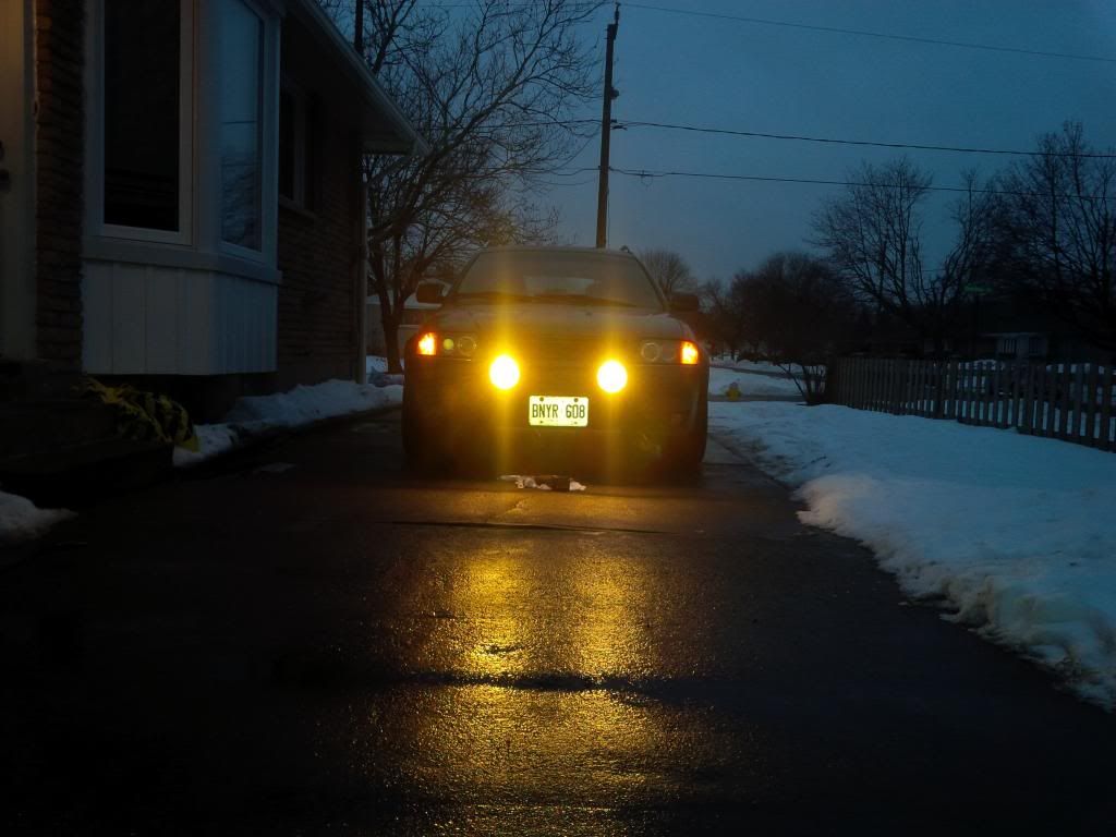

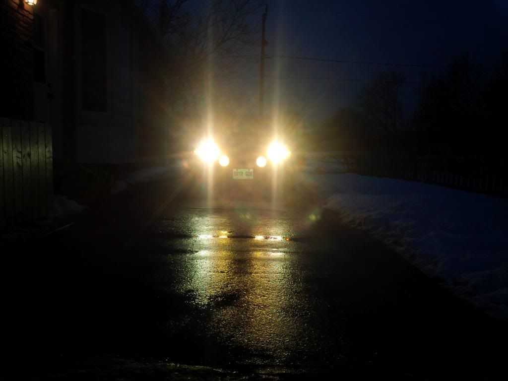

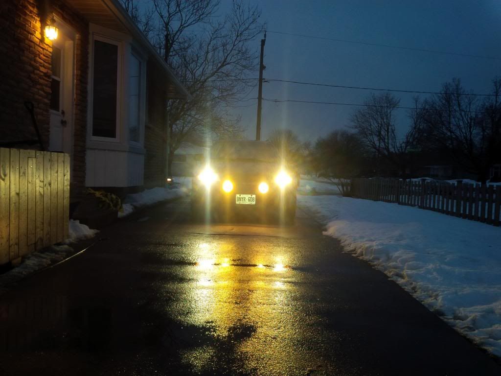

    installed these, and found a ground lug that didn't even have a nut on it!! electrical problems hopefully solved!! the one under the coolant tank had no nut on it, but it was sitting stuck between a heat shield and the firewall. anyway the PIAA lights are on now will likely upgrade to 100W HID in the future but wanted to get them on and see how they looked for now. need a bull bar that's for sure. anyone who knows anyone who purchased the MTM bar please forward me their info. im just looking for measurements and I build one myself. but for now 2 ill add the 3rd one when I get me PIAA mounting brackets, I made some up myself last nite cuz I couldn't wait any longer!!
    just the PIAA lights
    highs and PIAA
    lows and PIAA
    the yellow im not a fan of but I guess that's how PIAA bulbs are, maybe the housing has a hue of yellow to the lens as well. ill go out on the road in a bit to see how they are!! but I think 1 more is necessary id like to get a pencil beam style for it but have not been able to find anything in a 100W.
