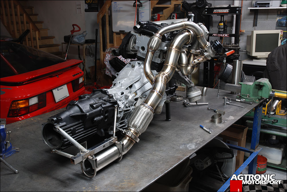

    I started with this outside the car. That's a Garrett 50-trim with a 5-bolt to v-band adaptor. Just eyed up the engine bay and did a few quick measurements when I made the downpipe. The dump tube was an Ebay $10 special. I ended up using the flange from it and bought a 90 and two 45's to make the tube drop before the axle then wrapped it in heat wrap.
    Tear down
    Freshly rebuilt 2L block, same head/manifold/turbo
