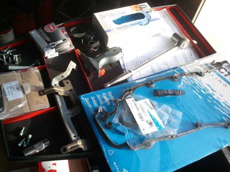

    Little update on my end. Last night I got a chance to install my timing belt kit. New timing belt, water pump, thermostat, pulleys, tensions, etc. According to the guy I bought the engine from it was recently done, but I wanted to be on the safe side and replace it anyways. Some of the parts I removed were pretty rusted anyways, so I'm glad I did.
    Next on the list is to do valve cover gaskets (probably going to clean up the valve covers and paint them too) and cam chain tensioner gaskets. Putting some new plugs in as well. Two of the coil harness connectors were damaged in transport so I need to fix those as well. Sorry I don't have many pictures of anything other than this one of my buddy slaving away on the engine lol.

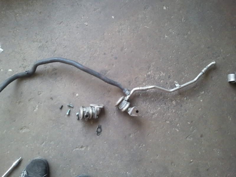

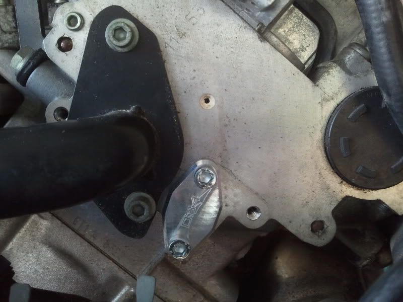

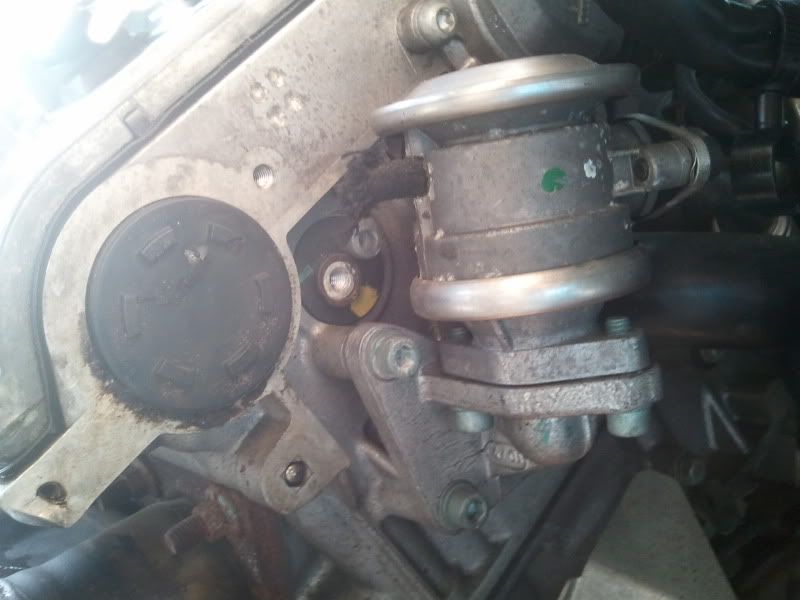

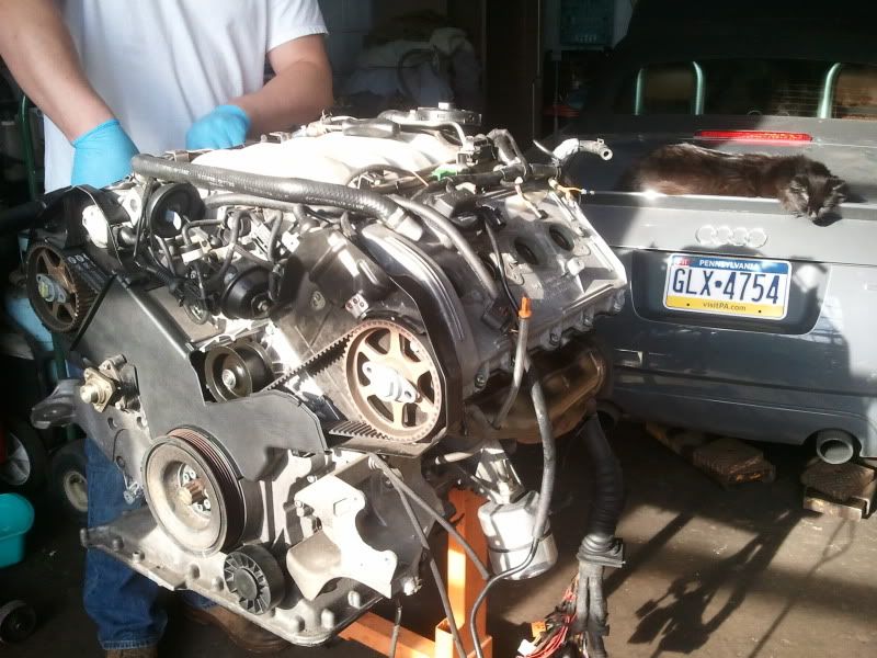

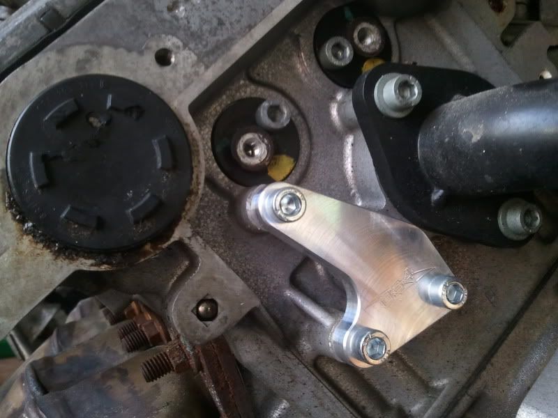

    Did some more work today. Installed my 034 SAI block off plates, changed out the spark plugs, and sorted out some of the wiring issues. Lots of cut wires/connectors on my engine so I've been living in a sea of wiring diagrams for the past couple days trying to piece everything together. Still waiting on a new valve cover (right side has a big hole from loading the engine with a fork lift during freight) and once that comes in I'll clean them up, paint them, new valve cover gaskets as well as cam chain tensioner gaskets and cam plugs. Picture time!
    Before SAI removal:
    After:
    Good riddance worthless engineering lol
    The engine as it sits now:
    Parts installed and/or waiting for installation:

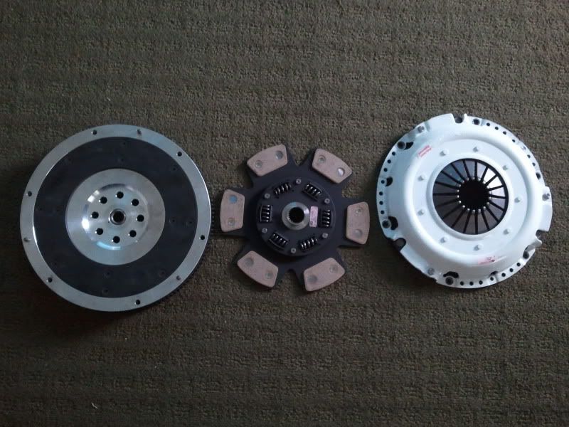

    clutch setup has been ordered, went with a FX400 6 puck.

    On another note, look what arrived today.
    Life is too short to drive ugly cars.
