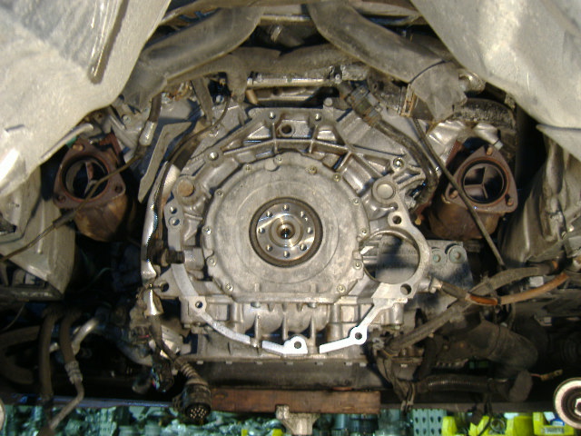

    Contrary to what was posted on the previous page, the S8 crank has an 8-bolt pattern, NOT 10-bolt

    yeah older V8s and the RS6 are a 10 bolt, the rest are 8 bolt and the standard flywheels go right on. I'd buy that motor personally, see if they can run a compression test on it for some piece of mind
