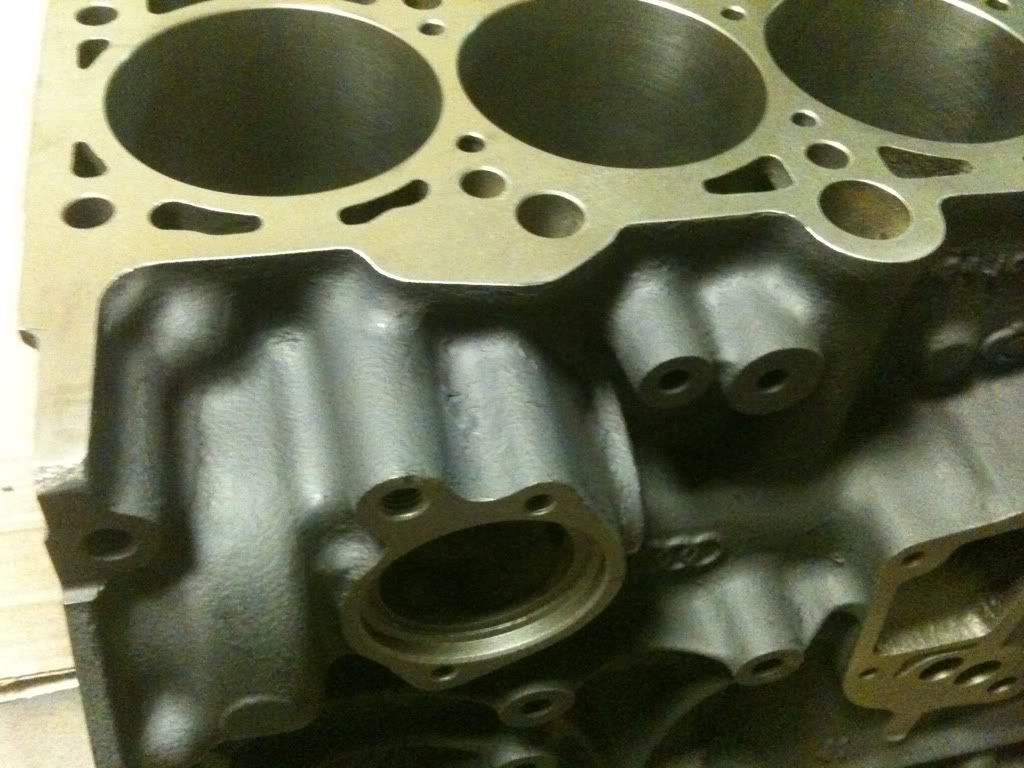

    Sooo cleannn! Looking good what was the final bore diameter?

    Yea it come out good.... 82.5

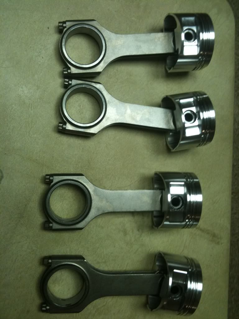

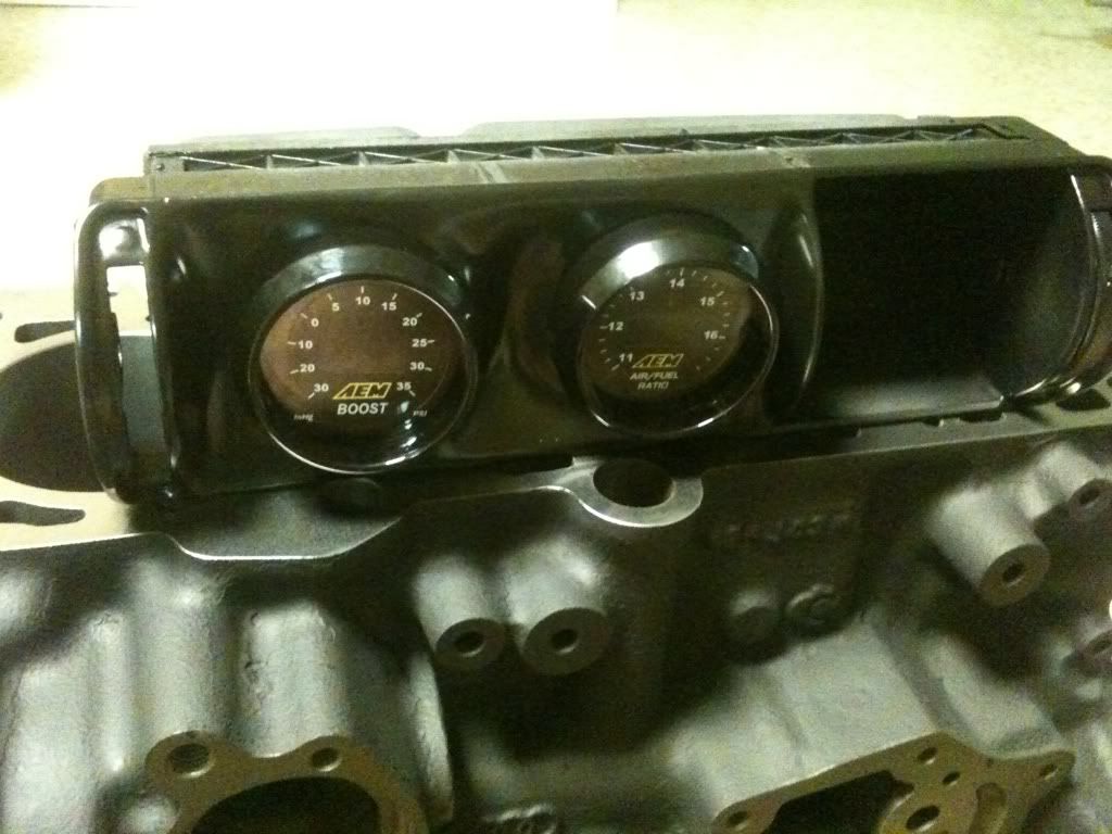

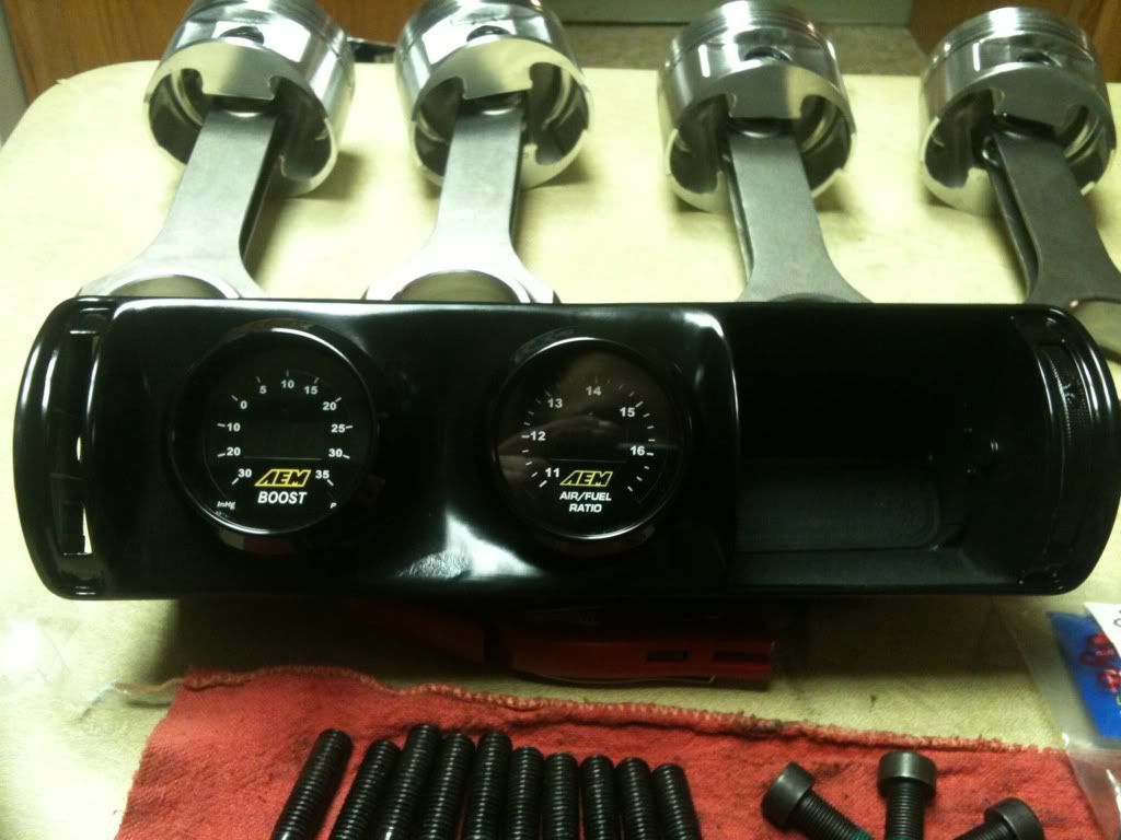

    ARP head bolts, ARP main studs, OEM crank bolt, OEM flywheel bolts.
    Hung my pistons.
    Test fitted my gauges to the custom pod.
    Also plasti-gauged my crank and rod bearings, cleaned the shit out of my dual mass flywheel, still haven't cleaned my engine bay. I'm not sure how I'm going to do that as I don't want to f*ck up my driveway, I might get it towed to the car wash down the street from a buddy but idk yet. That's about it for now, I hope to start assembly next week sometime.
