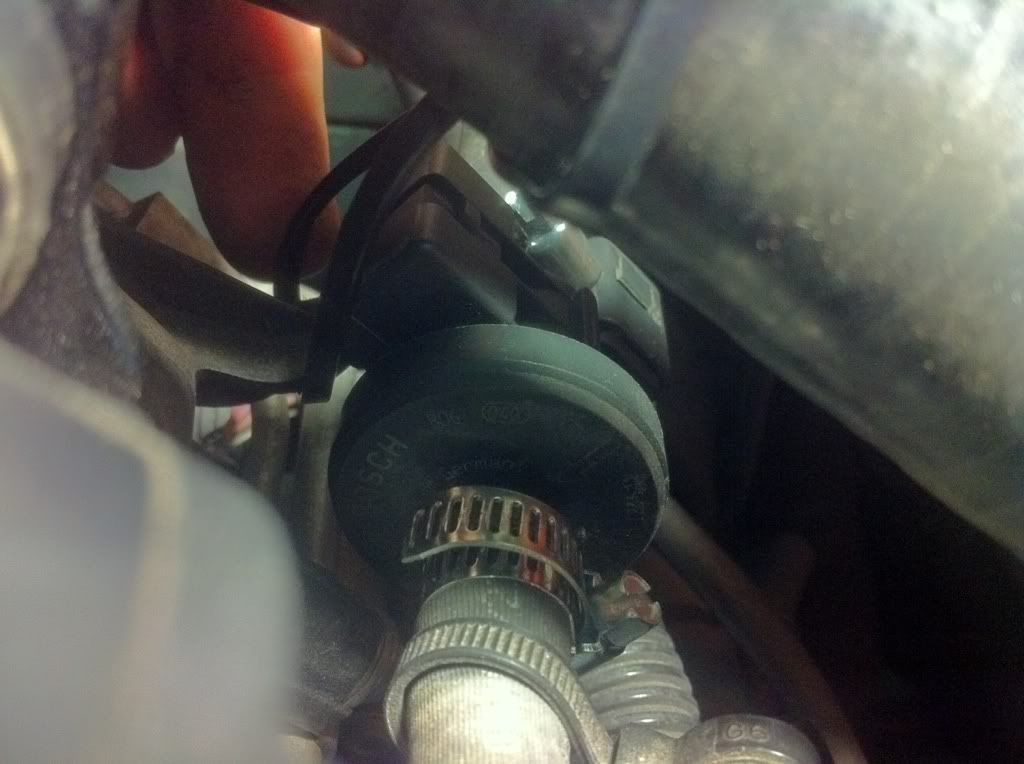

    So for people that installed the 034 for OCC or any OCC for that matter, did you remove that check valve that is inside the tube going from the valve cover to the compressor housing on the turbo? There was a thread about knocking noise from the intake after the 034 OCC was installed.
    Quote Originally Posted by Laszlo@034 View Post
    You're likely hearing noise resonating from the check valve built into the tube going from the valve cover to the compressor housing on the turbo. Usually it's not audible unless you have an aftermarket intake.
    This piece, for reference:
    FWIW, you should be able to remove that check valve from inside the tube once the CC kit is installed. I'll probably get around to it this weekend and make a DIY.

    Quote Originally Posted by thenofjboy View Post
    I did not remove the check valve nor have I experienced any 'knocking noise" from the intake yet

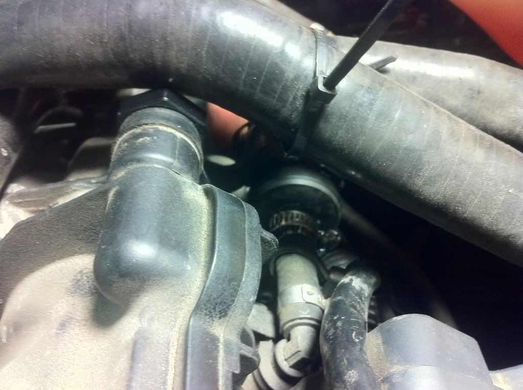

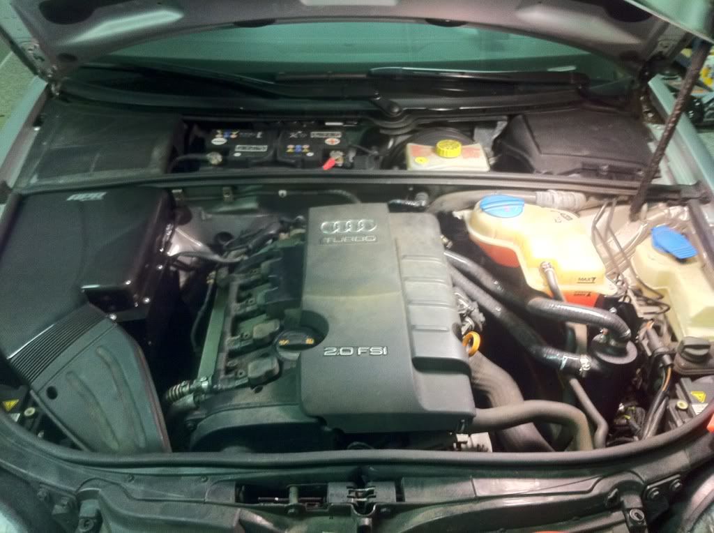

    Update: I installed my 034 Motorsport kit on sunday afternoon and this afternoon, I began to hear the "knocking" noise coming from the intake area.
    What is that noise from technically? Is it bad to drive like that? I'm going to try and remove the valve ASAP. Probably tomorrow. Does anyone have any idea how to remove those clamps? That secure that hard line/hose to the the valve cover?

    Yeah, those are just the OEM single use clamps. You'll need to get new hose clamps to replace those. If you look closely at the clamp, you will be able to pinpoint a tab where the clamp overlaps itself (think 80's snap bracelet). Easiest way is to pry this up slightly with a knife, then pull it away and up with needle nose.
    What is that part, what does it do, and how does a catch can make it click?

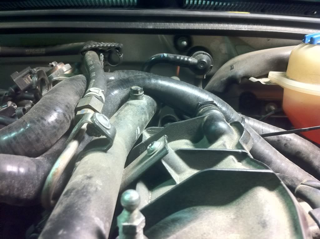

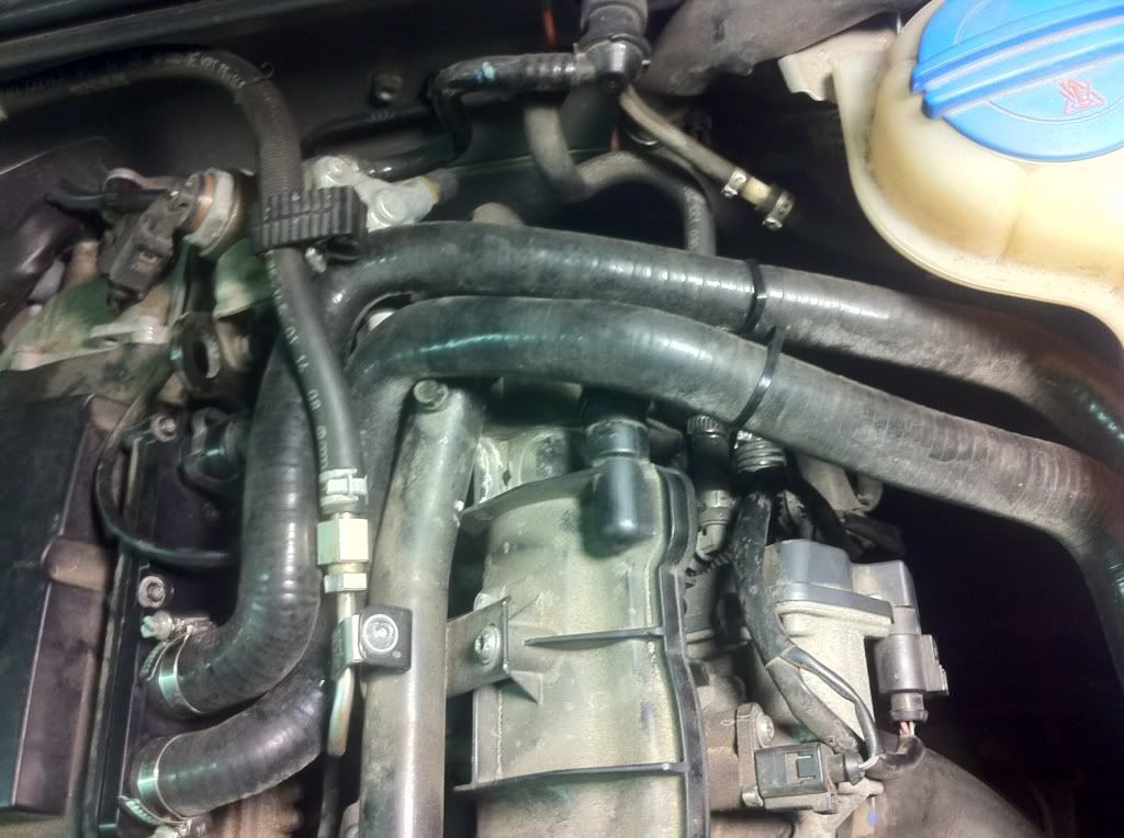

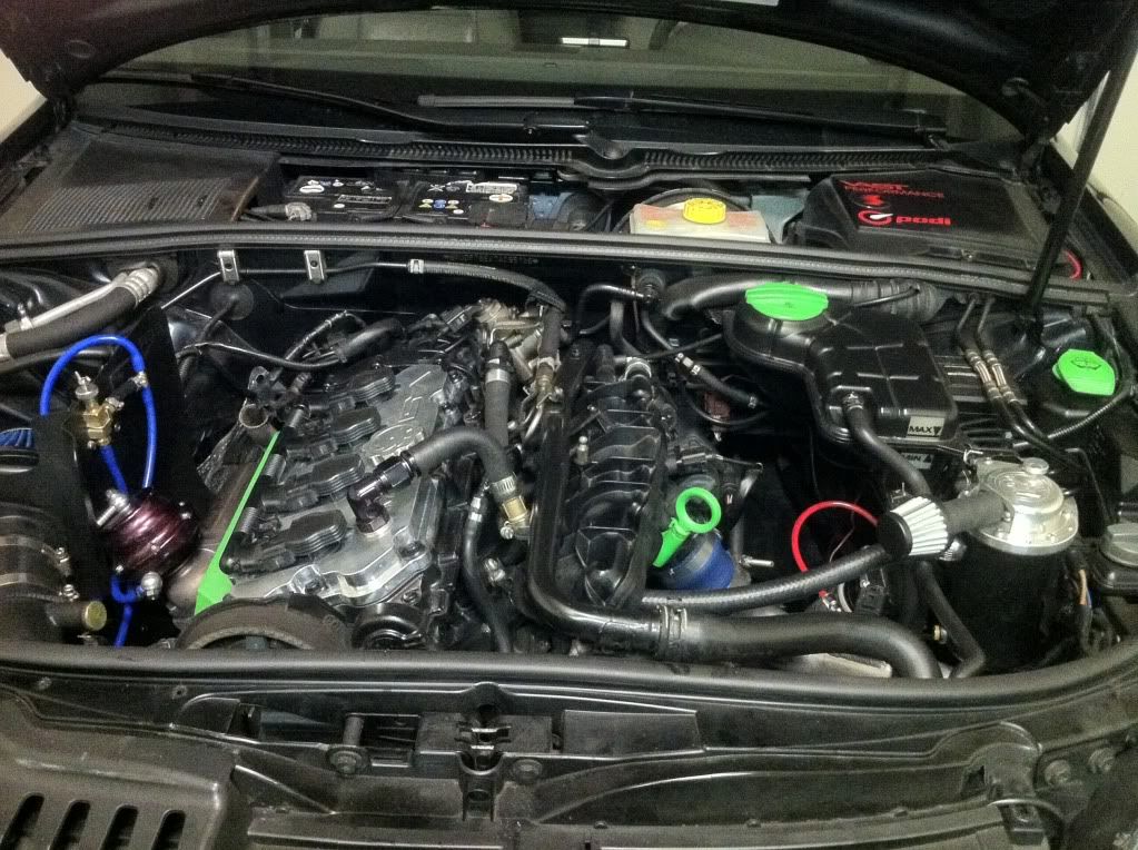

    In the second image on the first page, the opening known as the 'exaust turbocharged gas outlet' does what exactly? On my engine it is blocked off at the engine.

    can anyone answer my question about the 'exaust turbocharged gas outlet'? Mine is blocked off in a way that is unusual it seems, and Id like to know if I should re-route things.
    http://www.flickr.com/photos/6188892...ream/lightbox/

    I left that part connected. I don't know what the pros/cons of blocking that off would be.

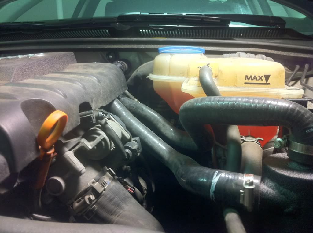

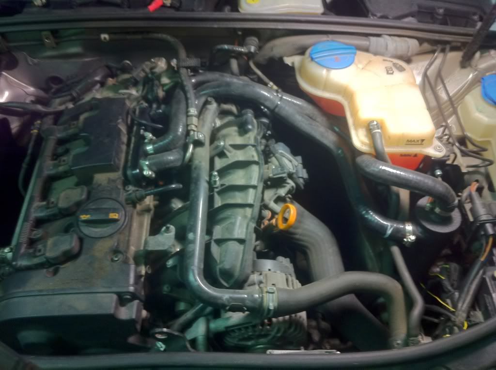

    034 CC Pro Tip:
    Just figured out how to run the 034 CC and keep the engine cover with no trimming
    Put a zip tie on each hose at about this location. leave a little slack so you have some wiggle room
    Located the N80 valve and the support for it. Put a ziptie around the bottom of the support and through the zipties that are already on the hoses
    (by my finger)
    pull the ziptie around the N80 support tight so that it pulls the hoses downwards
    the hose closest to the front of the car will be squished a little but there is still room for flow
    install the engine cover and check fitment. tighten zipties as necessary
    look ma, no trimming!
    -Mike

    Heyuh, just wanted to share my findings with the 42DD catch can.
    Decided to clean the sucker out after several drainings.
    Here is the top removed, as you can see there are two baffles seperates by a 1/4" or so, what you can not see is the third baffle and screen below those.
    Here is the can itself, your looking at the INLET
    And here is the some of the junk that was in it
    No fuel, just oil and water
    I found it odd that the 034 vortex can inlet port is on the top.. I wonder what happens when the level of the can fills past that long tube, it must bible or gurgle? Idk
    I'm strictly basing this off of the photos I see above.

    Installed BSH CC on B7 Avant, installation was followed. After around 4000 miles, trying to drain oil for the 1st time, not even a single drip of oil. But checked the oil stick, missing half quart of oil. What happened? Burn it somewhere? 70/30 Hwy/City driving, 24 MPG quite low... :-(
    All feedback is appreciated.

    Quote Originally Posted by DRAKLORE View Post
    Yes this should help with carbon buildup, combine catch can and meth and I don't see carbon buildup ever being a problem.
    I can vouch for the 42DD, has internal baffles, great looking can available in numerous finishes. Competitive price. Only drawback was having to retrofit it for the B7A4 bay because it's made for the mkiv Gti

    Vent to Atmosphere setup on my 42DD
