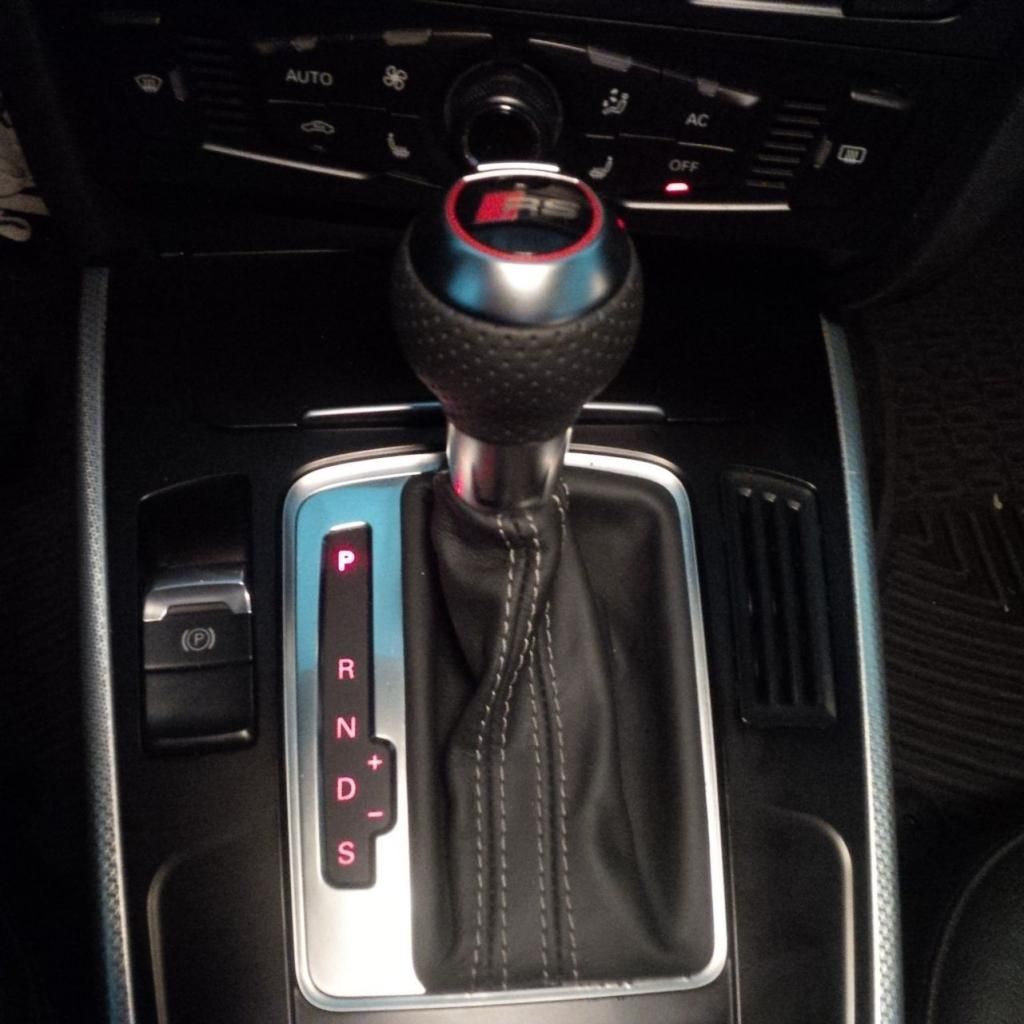

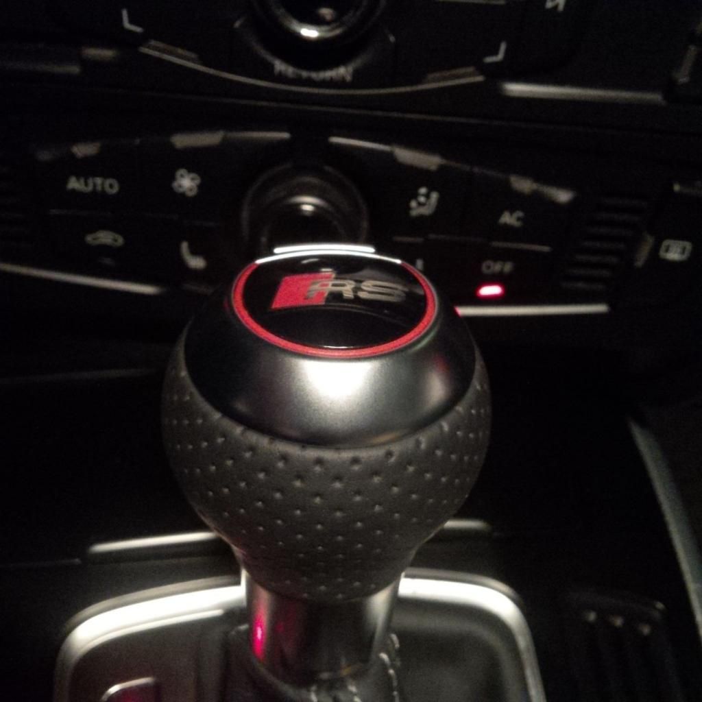

    I just received mine in the mail from Alex! I'll have to install it in about a week or so, but I'm really looking forward to getting rid of the ugly, clunky auto shifter and looking more like a 6-spd.

    Finally got it to work! Thanks!

    Quote Originally Posted by Maximum View Post
    Hooray! Happy to hear :D
    What was the problem?
    Bryan
  16. #56
    Veteran Member Three Rings Maximum's Avatar
    May 27 2012
    94181
    My lounge
    Galt
    I took off the knob and heated and twisted about a centimeter it seemed and it worked! I didn't think it would be so temperamental! The button does not stick out much does it? Or is it me but at least the button works now! I was not going to settle until i got it right!
    Thanks again for your help!

    Hello everyone,
    Finally knob is fully functional all you have to do is use a sharp nail filer and file around the top and side areas of the plastic to make it smooth and then try to place the knob on the stick and keep repeating unless you have a smooth button press.
    Big thanks to brainpan without his post this was not possible.
    [IMG][/IMG]
    [IMG][/IMG]
