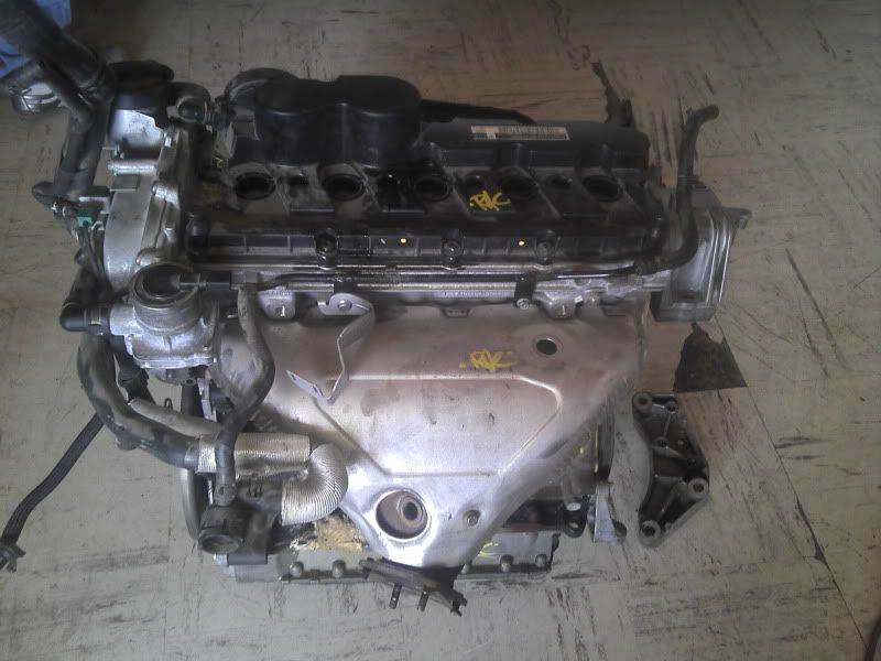

    Has anyone contemplated swapping a 2.5 I5 *THE NEW ONE* engine from the jetta/rabbit vs a 24v vr6? I'm not personally looking to do it (unless my 2.0t engine were to go) but after reading a lot about engine swaps on here, the cost of acquiring one is more than half the cost of a 24v vr6. Plus, i'm guessing there could be a chance that the flywheel pattern would bolt up the same as a 2.0t vs 2.5 as it does with the MKV platform.
