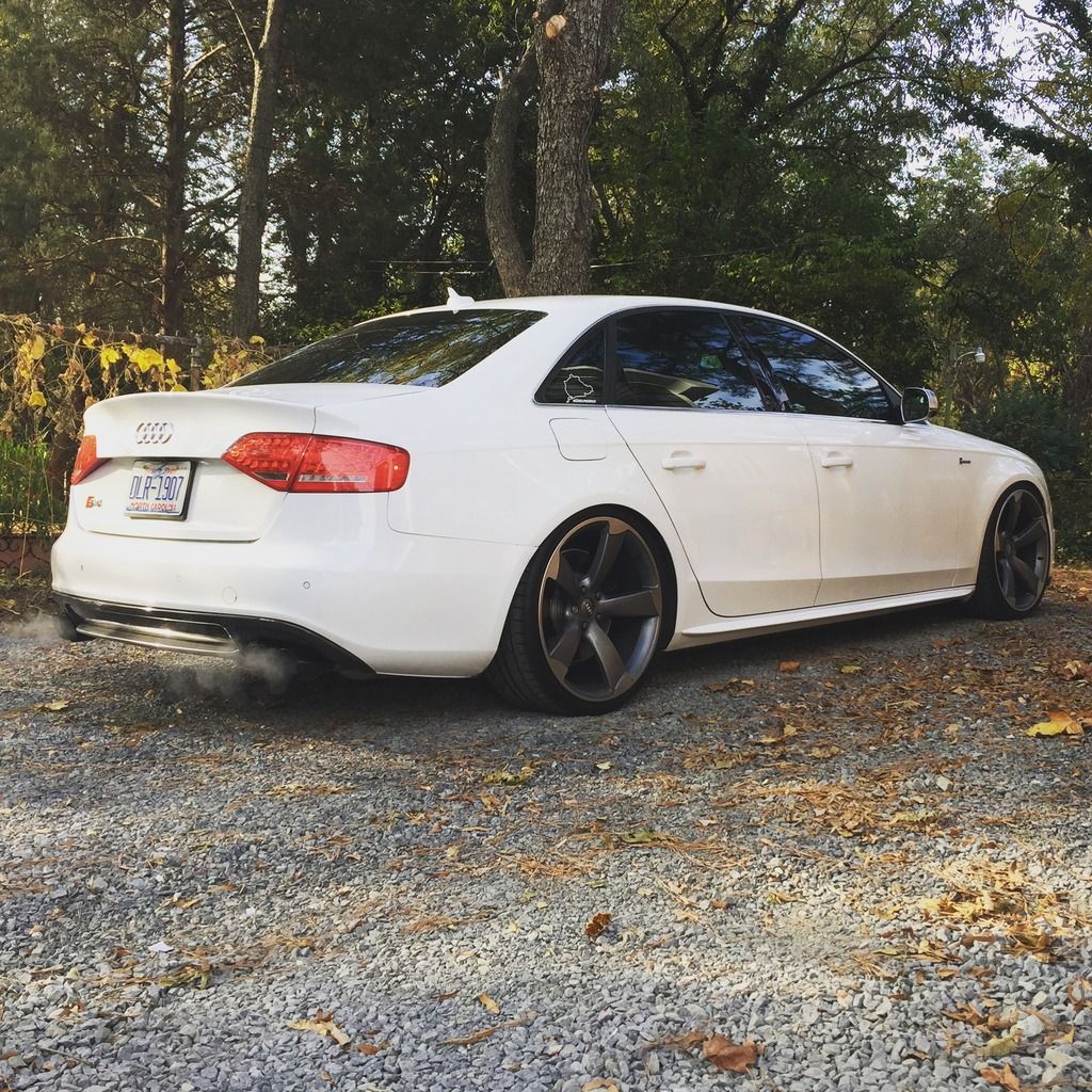

    My fenders are not rolled, and my rubbing is very minimal. Only on large dips on the highway, or if I carry passengers in the back on moderate to large dips.

    They are 20x10 with a +40 offset. My tires are Hankook V12's 255/30/20. Thanks for the props!

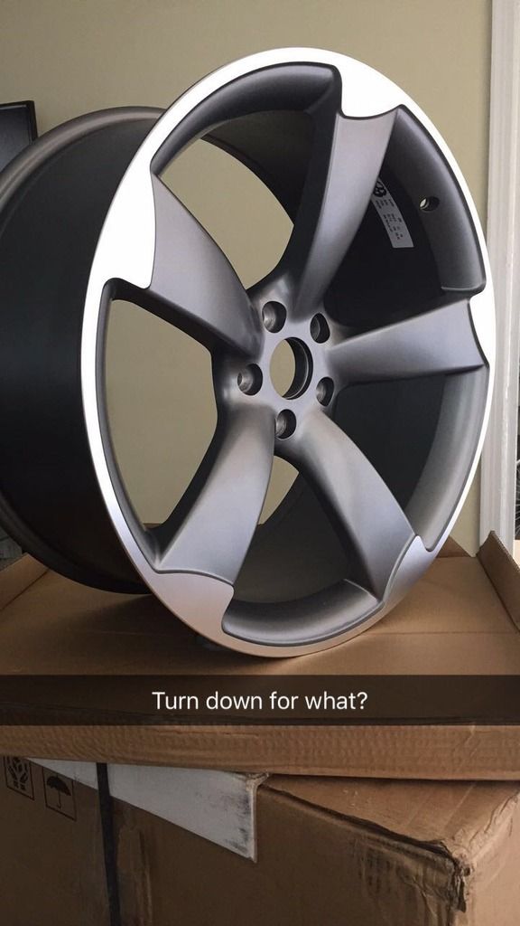

    That new new.........
    20x9 Rotor Reps +35, 255/30/20
    Relak v2.0 Updated Paddles

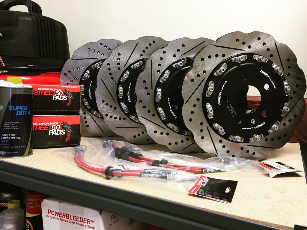

    Moar build thread porn......
    This gorgeous set just got dropped to me this afternoon. Like a kid in a candy store.....
    ECS Tuning Stage 1 B8S4 Brake Kit
    2 Piece Double Drilled & Slotted
    Wave Rotors
    ECS Stainless Steel Brake Lines
    Hawk HPS 5.0 Pads
    Super DOT 4 Fluid

    looks good man. i was gonna buy the same exact setup of wheels. keep the mods coming season right around the corner

    Are you still on the 20" Rotors? How are they holding up? Looking at getting the same set off of Ebay.. Thanks..

    I am. This is my 2nd set, they are great in terms of strength and durability. Reason for my second set is cause I curbed 3 of them. They're so cost effective that buying another set or 1 or 2 isn't going to break the bank. Highly recommended.

    Awesome. Thanks for reply back. Any rubbing with that offset? My car is roughly same ride height. Thanks

    There's a few factors that will depend on rub, and the margins are small. Do you have adjustable upper control arms up front? If you're as low as I am, you may want to introduce some negative camber to prevent any rubbing with sharp turns. Rear only rubs over large transitions on the highway, other than that no rubbing over bumps or city driving. If you're not quite as low then you shouldn't have any issues. I was on H&R Supersport springs and was lower than on these H&R Coils, and the rub was still minimal.

    Where did you get the rotors from? I have been looking but cant find the your +35 offset version. Only finding +25 versions. I know those will stick out to much.

    There is a seller on ebay that you can pick them up from in this offset. I had to be kind of specific in my search.
