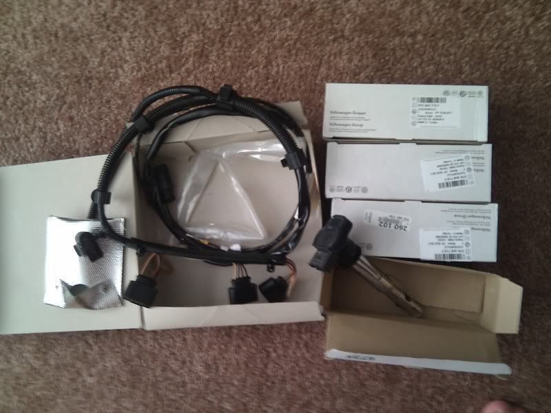

    Recieved my MKIV replacement harness and B8 A4 coils (07K 905 715 F)
    I have the INA coil pack spacers at work to get anodized. Bought them off a guy that ended up not using them. But they were rare aluminum, so I'll get them coated hard black before they will go on. Ordering EV16 injectors connectors, mil-spec wiring and mesh loom to redo the coil and injector harnesses. Will be pulling the entire engine harness to do this to eliminate all the unnecessary wires. Its only been in the car since the last rewire/retape for 9k miles.
