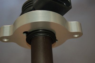

    Finally got my "new" valve cover installed...along with MKVI coil packs, BKR7E-11 plugs (gapped to 0.040) and INA spacers.
    Before:
    After (I really like the contrast of the silver spacers against the black valve cover):
    The coils don't sit quite flush with the adapters so hopefully everything stays put. I used a little dielectric grease on the seals and installed the coil packs into the spacers prior to installation.
    I haven't had a chance to do any spirited driving yet, but my overall sense is the car feels smoother overall (which is what everyone else has been saying...so yay!).

    I removed the gaskets completely. The coils packs sit flush and are very snug. You still have to pull hard to remove them. These pictures are after some spirited pulls on the freeway.

    Quote Originally Posted by boy412 View Post
    I would pull the one that sits a little higher and make sure the rubber seal hasn't bunched up causing it to sit higher. I know I had the same issue with one that I finally got to sit flush...

    @vhstejskl - I know what you're talking about...and I experienced that on one coil pack when I was threading it through the adapter. None of the gaskets/seals are bunched up. They were all flush when I set them on top of the plugs. When I pushed down on them they all popped up a little bit.

    The coils should all be sitting even right across the board.

    you must use silicon to get the cp to sit flush.

    Quote Originally Posted by Issam@INA View Post
    Clearly they do not in my case.
    Quote Originally Posted by heywier427 View Post
    I used dielectric grease on the gaskets and pre-installed the spacers onto the coil packs. Unlike John's experience (see below) I did have to apply a little force since the adapters were still hovering over the valve cover. Not sure why my experience was different...but here we are.
    Quote Originally Posted by diagnosticator View Post
    Yeah, I lubed the coilpack seals with silicone spray, then installed the adapters on the coil packs, then inserted the coils with the adapters already located on the coilpack seals, into the plug wells until I felt the coil click onto the spark plug, then installed the screws, there is no down force on the coilpacks from the adapters, and the silicone spray lube helps the coilpack settle with the adapter without any downforce against the plug after installation. The coil pack must be able to float vertically as the coilpack heats up and expands length wise, and contract again as it cools down with the engine shut off after running. If the rubber seals are to dry in the adapters, then the heat up expansion will stress the coil pack in compression when hot, and as it cools, the stress from expansion lengthwise, decreases to nominal zero when cooled off. The thermal cycling if bound up in the seal will eventually crack the coilpack body. The same type of failure also seems evident from an unsupported coilpack as it vibrates sideways in the plug well, bending the coilpack body and causing the stress crack failures from that different failure mode.
    ~Eric
    As in dielectric grease? install the CP's into the adapters first and then put them in the spark plug cavity.
