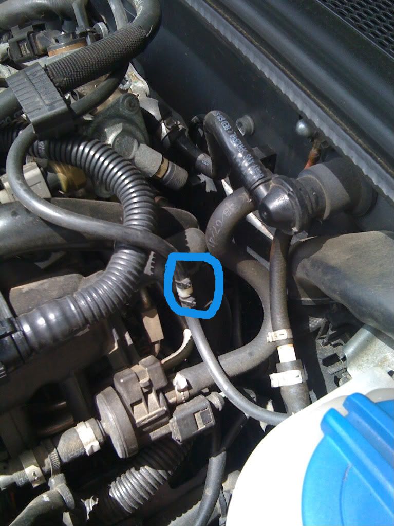

    the vacuum hose method

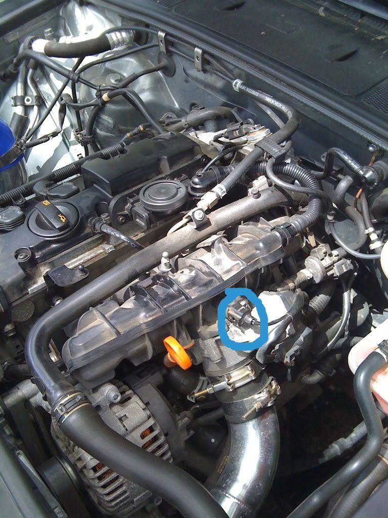

    if you go the vacuum hose route (if you have a boost gauge and have tapped the vacumn part), pull off the boost tap, and attach the vacuum hose
    start the car, the idle will be rough bc of the vacuum you have created, pour the rest of the seafoam into a coffee mug or a something where you can see the liquid. use the car's vacuum pressure to slurp the seafoam into the intake manifold. DO NOT dunk the hose into the seafoam, you will stall your car out, instead try to get a nice slurping noise much like taking the last sips out of a big gulp from 7-11.
    it will suck up the seafoam very fast, this shouldn;t take longer then like 2 minutes at best
    B)
    the 1/2inch to 1/4 method
    attach a basketball needle to the hose
    unscrew the one t-25 torx screw holding on the IAT temp sensor which is located on the top of the intake manifold (pretty easy to find but i will be posting a picture later)
    stick the hose into that hole (should be about the size of a 1/2 inch diameter
    hold onto that hose as a friend starts the car, the idle should be a slightly rough but the opening of the basketball needle is so small that the loss of pressure should not be that great

    i performed my seafoam hand in hand with my oil change, so i had the car warmed up for the oil change, did the seafoam, ran the car to rid the seafoam, and then changed the oil + plugs

    I am so grateful for this thread!!! Been dealing with consistent misfires in cylinder #3 for weeks (96k miles). Was experiencing rough idle and P0303 constantly when engine was cool each day before coming up to running temperature.
    Tried the seafoam/IAT/hose/basketball needle process and it worked like a charm! I have now been misfire code free for a week.
    Thank you OP!
    Note: I had a ridiculous amount of smoke during the process with the neighborhood on alert asking if my car was on fire ;)
