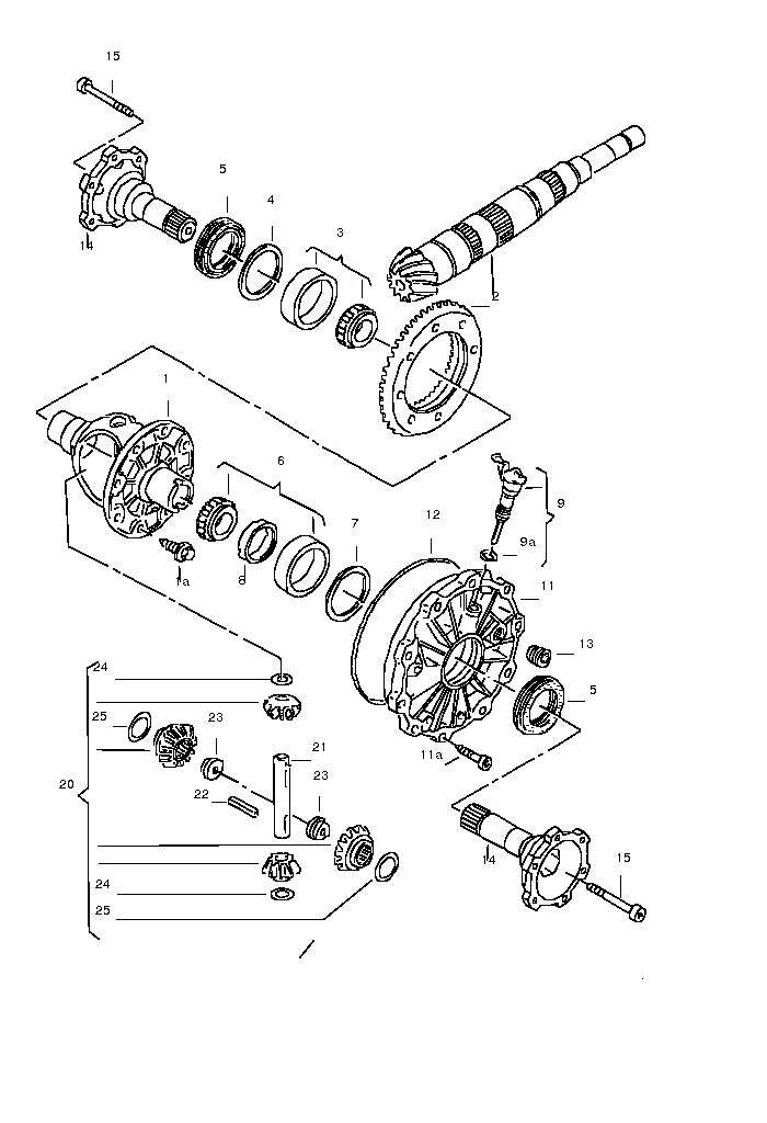

    If there is play in the CV flanges only then the CV flanges can be out of round (it happens) or the differential carrier can be worn allowing the CV flanges to wobble.
    This is whats happening but its the whold shaft moving. from this diagram (I dont believe its the exact one and its of an auto) I see it needs the bearing at the flange.
    The item 35.220/130 is apparently a bearing that is on that diagram That is where the wobble i believe is from. not the actual Differential. God I hate transmissions work.

    That image above is from a 5 speed automatic not a 6 speed manual. (B5 S5 6 speed is manual.. entirely different gearbox.).

    Here's an explosion of the front diff. Diff bearings are #6 and #3. If there is play in them the entire carrier is wobbling, and the ring and pinion have tight tolerances meaning the pinion teeth will grind away at the ring gear. It's possible the flange is wobbling inside the diff carrier but this is unlikely.
