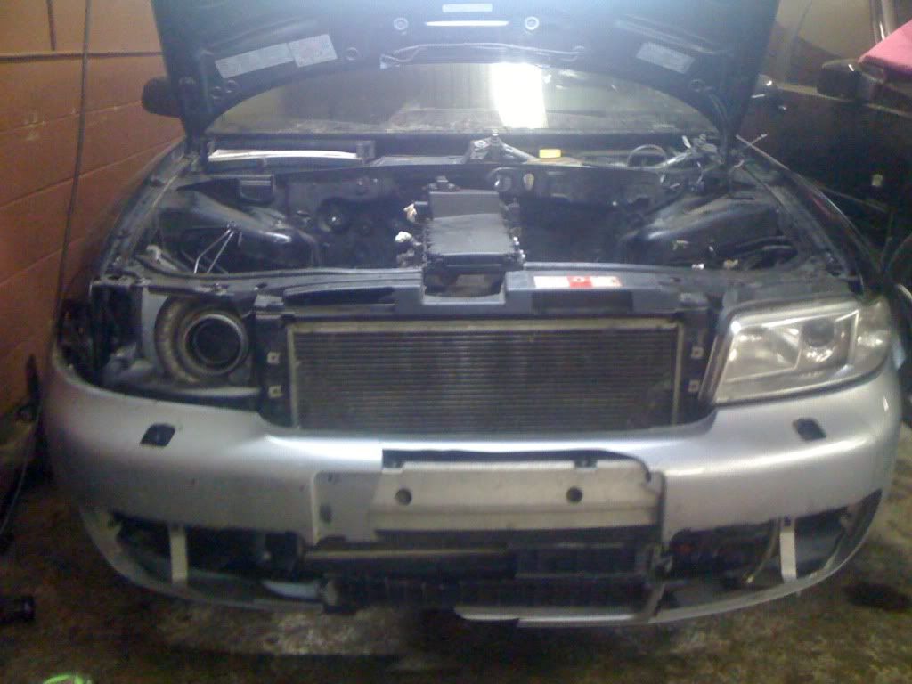

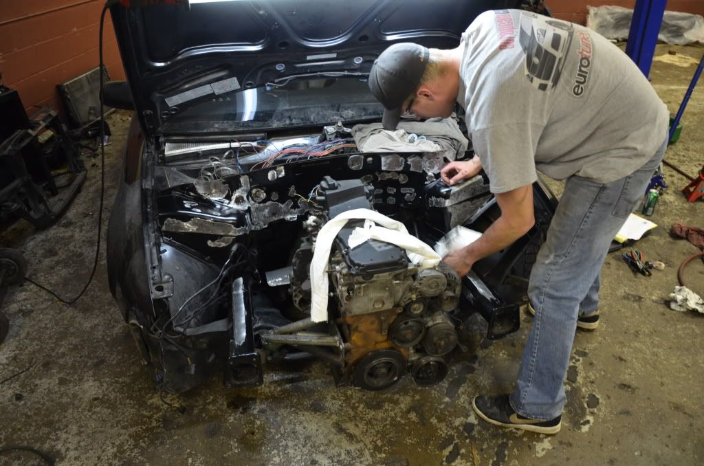

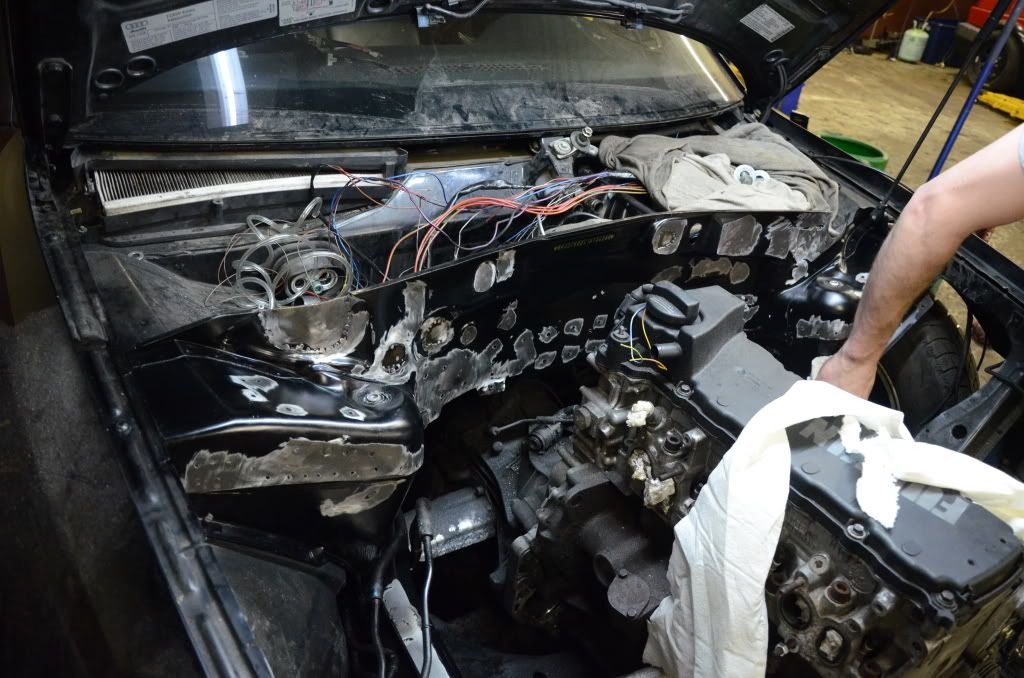

    Last night Rob came over and worked some body work magic in the engine bay
    Tonight we sprayed the first coat of high build primer. Still lots to go!

    Quote Originally Posted by Spanky387 View Post
    Thanks for the candid shot

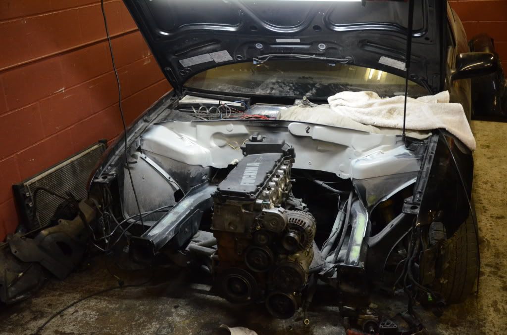

    The weekend was a complete failure for getting shit done on my car, a toyota rav4 and a turbo M3 consumed my weekend as well as this:
    haha
    But I did finish painting the motor mounts. Unfortunately I need to sand the paint off the passenger side motor mount and weld a bracket onto it for this:
    That is a minor detail.

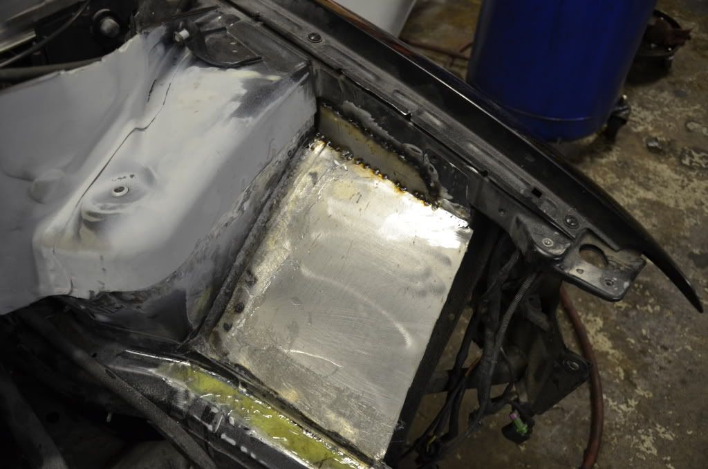

    Last night i started welding the plates in for the wheel wells and Rob laid down the first layer of glass.

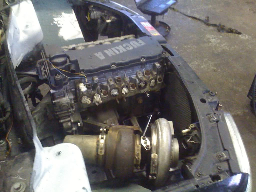

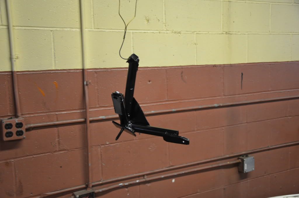

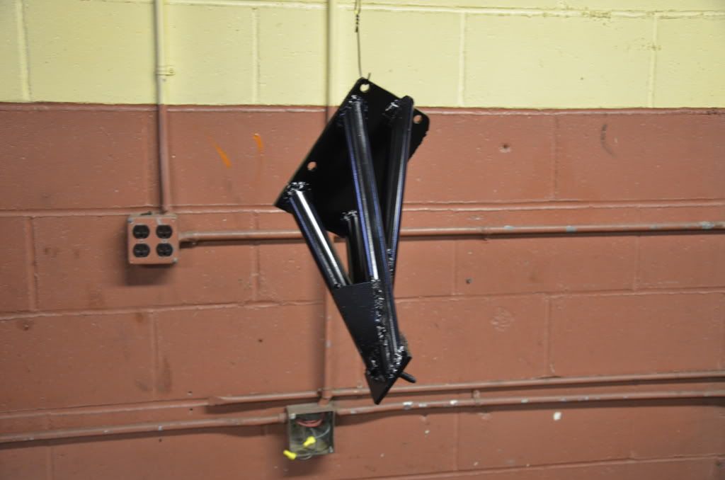

    Made some temp brackets for the turbo mock up of the manifold. also got another coat of mud on the engine bay, Ill take pics when I get to the shop later tonight

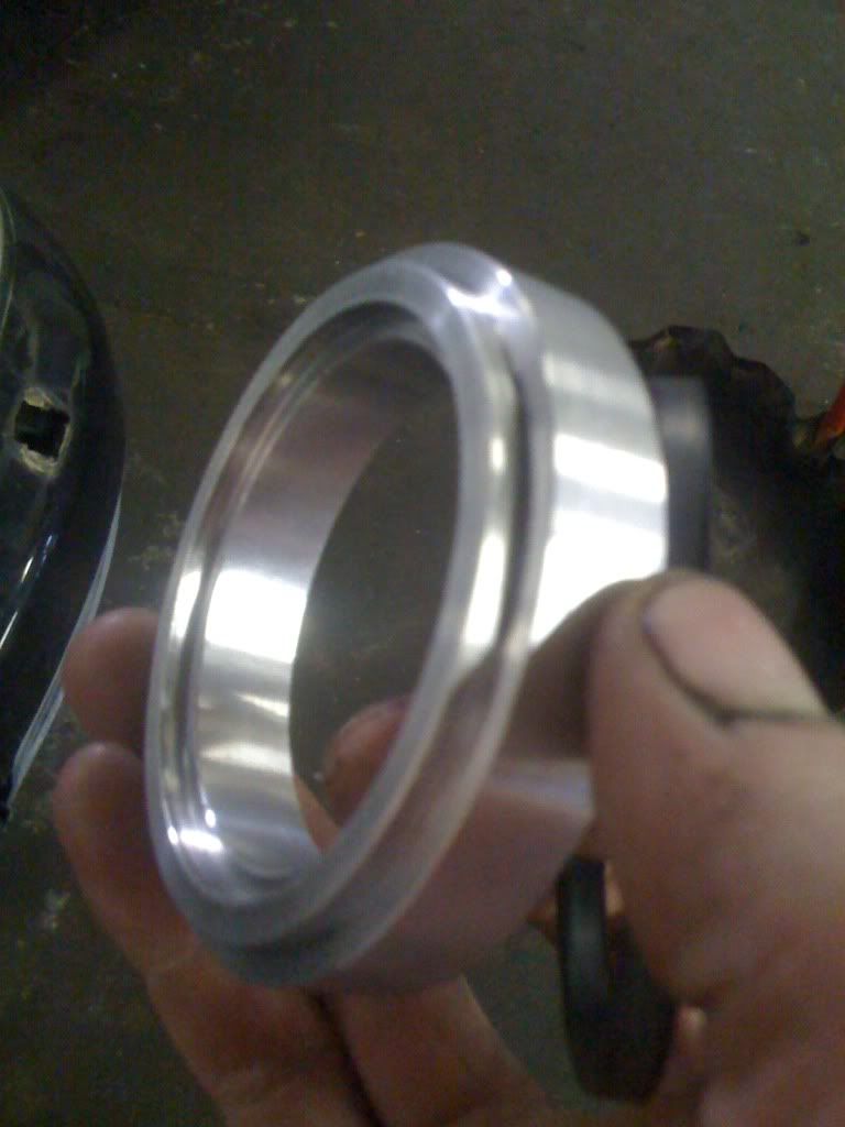

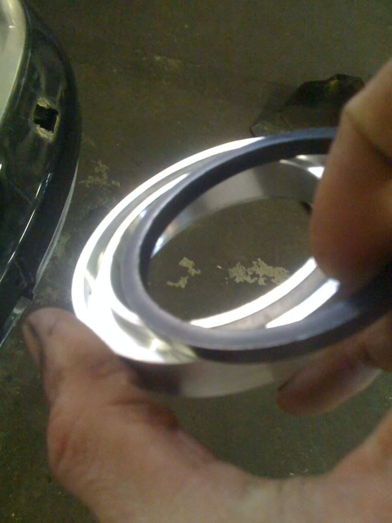

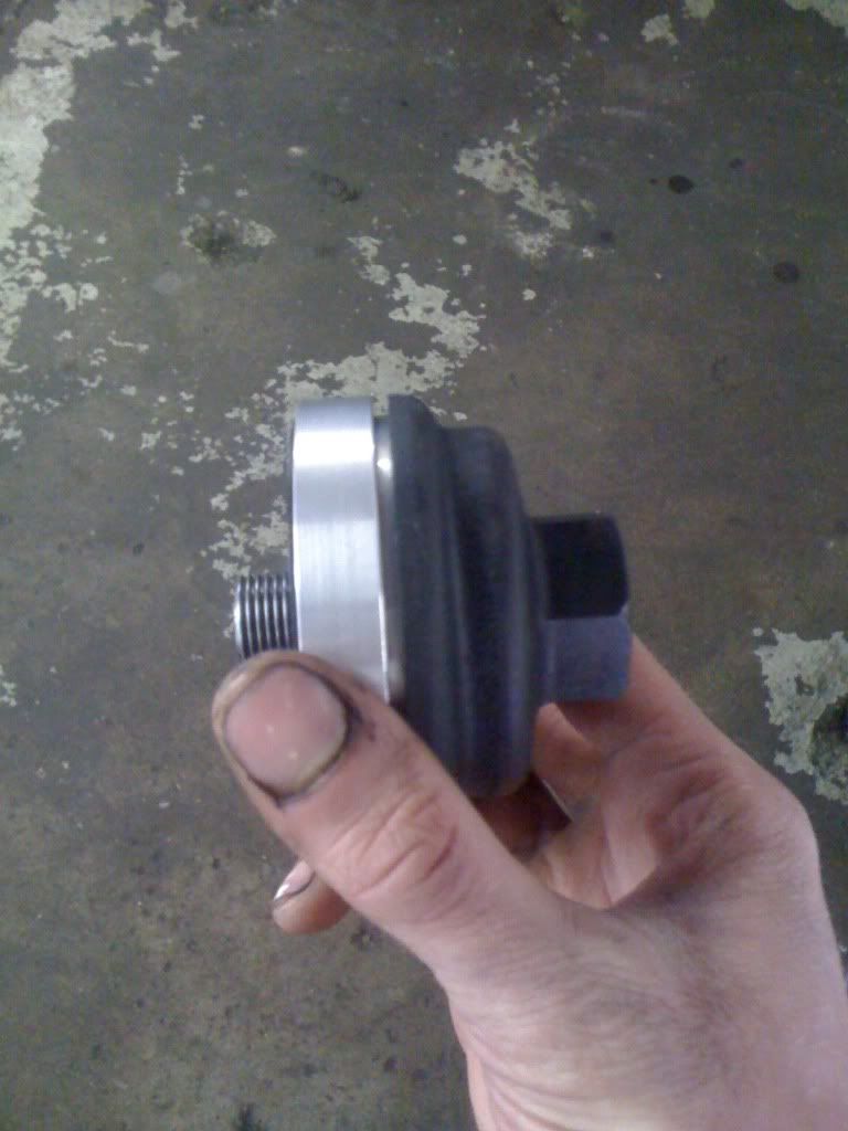

    I had my oil filter housing machined today. I had the pipe cut and re threaded. I also had him machine me a custom plate so I could eliminate coolant running through it. The reason I had to get it shortened was so it could clear my motor mount. It was machined to use the factory gaskets :D 30 bucks well spent!!
    He is also cutting me all the flanges I need for my intake manifold.

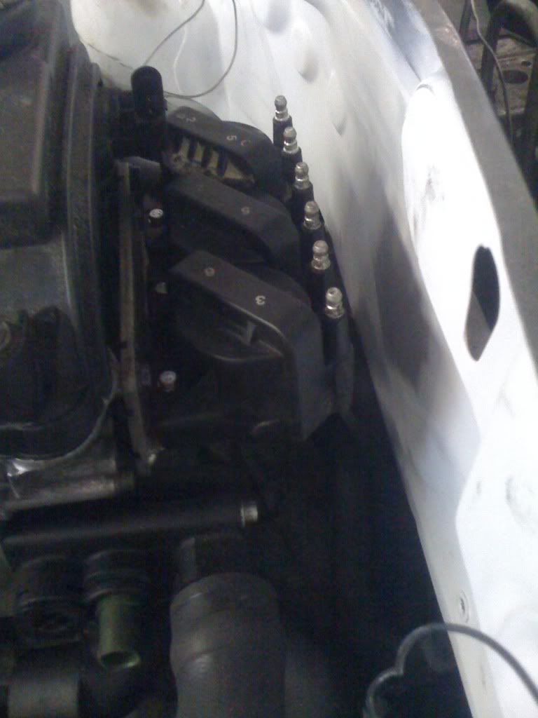

    Also made a coilpack bracket using both GM and VW brackets I had lying around!!
    Full Blown should be done with my twin scroll turbo collector next week.

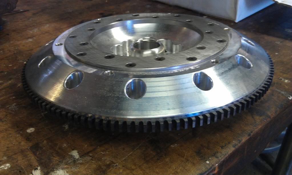

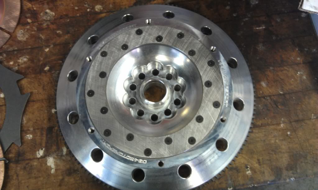

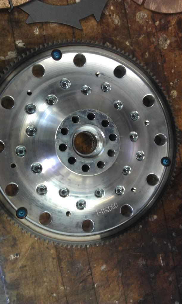

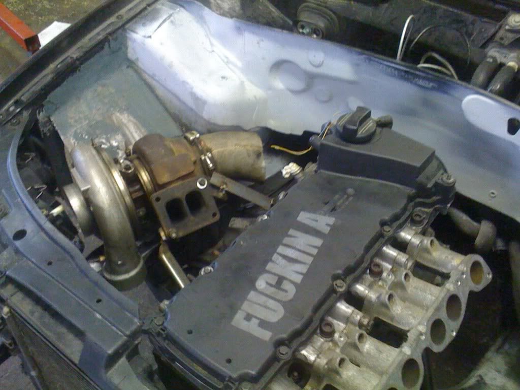

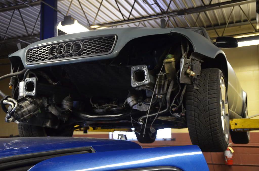

    well three months later my clutch and flywheel finally show up. But the bolt kit was missing...
    anyways, on with pics!

    Talking with Issam to get the missing hardware issue resolved. but here are some more pics of the clutch and flywheel

    Here is a pic of the font bumper... almost done
