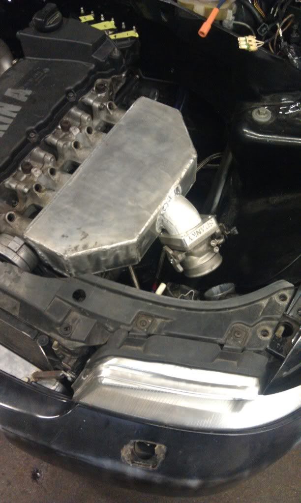

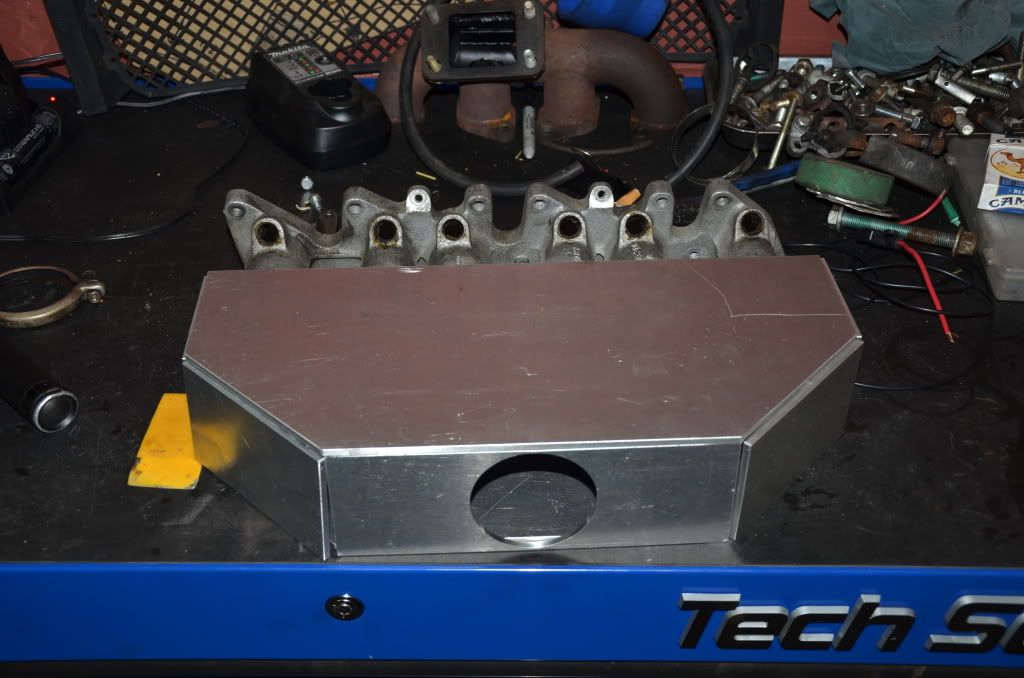

    yea so some updates, I got the plates cut for the intake manifold and welded up the collector for the exhaust manifold.

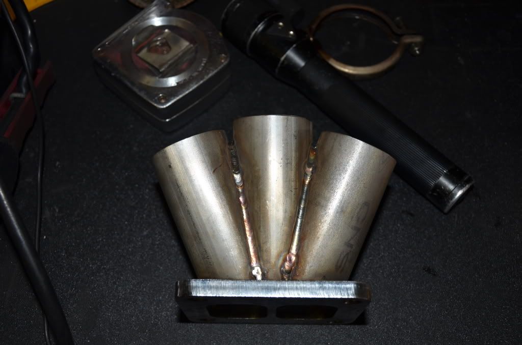

    The intake is all welded up now minus the TB flange is getting re cut due to the first one warping. started working on the new exhaust manifold. I was going to use my stock ATP one, but it made the turbo sit too high and I wouldnt be able to shut my hood.

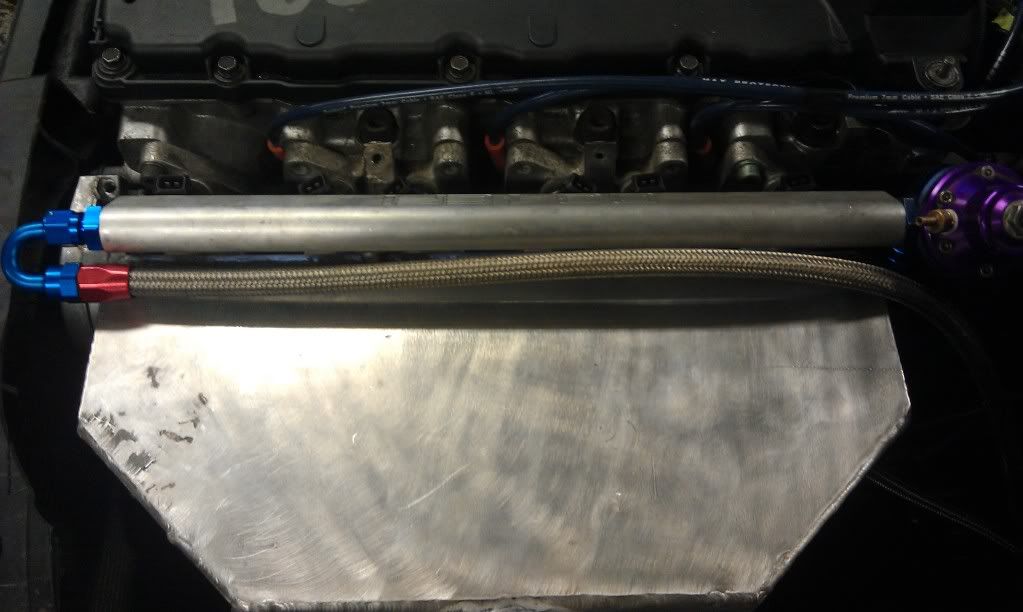

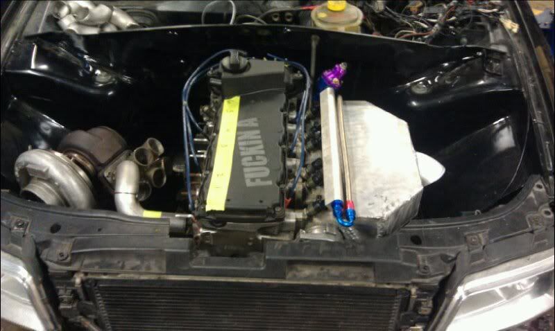

    I also finished running all my fuel lines, mounted my second fuel pump and ran all the wiring for it as well. I tied up all the loose ends for the stock ecu and my standalone. Now that the clutch issue is all sorted out with clearing the bell housing, Tiltons pressure plate bolts were getting caught on the back of the bell housing.... the starter is in and adjusted accordingly.
    another pic of the manifold.

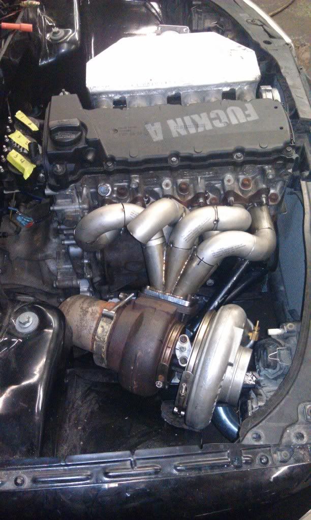

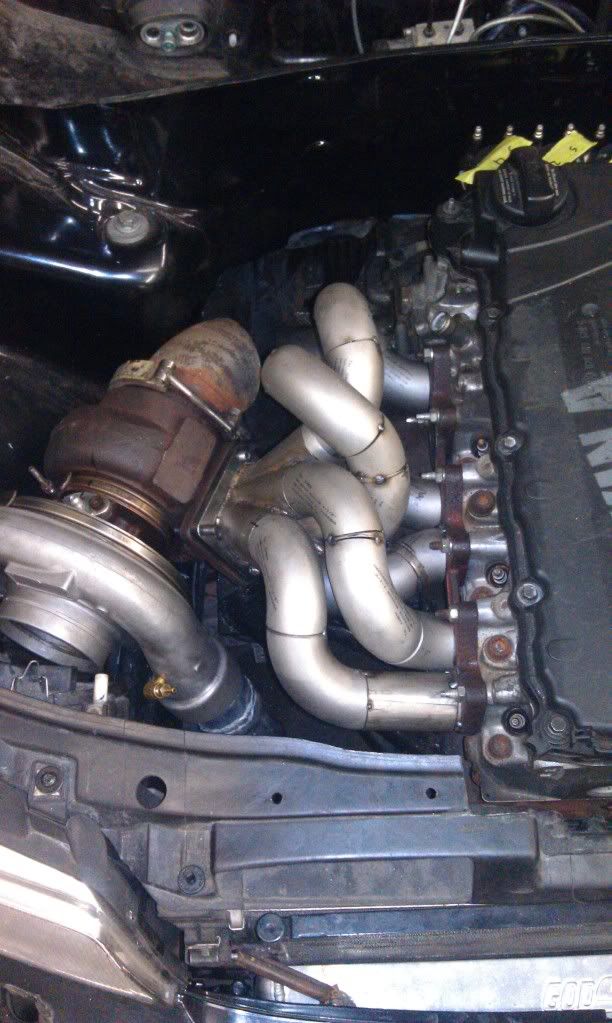

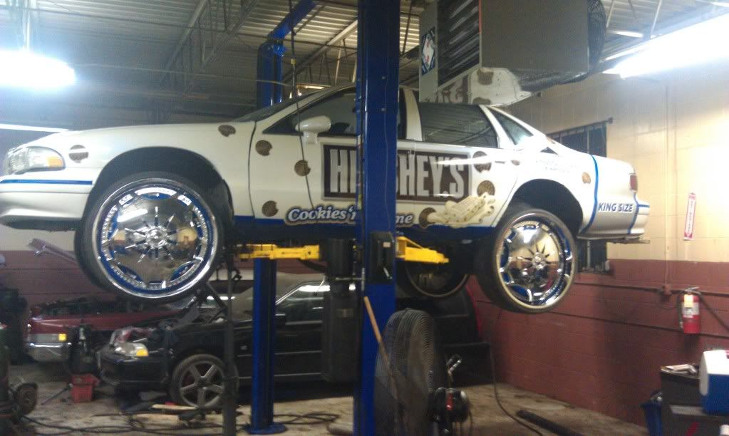

    got the exhaust manifold all tacked up minus one runner. I ran out of bends. I also got the TB flange welded on.
    Also worked on this Donk

    fuck yea. Love the Cookies n Creme! Your car is alright too I guess

    Sick ass build! What's the deal with that Hershey's car? So far away from the OG plant. lol

    Hersheys car is ghetto. finished the exhaust manifold today as well as a rear main seal and oil pan gasket on a friends car. not much progress will be made today tho since It its September 25th, which is my birthday, which I turned 25. So I will be getting incredibly drunk :)
