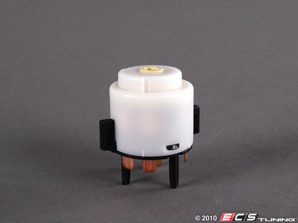

    Could also be the ignition switch went bad.
    We have them available below.
    Click HERE to order or for more information.

    It was the ignition switch fellas!
