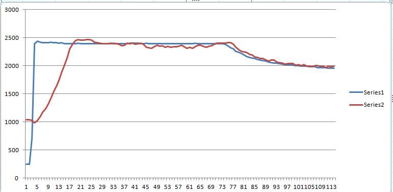

    I think i might try this after i check for leaks. When I was JHM stage 1 I was hitting 20-21psi now i can barely hit 16psi in 3rd gear. I don't have any codes and i'm running the GFB DV upgrade and i'm now JHM stage 2. I have a upgraded HPFP also that was required with the stage 2 program.
    I think you replaced your turbo since you wrote this but I’ll write this for other people to read in the future.
    Don’t just start adding springs. You have to check wastegate crack pressure by pressurizing the wastegate and seeing where it cracks. If you have a wastegate that rattles, if you can rebuild the turbo, that’s what you need to do. If you can’t replace the flap door mechanism by itself, you need a new turbocharger.
    Your logs will tell you if your wastegate needs adjusting or if your turbocharger needs replacing. Your boost logs will be off and your N75 duty cycle will be high.
    Also, there is no one set wastegate crack pressure. Especially when you add an aftermarket turbo. Your wastegate can be set to one specification by its manufacturer but if your tune is only dictating a certain amount of boost or writes their tune for a different crack pressure, you can run into some running issues.
    Here’s an example. JHM says their K04R is suppose to crack at 10 PSI. My GIAC tune writes their K04 tune to behave like a K04-064 which cracks at like 7-8 PSI. My K04R cracked at only 6 PSI. so I adjusted it to 8. The car boosts like its suppose to.
    This was adjusted to fix a mistake made during assembly, not because the turbo was faulty. Over adjusting a wastegate to over compensate for a faulty part isn’t a good solution.
    Do boost logs and graph actual VS specified. It should look like this.
    These little dips in the middle could just be the N75 adjusting or I might need to make crack pressure a little higher. My duty cycle is 60% at redline so the wastegate is probably adjusted to the correct range within reason or might need another half psi- 1 psi adjustment.
    Don’t just adjust your wastegate without having the right data. Your wastegate could be set right already and your tune could just be weak.
    This thread really only applies to OEM K03’s that have faulty wastegates. This thread is a band aid fix for people who don’t want to replace or rebuild their turbochargers and shouldn’t be needed on a perfectly good working turbocharger. I don’t mean that in a mean way. People gotta do what they gotta do sometimes. 😀
    By adjusting your wastegate outside of its spec or adding helper springs, you’re basically just trying to mask a faulty part. If anyone follows the advice here, it shouldn’t be used as a permanent solution. Only a way to get by until you can repair or replace your turbocharger. If your turbo made the right amount of boost before and doesn’t now, the wastegate didn’t cause this because it became misadjusted. It’s doing it because its faulty.
