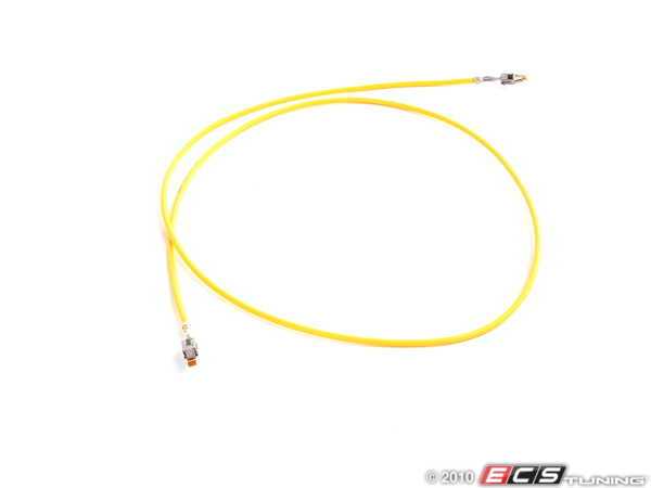

    73592
    Yes, you can. ECS sells the replacement connectors. Click
    thanks customa4!
    checked on europaparts and it's $19
    http://www.europaparts.com/electrica...4b0973724.html
