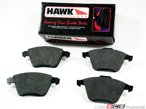

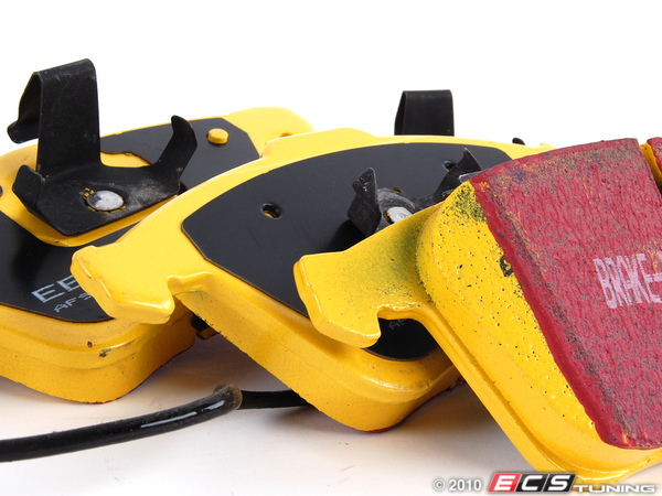

    EBC yellow stuff and Hawk HP plus pads are a great pad that can be used on the street and take the heat at the track.
    Check them out in the links below!

    Quote Originally Posted by Jason@ECSTuning View Post
    Jason
    HP Plus will be too loud for the street & requires some heat before they brake effectivly. EBC Yellows are loud as shit, require more heat than the Ferodo DS2500, and are ultra dusty. These will also trash rotors until up to proper temperature.
    Jason - Have you driven NHMS? I am assuming you realize the brake needs at NHMS versus other tracks? I ask since he won't be able to keep the EBC yellows at temp to be safe at the end of the front straight based on the power he is putting down. He just won't have enough braking cycles before the hard late braking before the left 90 deg turn into the high speed chicane which exits straight into a wall that requires a tight, but wide left turn, Again this is another location where the yellow's won't be at temp; if he overshoots it he wont have enough brake friction before the concrete wall. But again your the pro slinging pads to amateur, so i guess you know something i don't about this roadcourse.

    Not sure if you are aware but EBC Yellow Stuff pads do not require a warm up to perform at its best like most other race pads. They still have good bite when they are cold and are fade resistance up to 800 degrees F.
    Jason
    Jason
    Jason - Actually i am aware of the advertising, that is why i made the mistake of buying a set, not to mention the attractive price. I did run then at the track with mixed results. I really liked them at 2nd Creek, but when i ran them at NHMS they lacked the bite and the friction took several heat cycles to get to optimal braking at this track. They had much less cold bite than many others and a smaller working temperature range then other pads. It seems like these pads might better suited for other cars then the B6 A4. The DS2500 has better cold bite a MOT of 1000 deg F.
    Do you care to post your pad preference at the different tracks? Which pad do you prefer on street compound? Which pad on r-compound? Are you recommending pads from personal expereince at these roadcourses? Or are you recommending pads based on advertising material? I sure hope it is not the latter..

    Quote Originally Posted by EBG 18T View Post
    I see, I've personally used EBC yellow stuff pads and thought they held up great for the tracks that I have driven and the duties of daily driving. I'm not too familiar with the NHMS track but from what you are saying it would involve a very unique pad due to its characteristics. I've never driven a track on r- compounds so I cannot comment on my preference due to lack of experience. If I were to use r-compounds I would have to do some researching oh what kind of pad would best fit my needs. Obviously if I'm running on r- compounds I'll be looking at a full race pad and to begin with. I might consider the Hawk Blues that we carry simply because they are easily available to me through ECS.
    Jason

    EBC Yellow stuff are really just not a good pad. Lower bite than the HP Plus. Dust more than the HP Plus. And they sound like a cat being electrocuted.
