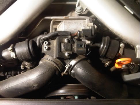

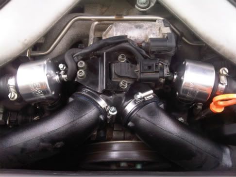

First thing were to replace the stock DVs with Bailey DV30's and upgrade to a Samco TBB.
Before
After

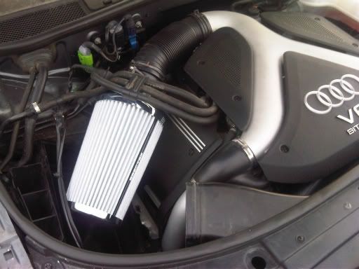

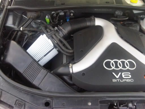

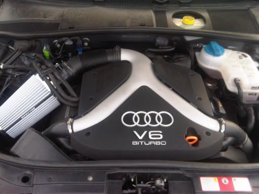

Next was to upgrade the intake. Removed the top of the stock airbox and attached a Spectre cone filter. Filter dimensions are 10" long by 43/4" to 6" diameter.
Cone Filter
With stock Ram Air in place
