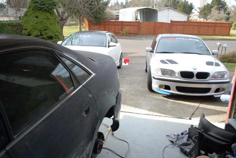

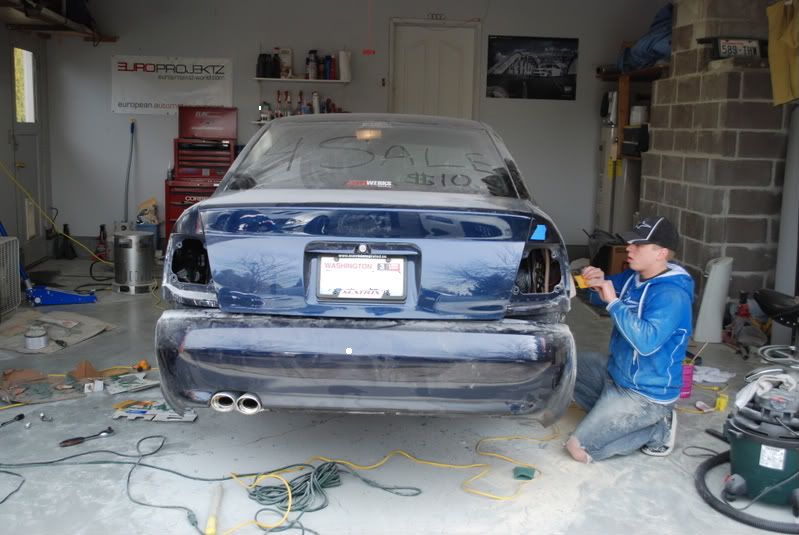

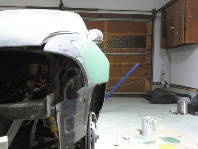

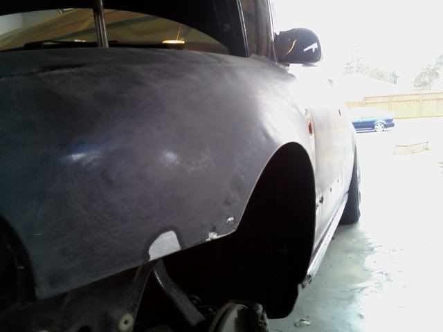

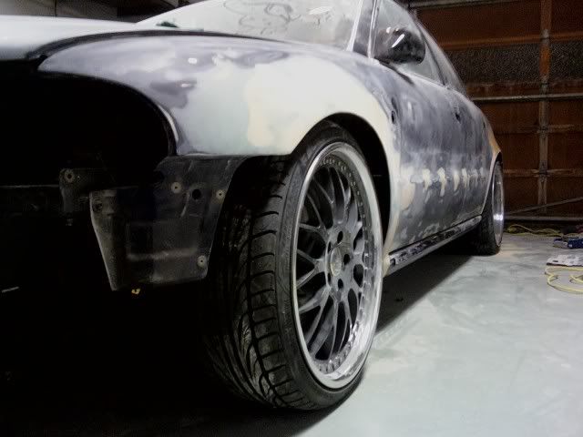

    got the rear fenders pulled and pulled out the rear bumper to match
    I think i might need some spacers haha. gonna be ordering 25mm spacers front and rear
    and the view from both sides. definitely wider than before

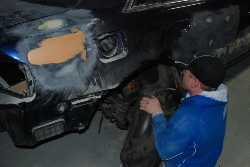

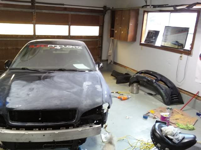

    removed front bumper and sideskirts
    pulled door trim off this morning
    and here is an idea of how the color will look
    and in direct sunlight

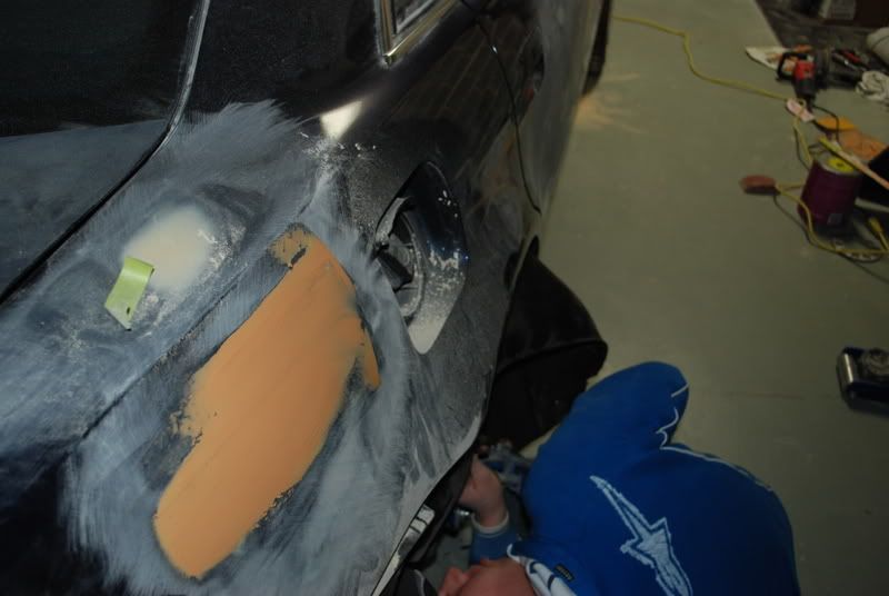

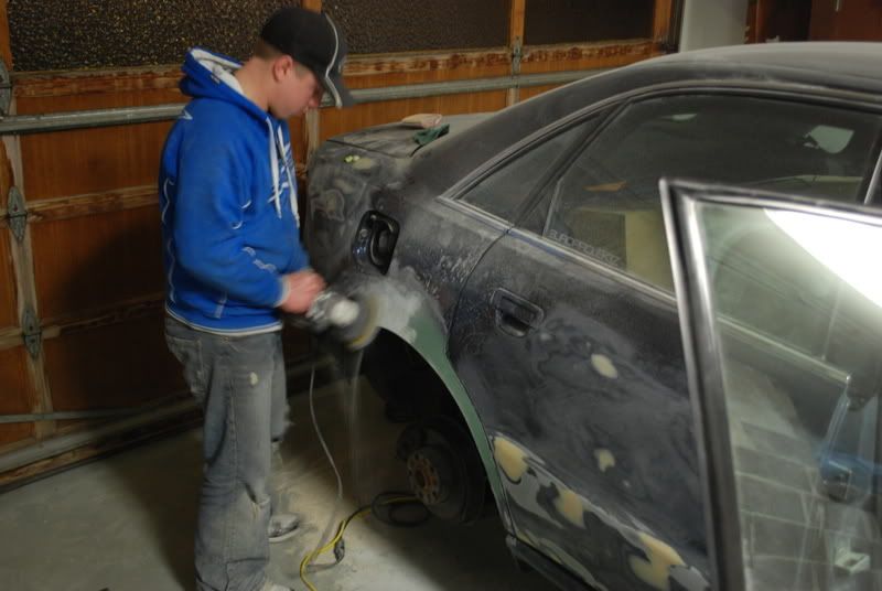

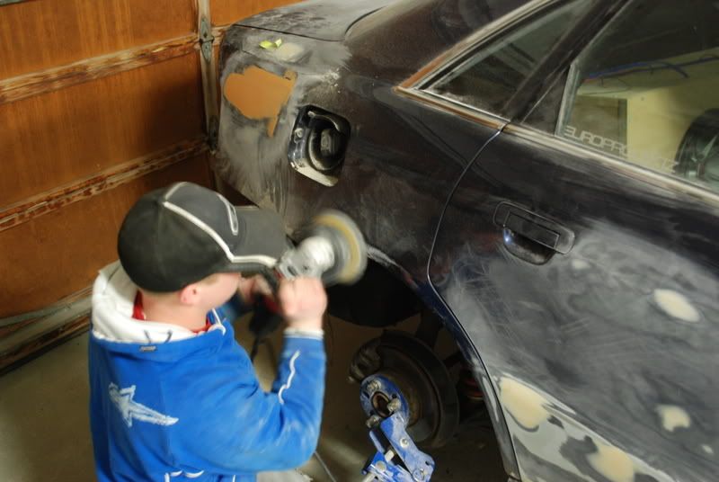

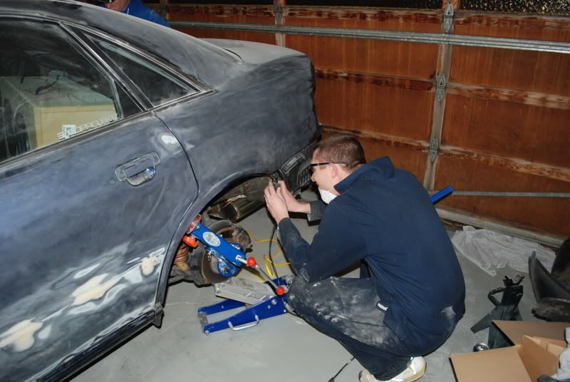

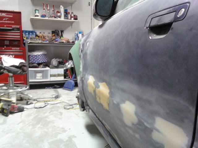

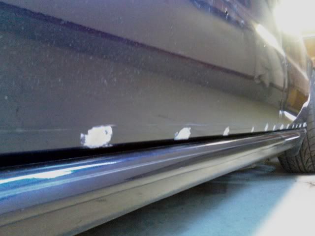

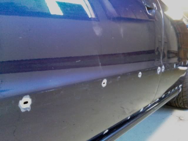

    removed the lower trim and grinded down the pegs
    then sanded around the trim holes to get ready for welding on saturday

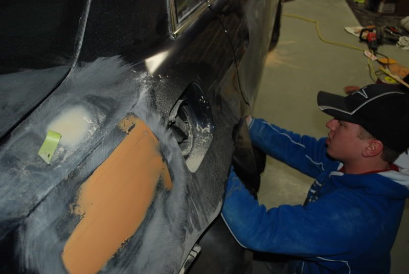

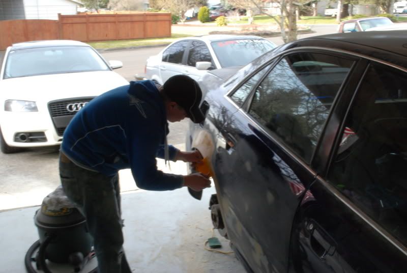

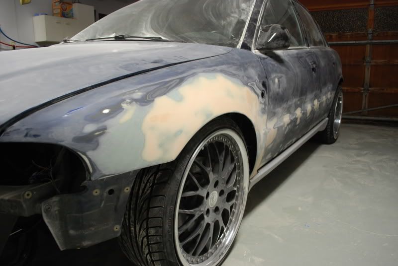

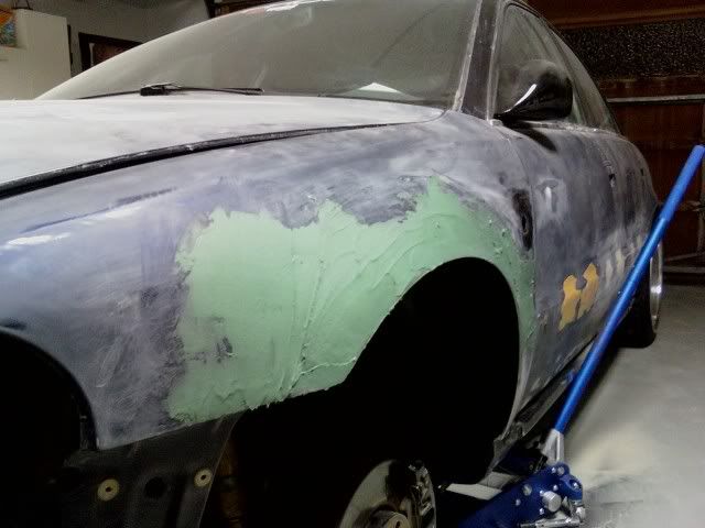

    began sanding the doors
    a quick pic of the garage. its trashed.

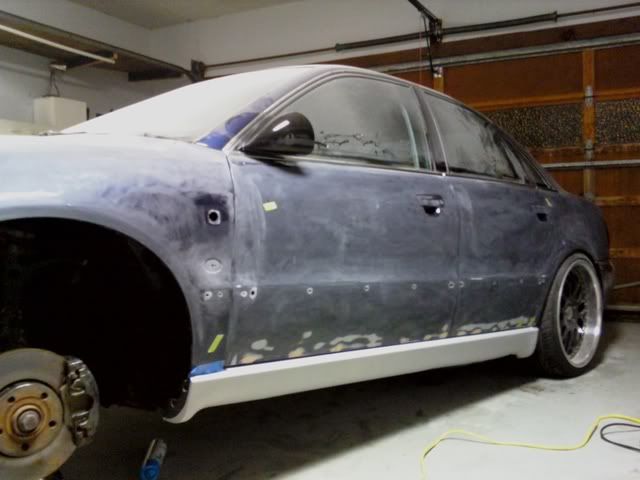

    got the s4 skirts on friday and fitted/trimmed them up.

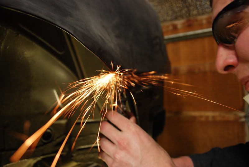

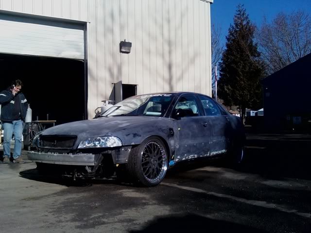

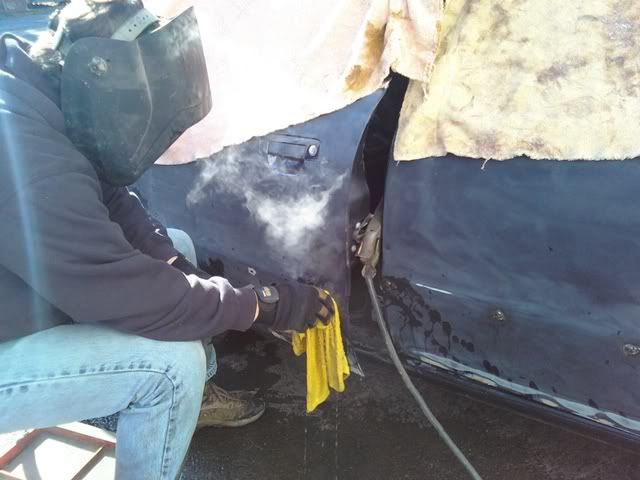

    Got the car down to my roomates Dad's shop so that he could weld up the trim holes for me
    doin some weldin

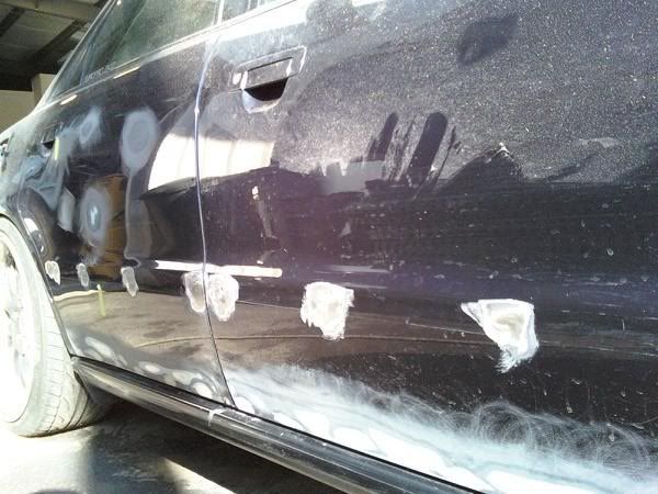

    all welded up and began grinding. the grinder flattened out some spots a little, so i will have to use filler to build up the areas where grinding was done.

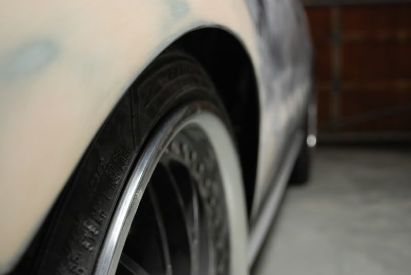

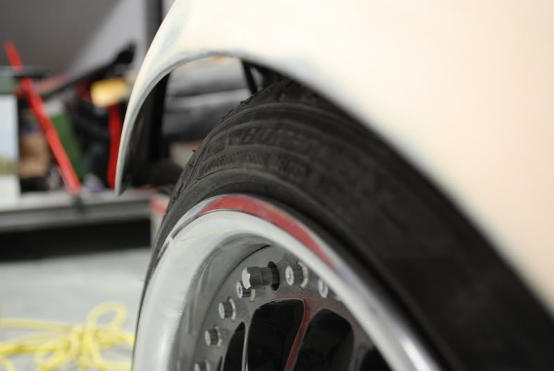

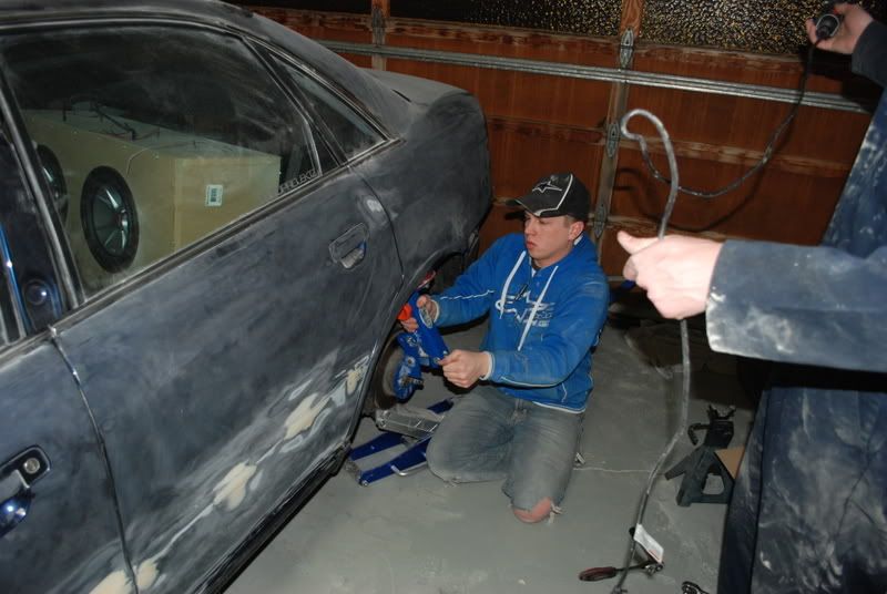

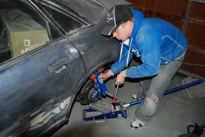

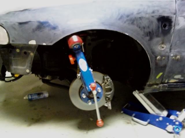

    My buddy Daniel came to town for this weekend to help out a bit. We made a bit of progress, but I think more progress was made at VooDoo Donuts :P
    Pic explains it all:
    Getting there:
    Some after lowered and wheels back on:

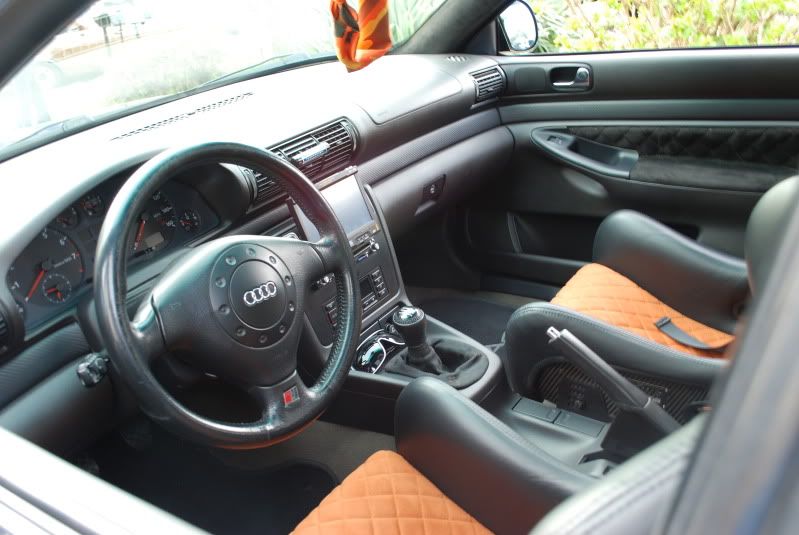

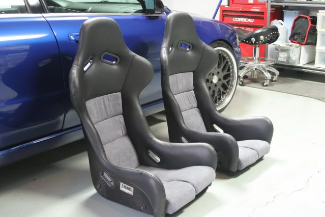

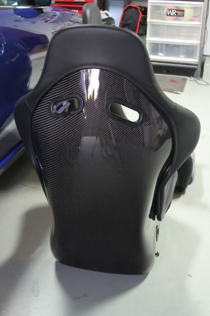

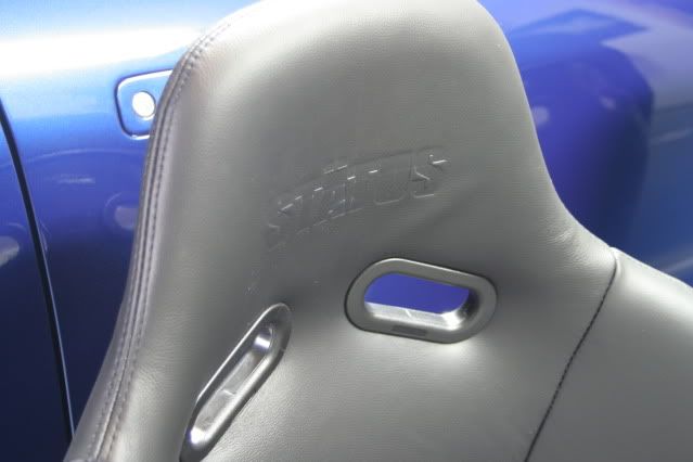

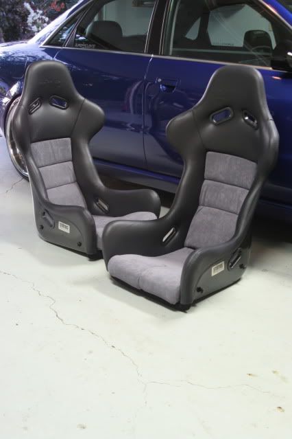

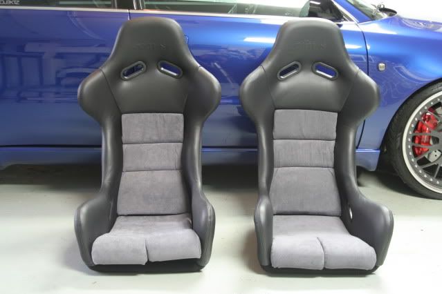

    There were some interior mods already on the car, including a set of Corbeau Racing Seats, however I decided it was time to step up my game so I ordered a set of Status Ring seats with Carbon Fiber backs and Alcantara centers
    big thanks to Sean @ Status for hookin it up!
    I got tired of the same ol' same ol' black/grey interior theme...So i decided to change it up and give it more of an exotic feel, all the while installing an Autopower roll bar.
    i went with Orange Alcantara diamond stitch on the seat centers, along with black alcantara headliner, and black alcantara armrests and rear window tray with orange diamond stitch as well.

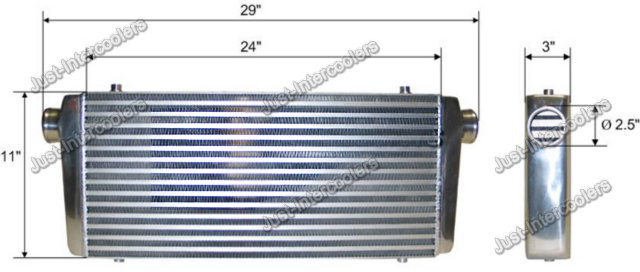

    and i also just picked up a 29"x11"x3" Bar/Plate FMIC (yes, huge I know), which should arrive in the next week or so. The intercooler will be receiving a black anodized treatment once everything is good to go and it'd been fitted.
    I received a few cool pieces over the past week.
    My fairly large intercooler...31x12x3 My goofy ass holding it. Yes, I know i'm sexy, but this is to show the size of the intercooler, and not my incredibly dashing good looks, so please try to focus :P
    This is a picture of the intercooler set behind the bumper, fits nicely IMO. Not only does it need to perform well, but it has to visually be appealing too, and theres nothing more I hate than seeing a small intercooler behind a large opening...needs to be aesthetically pleasing. The intercooler will be anodized black, as I do not want it to stand out heavily, and with the car and most of the parts on it being a darker color, I think it will look better this way.

    Currently I feel it is very much in need of some interior love.
    Nice facelift center console conversion along with a facelift cluster with some gauge cluster rings would really set off the interior.
    Hell, go ahead and get your self some homelink sunvisors to get in that garage of yours with style.
    Those status seats are a piece of beauty.
    By all means though, the exterior is pristine; thats the front end I'd wish i'd gone with.

    Meh, center console will not be changed...for me that is not something I want to put my money into right now, plus, I gotta keep it at its roots...it's an old bitch! :P
    Gauge cluster will stay the same for now, but I have also found write ups where I could change some of the lighting to white LED's...again, just not something I've done yet, but may. I've been thinking about that for a while!
    a HUGE reason i will NOT change the gauge cluster is because with the difficulty of this swap, this gauge cluster is actually the best one to have, as most of the electronics run independent of the ECU. so if anything, i'll do like i said above, and make some of the bulbs white.
    I appreciate the feedback though, however It will be left the way it is (for now)...my money has to go elsewhere though (getting this pig to run before i die, and whoop the crap outta some p-cars, ferraris, and lambos :) )
