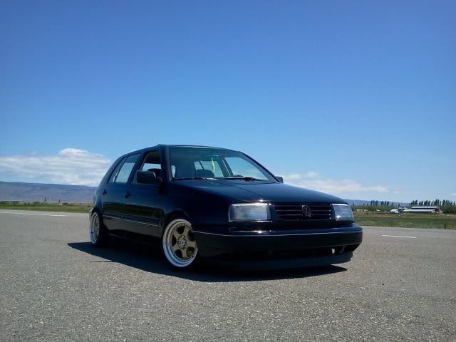

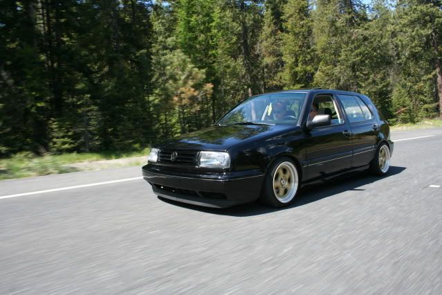

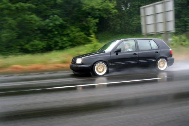

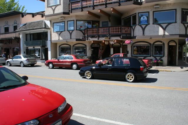

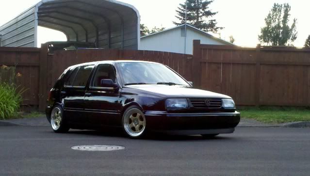

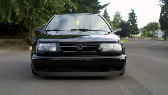

    Here is a picture of the mk3 i just built for those who are interested in. isn't perfect by ANY means, but it was a budget built daily. it will get beat on haha
    The day I picked her up
    The steering wheel was shot, so I decided to pick up a Driver's Edition wheel on the cheap, and finish it off with a "genuine italian leather" shift boot and ebrake boot with red stitch
    Then came the bodywork...I decided to get a respray. I was unhappy with the paintjob and god-awful amount of dings the car had, so I felt it was necessary. While I was at it I figured I might as well shave the rear hatch as well as the windshield washer nozzles and the antenna that was on the fender...I mean, who needs the radio anyways? I also did a Jetta front end conversion and added some new e-codes.
    Oh yeah, also decided to shave the bumper while I was at it too.
    some crappy cell pics
    and my favorite...
    List of stuff done:
    *Respray of black w/copper flake
    *15x7.5" Konig Candy Wheels w/Federal Formoza tires
    *Tuningart Coilovers (cheappppppp)
    *New front windshield (other was cracked to hell)
    *New Clear/Red/Red tails
    *Jetta Ecode Headlights
    *Jetta front end conversion
    *Shaved Bumper, Washer Nozzles, Hatch and Antenna
    *Driver's Edition Steering Wheel + Shift Boot and E-Brake Boot
    *Euro Duckbill Lip Spoiler
