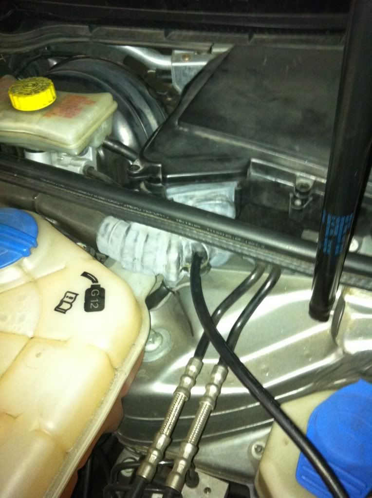

    thanks a ton guys. I just got through the ecu and my next step is either to drill a hole in the ecu box and find out where to get through into the engine compartment or just go through with the other wires. if I do that, I'll have to cut a hole it that rubber tubing to get the hose out, i would also not know where to put the airfilter if I did it that way
    Veteran Member Four Rings ryanworth's Avatar
    Nov 16 2009
    50798
    Los Angeles, CA
    Just cut a small slice into that rubber tubing feeding directly into the ECU. Remove the ECU cover, feed your Gauge hose through the rubber tubing, and drop directly into cabin behind the kick panel.

    sounds easy enough guys thanks. I'm going to cut a hole now. where did you all put your airfilters on the hosing?
    Senior Member Three Rings theklug's Avatar
    Jul 01 2009
    44461
    '08 B7/'89 e30 5speed/'81 380sl
    Philadelphia
    After I drilled a hole in the ECU cover, I used one of the rubber grommets that they gave you to seal the line/hole.
    I put my air filter and the rest of the junk all zip tied under the kick panel along the firewall. I had a lot of excess, which I should have shortened.

    that's what I was going to do but I would still have the problem of getting the hose into the engine compartment once it was outside of the ecu box. right now I have the hose in the engine compartment from the ecu rubber outlet. but still have the problem of where to put the filter. maybe on the inside of the car by the pedals?
