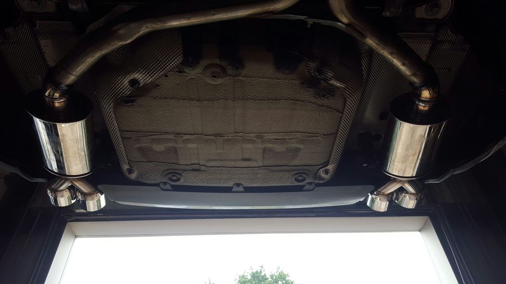

    Scott at EuroWise hooked this up - custom center stainless steel non-resonated Xpipe - Stainless Steel Resonated Aventador (as they use on their in-house R8 exhaust and have done several local S5s) w/ SS tips - Inside the cabin you get a nice throaty rumble - but I must say it is a low tone frequency so there is feedback/vibration in the cabin while under throttle (i think i need to delete that thing that places engine/exhaust sound in the cabin via the speakers)(Looks like I will need to sound dampen a few areas in the trunk to quiet the cabin down a tad)... anyway... it is amazing - aggressive - drone - I could go on with adjectives so here is a clip:
    Shameless plug to EuroWise Mike/Scott/Marc - THANKS
    EDIT: Dampened several areas around the spare - filled w/R19 the hole next to the sub and covered w/Peal & Seal ... must have knocked down about 40% of the drone

    Quote Originally Posted by chopz33 View Post
    ^ cost?
    A tad north of $900 labor / materials

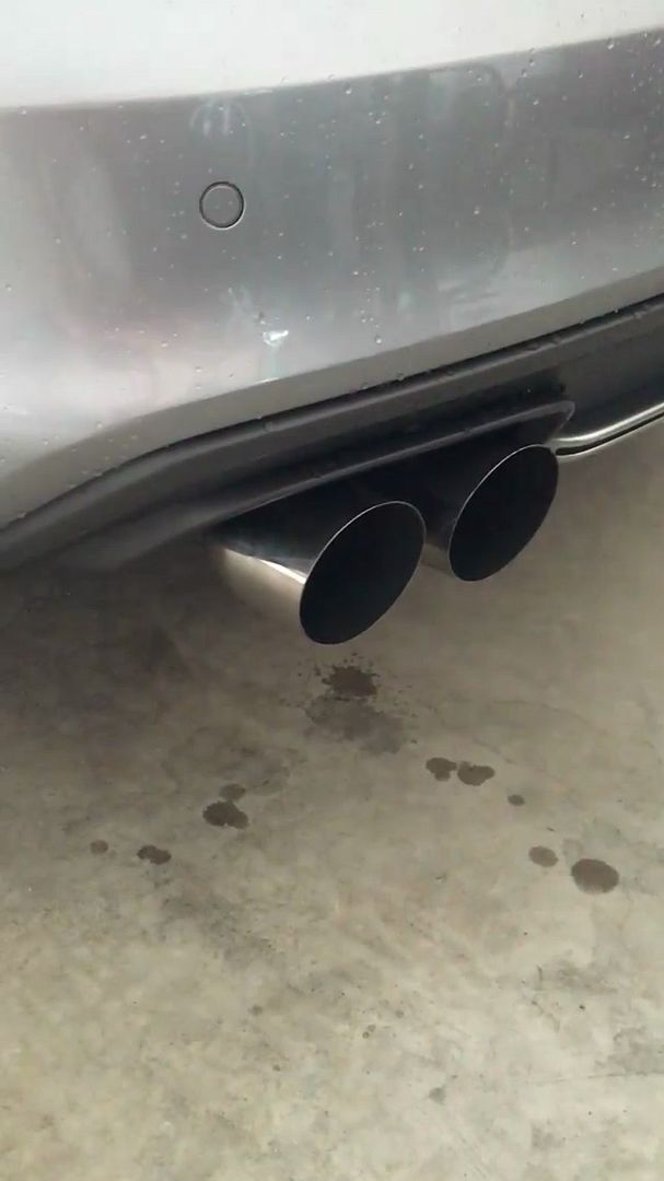

    Well I finished the exhaust mod today. I would love to have the Armytrix exhaust, but I'm about to deploy, so this will suffice for now lol..
    Anyways, I replaced the baby resonators with a non-resonated x-pipe, removed the center resonator and replaced it with straight pipes, and still have the oem mufflers. It's definitely a lot better than stock, but it's not the deep loud rumble I'm looking for.
    Still happy though, glad i read all 34 pages and watched every single clip in this thread haha.

    Quote Originally Posted by bayonet14 View Post
    God damn professional video haha. What was done to the exhaust?
    YouTube: DV Motions | Instagram: @danny.vuu @undisclosedm3

    Quote Originally Posted by USAF_Danny View Post
    Center res del - OEM muffler del - in house stainless Xpipe - and the same resonators/tips they use on their in house R8 exhaust build
    Just finished adding Dynamat - and R19 rockwool to the trunk area/spare tire to dampen the drone - think i may do under the rear seat next - cabin drone cut by 40/45%

    You should not have to replace anything in section one - the sound/video clip you posted - cant be a true representation to mirror... that cars set up as its European Spec (Not N American) remember - on a Euro Spec car the catalytic converters (above the section in the red box numbered 1)(thats N American to meet emission standards) Euro spec those cats will be further down stream on the down pipes- Just trying to save you a few bucks - pretty sure why some only do the Xpipe and retain OEM mufflers
    Just my 2cents
