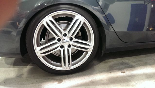

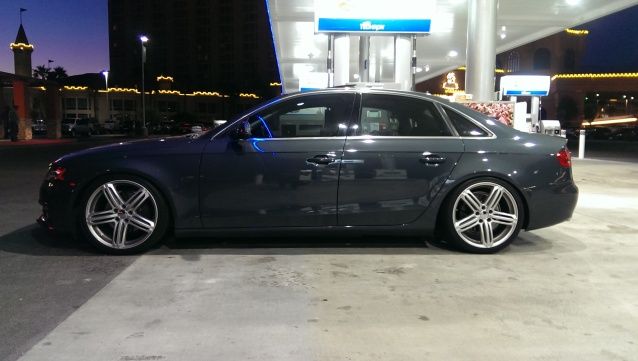

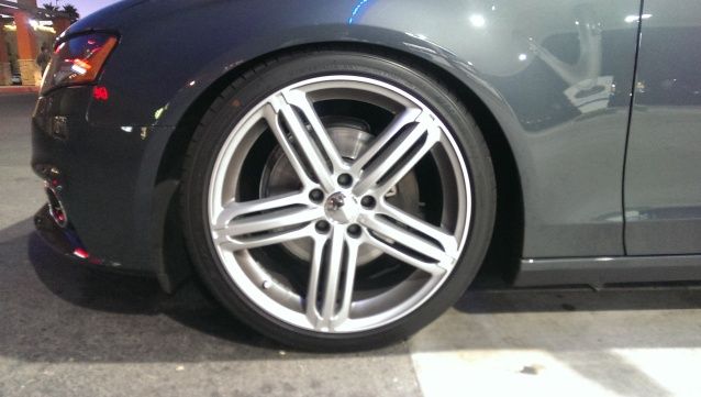

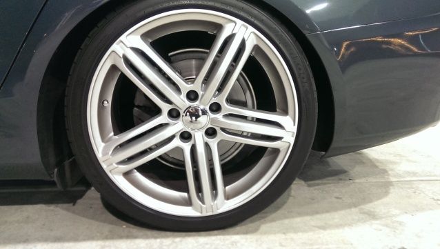

    Hey guys,
    I imagine the S4 B8 has a different wheel well width than the A4 B8, which is what I have. I'm trying to find out whether the 19x9 et33 A5 S-line peelers I got yesterday will rub on my lowered ST coilovers suspension. Did the original poster (OP) ever find out whether the 19x9 et 33's ended up rubbing? Is anyone here running this set up? I know it will work with the A4 and will not need any spacers, however, my concern is whether I'll need to raise my car a bit because I definitely do not want to roll the fenders.
    Here are pics so you can get an idea. These are aftermarket peelers 19x9 et 35 wrapped in 245/35/19 Hankook Ventus
    Front Right
    Rear Right
    Rear Left
    Front Left
