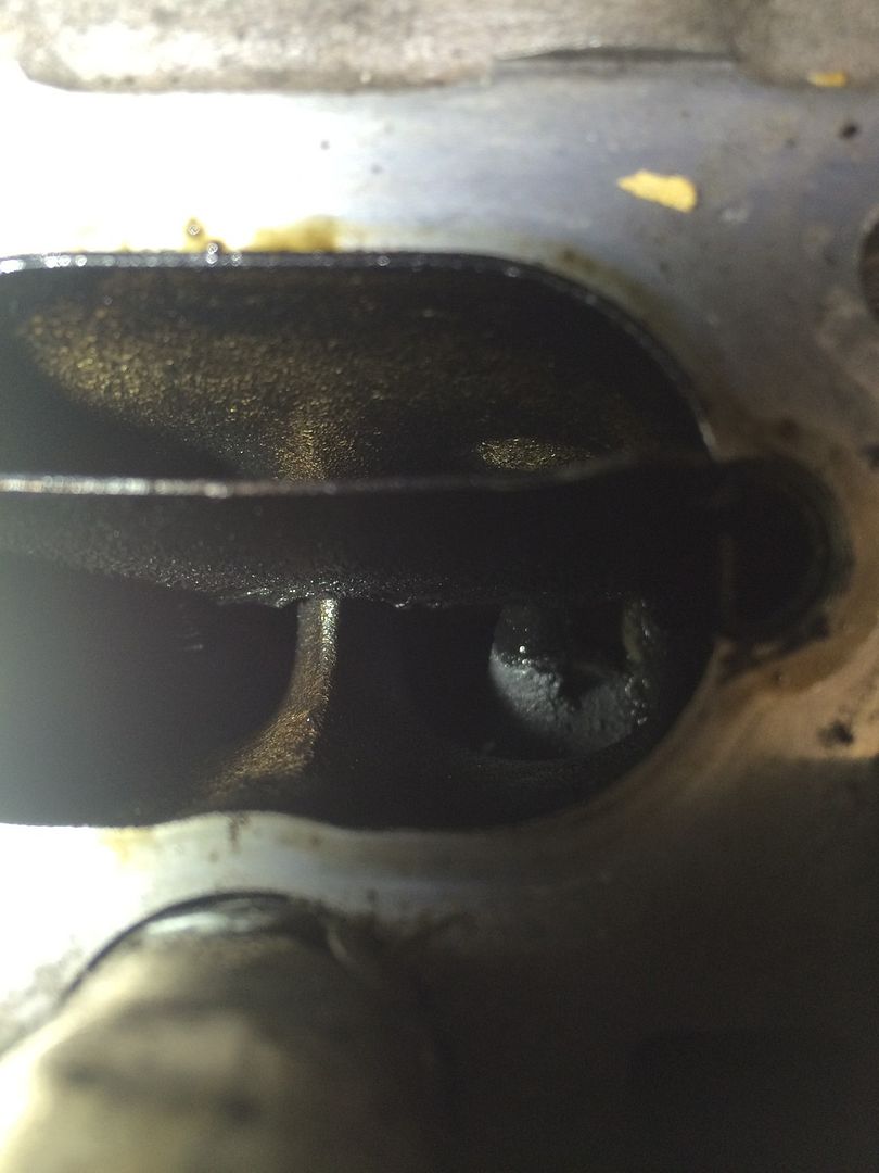

    [IMG][/IMG]
    '08 RS4 Cabriolet

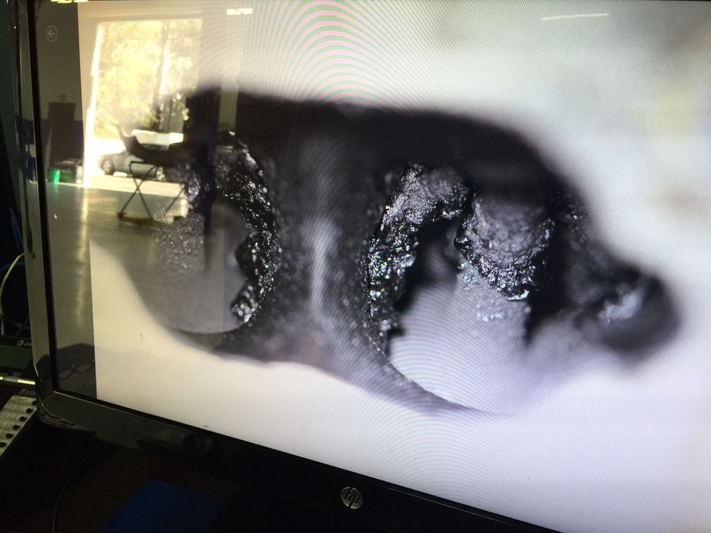

    Just had mine done yesterday. 60k miles, 1st one. [IMG][/IMG]
    [IMG][/IMG]

    That's getting pretty restrictive. I had something similar, plus at least 1/8th to 1/4" of build up along the entire runner length (the top was a lot worse). My port separators were actually bridged closed in many of the ports.
