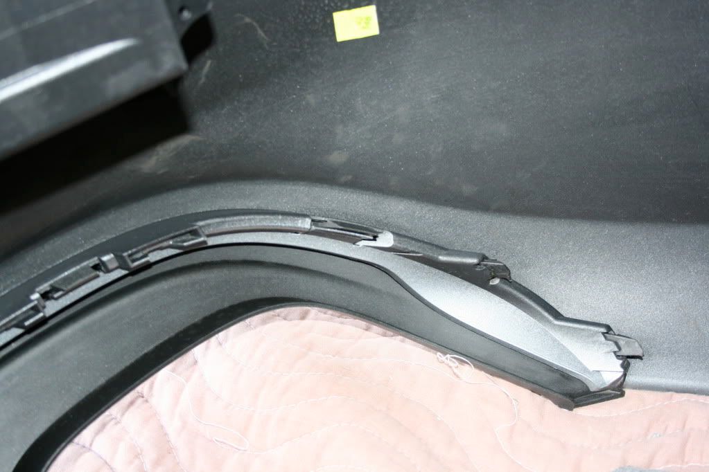

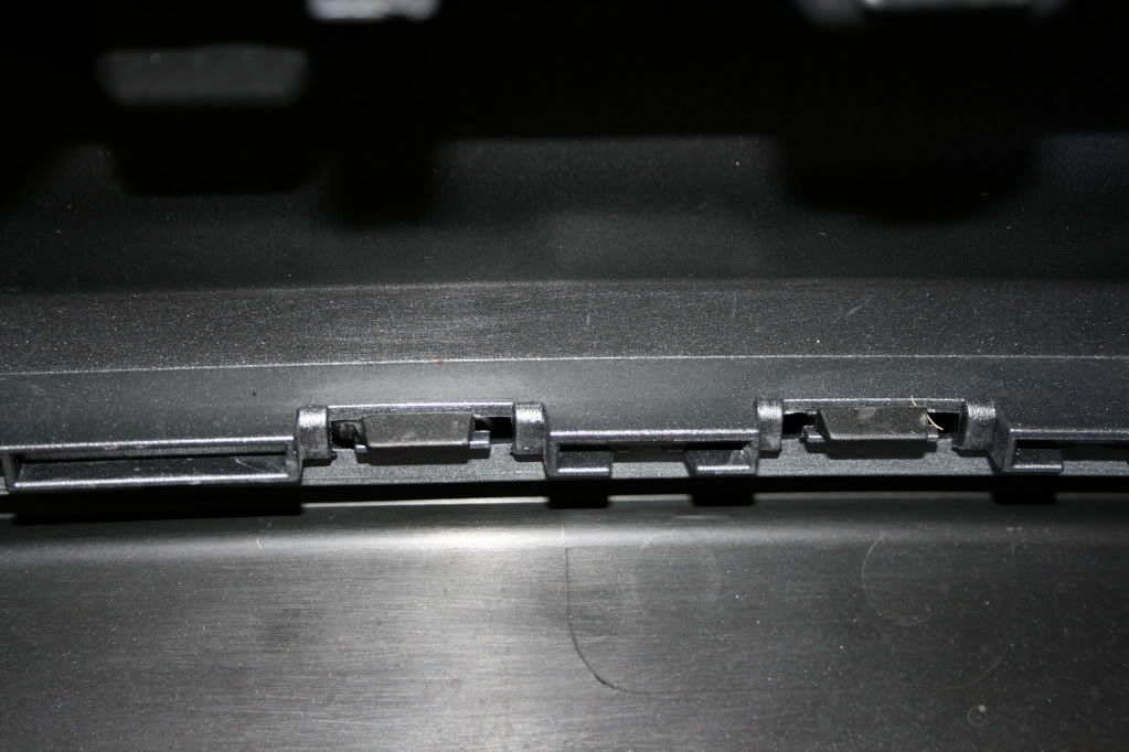

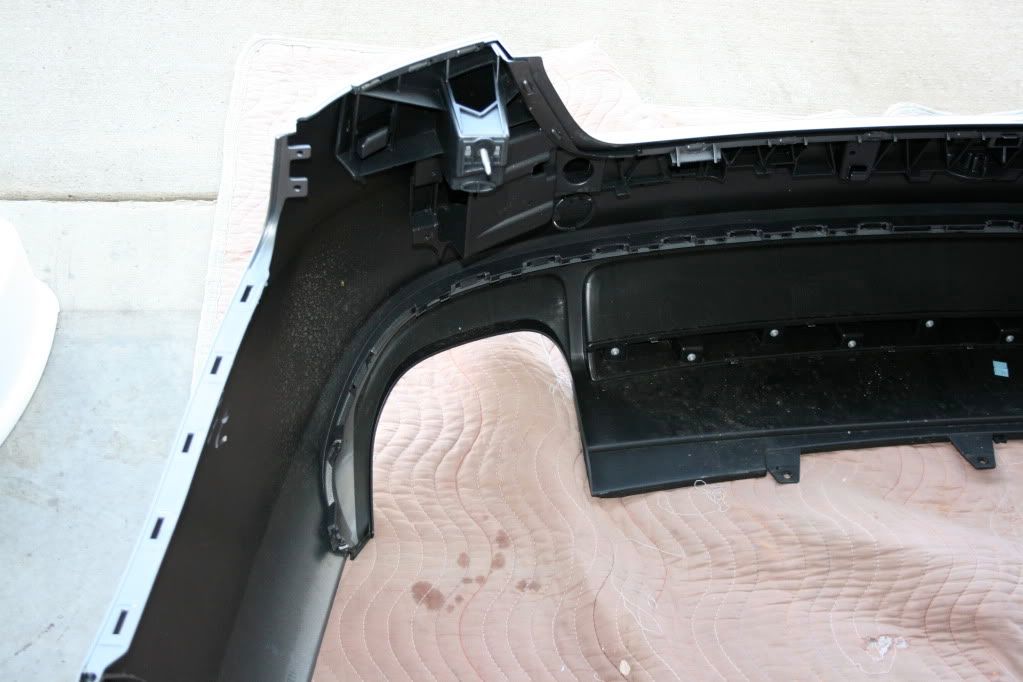

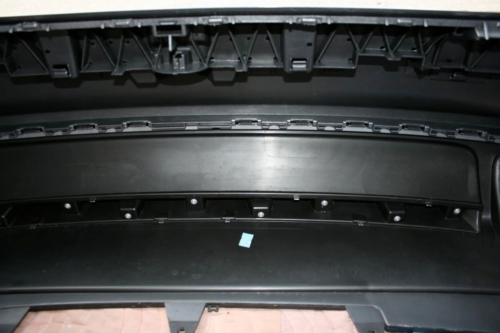

    Here are some detail pics of the bumper and the rear of the car with the bumper removed.
    As you can see, the rear valence is held on by various tabs. You can remove the rear valence without removing the rear bumper but you run the chance of snapping off one of the tabs. If you remove the bumper, you can go from the back side of the bumper and remove the valence tabs by wedging open the slots.
    Enjoy!
    Enjoy!
