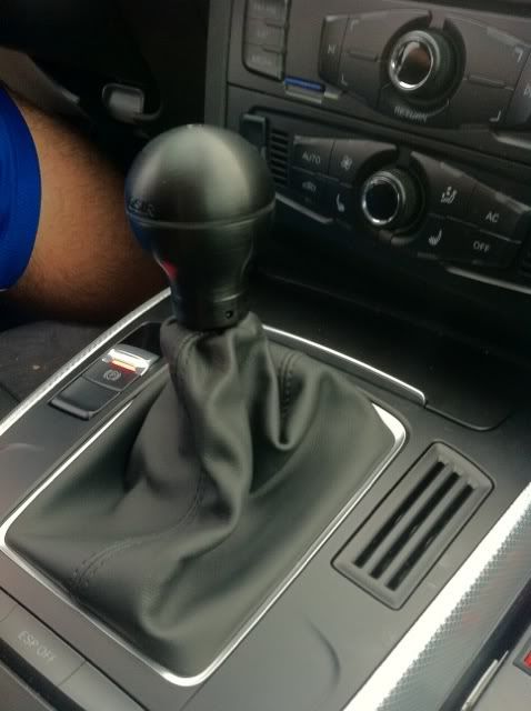

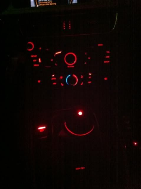

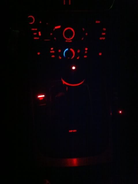

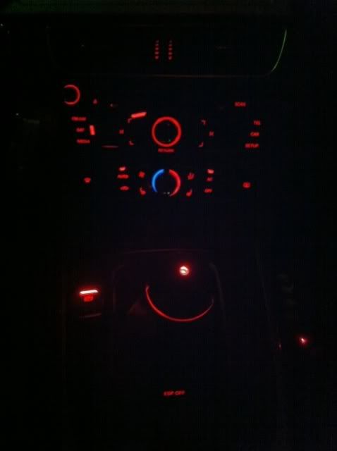

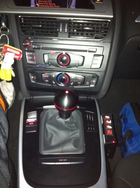

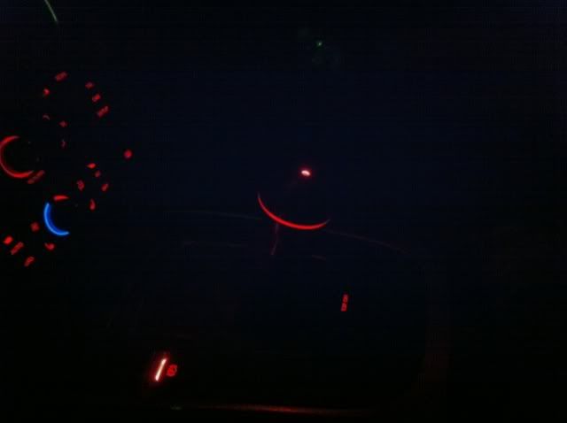

    I finally got a chance to put the knob on today. The knob was easy to put on, however trying to get the boot to look good was a pain. Since you cant use the clamp thing which connects the boot to the stock knob i had to come up with a new way of getting the boot to stay close to the knob and not look like crap. Here are a few pics of the knob let me know what you guys think...

    Are you happy with it.....?
    Or looking for honest feedback?
    Senior Member Three Rings Speedybrit's Avatar
    Apr 15 2010
    57698
    Im happy with the knob, but im thinking maybe the brushed silver would have been a better choice. The boot is kinda eh right now i still need to think of a better way of keeping it up. Ill take honesty theres no harm in it lol

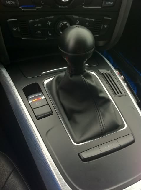

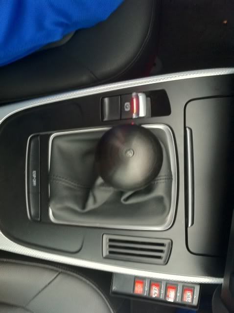

    Ok then, I can't help but think it looks a little perverted with the glowing one eye......sorry.
    Maybe a take another pic showing a better angle of the knob so it doesn't look so out of proportion. (Looks really bulky)

    i think its super cool, but i wouldnt wanted in my car, that was really creative!
    i would like to see one that makes the gears light up red in brush aluminum.

    @MW - I agree it does look a little bulky but it doesnt feel that way. Below are some day time pics which should show you the knob a bit better, but looking at these pics the knob does look really BIG but its not that big in real life. I think its the auto focus on my phone which is making it look way out of proportion.
