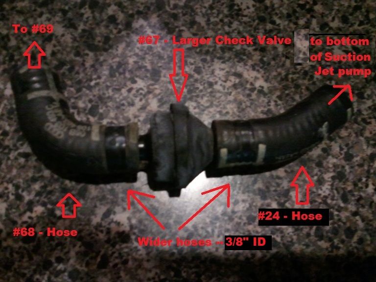

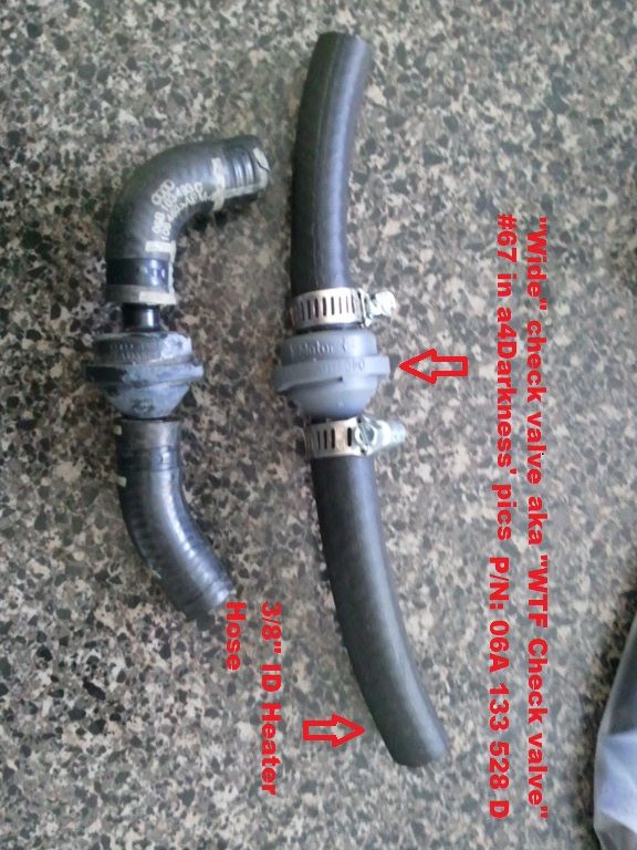

    So just to confirm in my own mind, the valve with number 67 (large check valve) is in fact part number 06A 133 528 D?
    Senior Member Four Rings spector's Avatar
    Sep 08 2009
    47478
    SE
    yes:
    FYI, do NOT try and do what I did there with the heater hose. The angles don't work. I kinked the shit out of that hose when I tried it.

    Quote Originally Posted by spector View Post
    yes:
    Thank man! Yeah, I tried to do use heater hose on some other spots where angled hoses were used...didn't turn out too good lol

    Ok, so I just searched for the WTF valve....couldn't find anything...does anyone have a link where I can buy one of those WTF hoses?
    Veteran Member Four Rings a4darkness's Avatar
    Dec 01 2007
    23015
    San Jose CA
    Quote Originally Posted by tapA4 View Post
    Certainly.
    ECS
    http://www.ecstuning.com/Audi-B6_A4-...ch/06a133528d/
    GAP
    http://genuineaudiparts.com/
    (enter the number 06a133528d w/out spaces)
