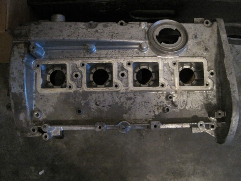

    I'm gonna disagree on this one, retain the the 3-way check valve Waldo. This area is really sensitive to minor changes in pressure and whatnot. Exactly like yourself, I found it really annoying to need a special check valve here but as you can see it's tied into a number of lines in the area and if you start slightly pinching lines back there it messes with everything. Saying $15 isn't worth the hassle man.
    (Chris, this shot has been so helpful... thanks again.)
    Waldo, if you don't want to spring for the OEM or less expensive version on Amazon, I've found you a $12 eBay special. Gitit son!
    07C 133 529 A
    http://compare.ebay.com/like/2708696..._lwgsi=y&cbt=y
    You probably don't even need two as the "t" is after the check valve.

    Calvin, the reason that there are two different coil pack adapters from IE is because one is for our 06A block and one is for the 058 block (and 2.7t as well IIRC) The valve covers are different so a different adapter had to be made to use the 2.0 TSI/FSI coils.
    Edit: No boot needed if you purchase the adapters Calvin. That's why you get the adapters The reason you put the boot on is to create a form of seal on the coil pack. Since the TSI/FSI coils are longer, having the boot on the bottom helps keep it into place. If you order the adapters the seal that is already on the TSI/FSI coil will seal against the adapter. Look at my project thread, I took a few pictures of them on there, that might help clear some of these questions up.
    The 06A has a round ridge around the CP and the 058 has a square ridge or something.
    Some early 06A valve covers like TT225 and some other transverse also use the bolt down coil packs. Any valve cover that uses the bolt down coil packs has a different design and will use the square adapters, while all the valve covers that came with push down coil packs use the diamond shaped ones... they will both actually work either way, it just matches the valve cover and looks more visually pleasing to have the right shape adapter.

    Early "bolt down VC" Notice the square shape around the coilpack bolt down area.
    This is a push down VC, notice there is no square area.
    The bolt holes line up the same, and both adapters work on either VC. The diamond adapters just look really strange and have a odd gap when installed on a early VC. All B6's should have the newer push down VC, so the diamond style is fine for all of you.
    -Tyler-
