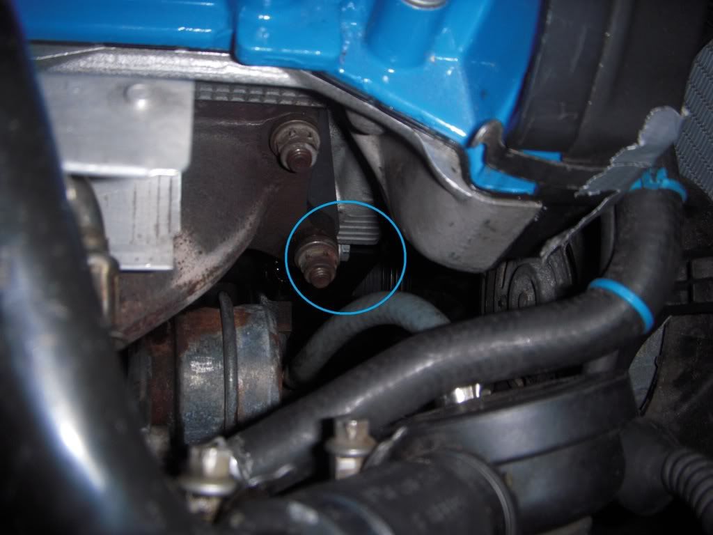

    Drips from here so the leak has to be near:
    Brilliant Black 99.5 A4 Project V8
    Nogaro Blue 01.5 S4 B5 RSFaux
    Glacier White 15 Q7 TDI Sport Edition
    Poopoo Brown 80 5000s Diesel
    Audi R8 certified technician - PM for work local to Chicago/Northwest IN
    Alex
    Jun 21 2009
    44025
    Topeka, KS
    Quote Originally Posted by NeedingAnAudi View Post
    You just made my month. Thats exactly where min is leaking from too. I was starting to get super pissed because I just did a headgasket and now its leaking oil super bad. Did your timing belt get soaked in oil as well? I don't remember if i changed out the cam seal or not, but a cam seal is sooooo much better then a cracked head which is what i was suspecting.

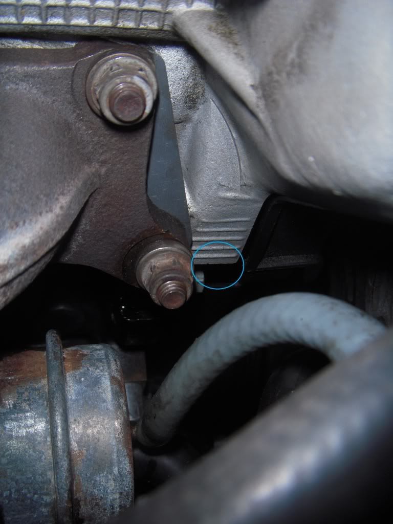

    Got the engine up to temp and I still have the oil leak! From between the head and block right under cylinder 1 exhaust manifold port. Everything else is dry, this is a bad leak and I no longer have any ideas besides cracked block and/or head.
    I've searched and searched and searched, but i seem to be the first person to have this oil leak. Anyone know anything about this?
    Alex
    Jun 30 2008
    30427
    Erie, Pennsylvania
    Cam seal? The way the engine is tilted, stuff tends to run downhill. Had a car with a really bad VC gasket leak, and that area you point to there was just covered in nastiness from the oil. Right on the corner of the manifold and corner of the head there. I hope it's something simple like that and isn't major.

    walky_talky - I think the leak is coming from the cam seal. Even though it is a brand seal I'll replace it and see what happens

    So I took it apart. AGAIN. Replaced the cam seal like Walky suggested and I think that did it, wish I had checked that before I took the damn head off.
    Also, I wanted to share my small feat that is actually huge, when I bought the car every light in the cluster was on, like this:
    And now today, I have fixed everything except getting the airbag light reset ( since I don't yet have vagcom )
