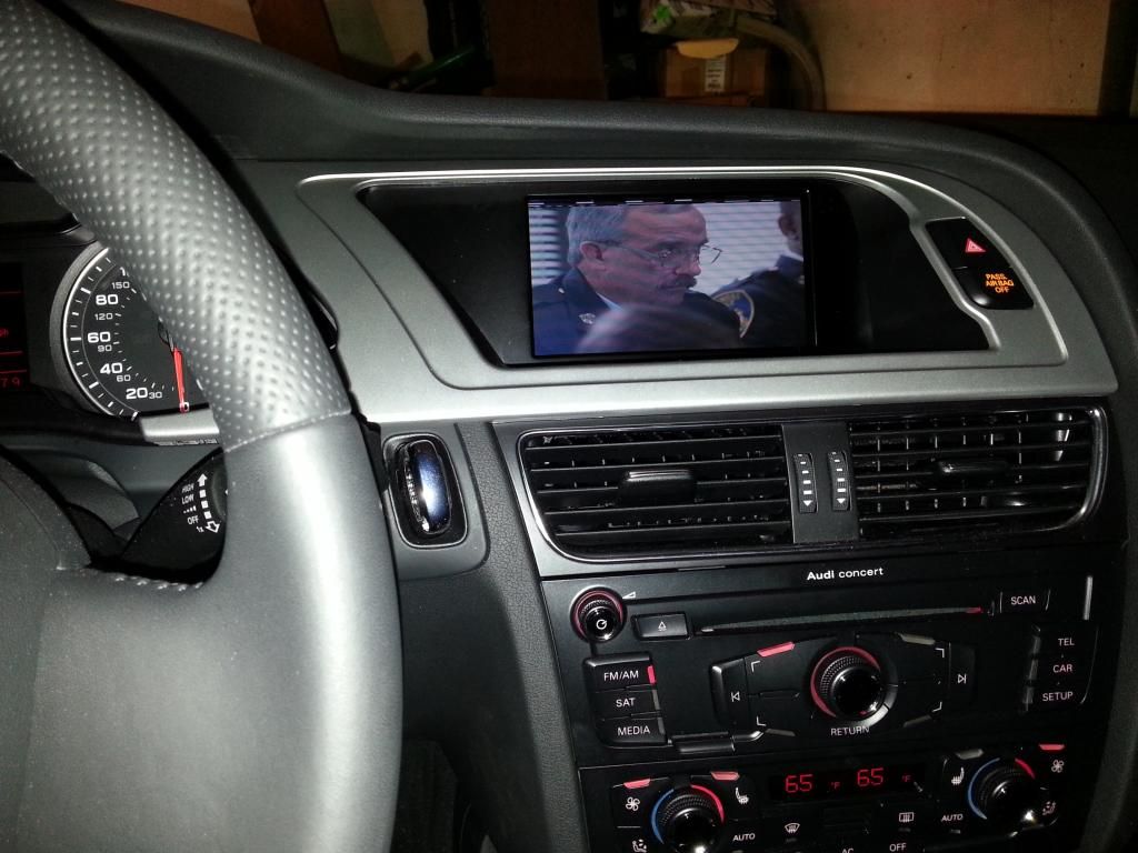

    Got the video working finally! Thanks for the tips Booya!
    2012 Audi A4 Premium +MT, Quattro, Xpel bra, SLine BBS CI-R 20x8.5 ET 32
    Mods: APR HFC/DP, APR K04, Bilstein PSS10 Coilovers, Okada Coilpacks, AWE Boost Gauge, Eurocode SSK, OSIR CF Spoiler, APR Carbonio Intake, AWE Exhaust, OSIR CF valence, ÜSS Adjustable Stabilizer set, Alu Kreuz, RS4 grille, Fluidampr,Apikol differential, folding mirrors,Brembo GT BBK, Deval CF splitter,ECS skid plate, RS4 rear brakes, Snow performance Stage3
    Senior Member Three Rings yma4's Avatar
    Dec 27 2011
    85785
    San Diego, CA
    ^Looks great kw! Is the video from DVD or phone? If from an iphone, would you mind sharing the exact cables needed to get this working? I want to be sure I have everything ready for when I install my XCL. Thanks in advance!

    Quote Originally Posted by kwbdc View Post
    Do you have noise on at the very top edge of your screen. It appears like you might from this pic you posted. I am sometimes getting a little with the reverse camera.
    Veteran Member Four Rings kwbdc's Avatar
    Mar 29 2012
    90872
    2006 Mazdaspeed6 RIP
    Seattle/WA/United States
    Quote Originally Posted by B G 8er View Post
    Haven't noticed it from the backup camera. Still working on sound on the dvd. My dvd has a FM transmit out but doesn't seem to work.
    My signal's been clean lately.

    Ok so I plugged all the audio cables in that you recommended and still no sound :( ....what do I do!!?? Lol

    That's a good question and I don't know....I got audio working though (kinda) :)

    how did you kinda get them to work?

    Lol its kind of hard to explain but I have my video cables and audio cables running seperatley in/out of XCL....idk why but not all devices I plug into my XCL send audio. Sorry if that makes no sense - I still don't understand the XCL fully
