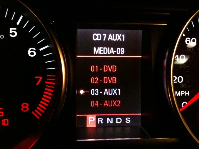

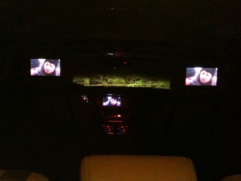

    So after installing my rear head rest monitors, I decided that I didn't like having the FM modulator for sound. I already had the x-carlink unit, so I ordered their MOST system. The X-carlink Most system, just allowed me to access 4 different audio inputs managing the sound directly through the stereo. It shows up as the 7th CD and once chosen you get to choose from the four options. Did not interfere with my AMI, Nav, or CD player.
    Picture of DVDs playing through all the monitors in the car. Apologies for the bad photos, it was taken with my iphone. I'll be posting a DIY in a few days.
