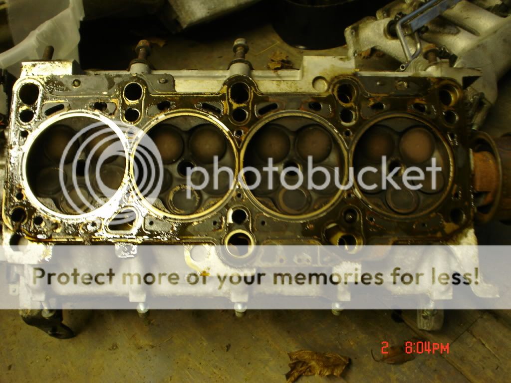

    Does this head have signs of bent valves or any piston contact?

    Pull the cams out and fill the intake and exhaust side with brake cleaner or other solvent. Check for leaks.

    look at he pistons if there is any marks

    looks good from here

    Quote Originally Posted by A4Rob View Post
    +1, if it's bad you can physically see the valves not seating where they're supposed to be

    Quote Originally Posted by VMRWheels View Post
    x3, simplest way to tell, other than if they aren't contacting which is easy to tell.
