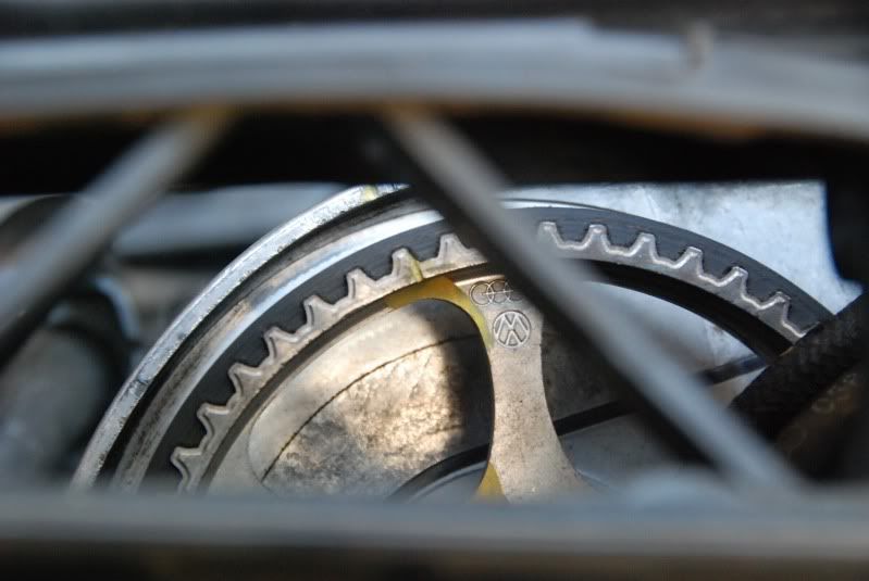

    m0nkey, if you are going to do the leak down test, do you understand my reply in post #90? In addition, you do not need to remove the front end or drain anything to do the leak down test.
    You might be able to get a pic of the front crank pulley and alignment marks using macro focus, for really close up shots, otherwise I don't think you can, except from a sideways view. You can also try using a mirror and taking the pic shot at 90 degrees from straight on.

    Quote Originally Posted by diagnosticator View Post
    I've done it with the front end on... the trick was getting the lighting right and wiggling the 19mm socket on and off.
    Also, here's the other pic we need:

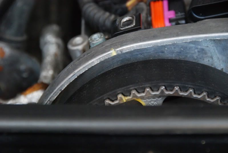

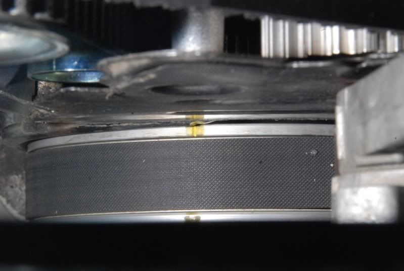

    Ok guys i got it now! I know for a leak down test you dont need to remove anything just the spark plugs and move each cylinder to TDC. And as for making sure the timing is inline ill check that asap! seem easy enough. I thought you had to remove the lower timing belt cover.
    *I did not bolt down the alternator bolts all the way down would this cause any problems with my timing?*
    Thanks everyone for all the help i really appreciate it

    Well here is the pictures

    Well, you can rule that out, it is right

    Active Member Two Rings m0nkey's Avatar
    Apr 08 2010
    57331
    Houston , Texas
    Quote Originally Posted by mjfrizz View Post
    that ticking sounds like your lifters. after i changed my belt, i had the same noise. If your car sits there for a few days they can get dry....once it warms up and everything gets lubed it should go away
    Thats really great to know! But im going to change out my timing belt again because I streched the timing belt over the tensioner roller and i now have indentions on the roller from the flat head and after reading around i found out that is bad. So im going to do attempt 2 which should be easy since i know pretty much everything now. haha
    I have a dumb question....did you say all four alternator bolts are half inch from being flush? If so...maybe you put the alternator in upside down. Reason I say that is that I changed my thermo two weeks ago, and when I first tried to bolt it down, I got all four bolts started but they all stopped about half inch from being flush. I flipped the alternator around and everything fit flush.
    Yeah i was thinking about that but i never got around to switch it up, but im going to do it once i get my new timing belt and tensioner roller in.
  35. #115
    Apr 08 2010
    57331
    Houston , Texas
    fired her up again to see if it would sound the same, but it sounds louder now. It seems as if it sounds louder when its hot with high humidity and quieter when its cooler with lower humidity.
  36. #116
    Apr 08 2010
    57331
    Houston , Texas
    Could it possible be a stuck lifter? since its been sitting for a while? Also when i rev it the sound gets louder.
