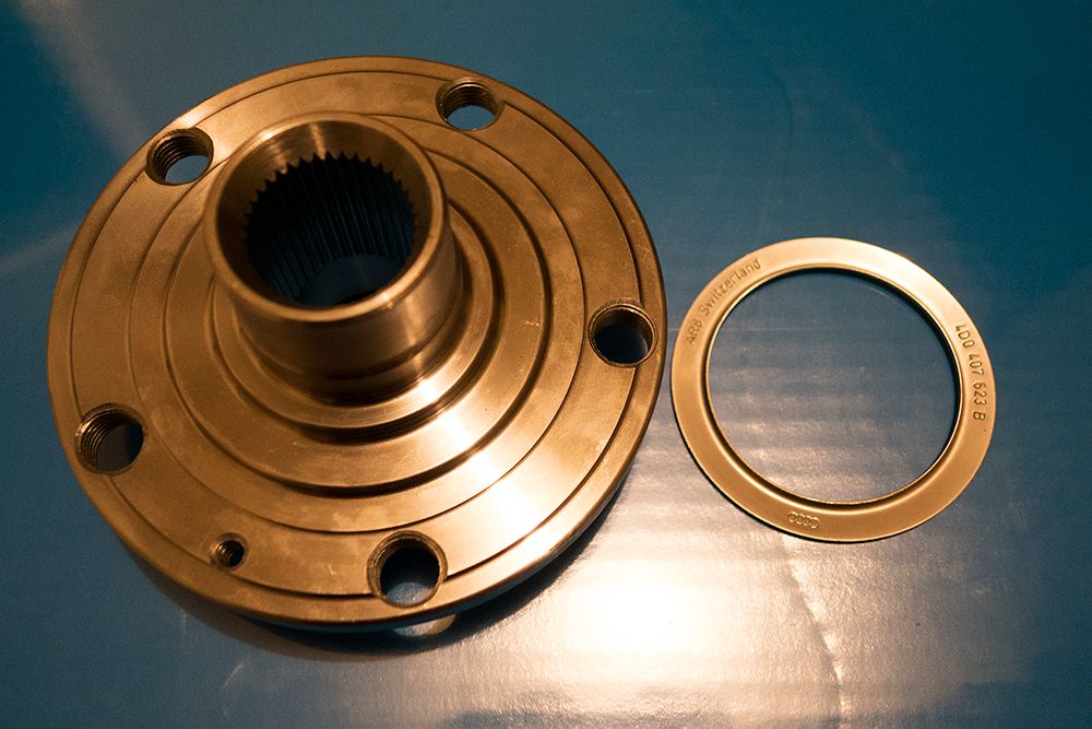

    Great writeup! Anybody order the SKF wheel bearing kit and did it come with a dust ring? Can someone tell me which way to press the dust ring on the hub prior to pressing the hub on the wheel bearing? I've attached a picture showing how I was going to press it on. With the lip facing up and away from the hub flange and towards the wheel bearing. Thanks.

    Scratch that I got the answer I was looking for. It's not even necessary for this style of hub. It's for the lightweight hubs ie: 4B0407613B

    Is the dust ring needed on B7 RS? I have everything off except for the hub/bearing now. Stupid thing is seized. Hopefully it loosens a bit due to penetrating liquid wrench overnight.
    Also, ring on one side of bearing seems to just come off. Is that the side that needs to be pressed in towards the hub? I didn't know if I would get the answer once I get the bearing off (still hopeful)... Thanks!
