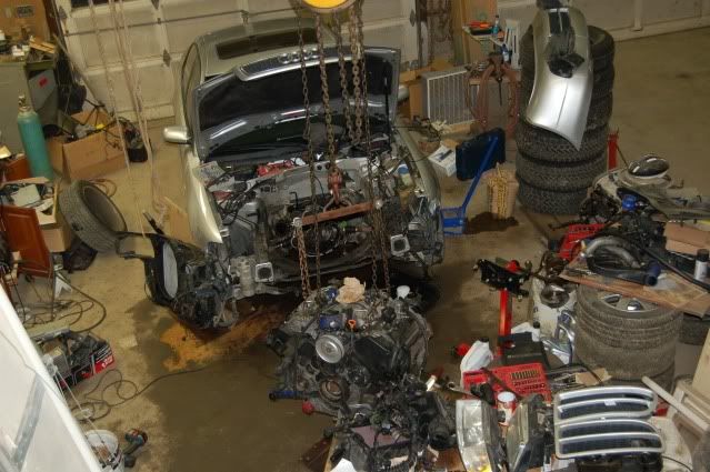

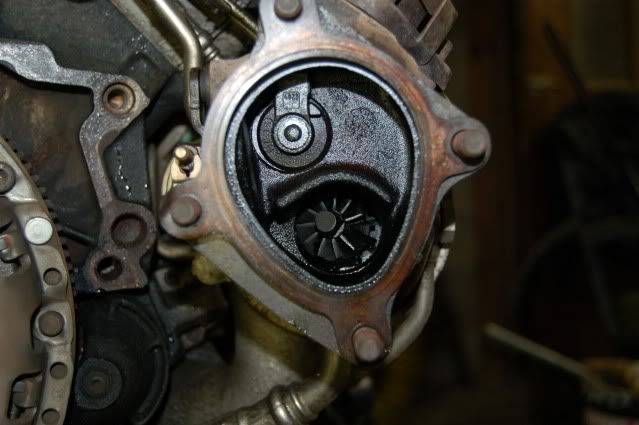

    When you spend a few days pulling the engine out and installing these RP turbos, drive the car for a few days and start hearing noises and see drops of coolant on your driveway, realize you have to pull the engine out again, spend about $200 again for new install kit and fluids, and realize that you could have just done it once and done it right then you will feel like how I am feeling right now.
    I am more angry with myself than anything else for being so cheap in the first place and how much I am ending up paying now. I am just trying to prevent people from making the same mistake as I did because there are still quite a few people trying to decide on these turbos, which is seriously alarming in my head after all I have seen personally and what other people have reported.
