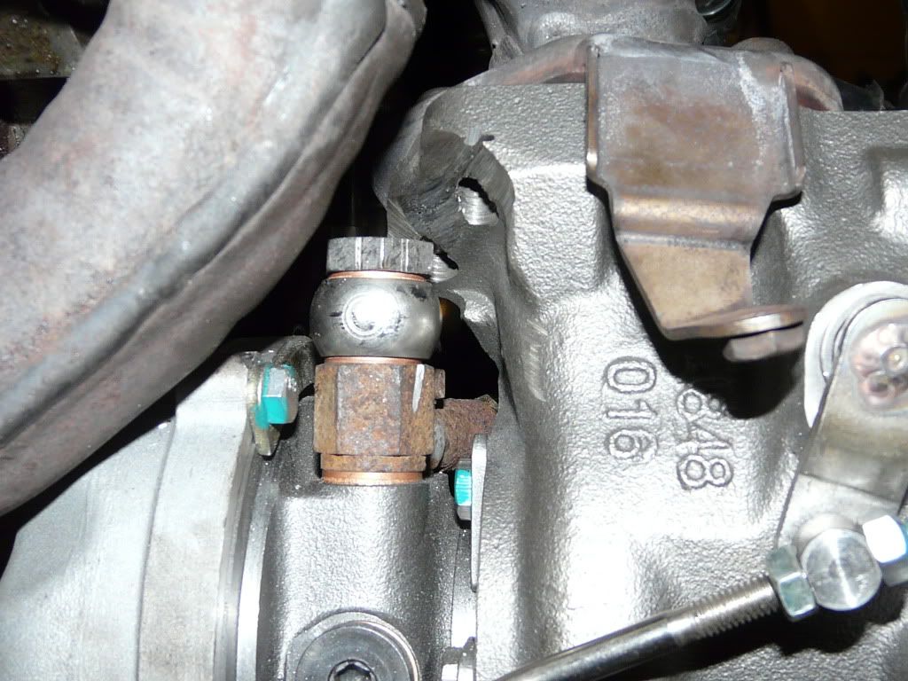

    lol same as me! i told my buddy the problem with the coolant plug and he checked it out, he also said the fitment on these are shitty.

    I did NOT grind anything at all to install mine. I was waiting for getting stuck on something and finally seeing what everyone was talking about, grinding stuff and all, but I managed to install them just fine and everything came together nicely. Where exactly do you people grind?

    What washers are you guys talking about exactly? I've had a minor coolant leak on my drivers side turbo since installation but haven't figured it out yet. It's so minor I haven't lost any sleep over it.

    The washer on the plug on the side of the turbo. It's a plug you need an allen socket or wrench to remove. It has a copper washer on there. Be careful when you take the plug off, you will have quite a bit of coolant pouring out of there. It's not hard to reach from under the car, I replaced mine in ten minutes, I just had to figure out a way to drain that coolant without spilling it all over. Once I replaced the crush washer I haven't seen a drop of coolant from there or anywhere else for that matter. I just hope I don't have some of the problems others have experienced. There are people who have these turbos and have ran them with absolutely no problems. Seems like only the problematic experiences are being shared here. I don't believe they are like the Chinese crap K04s and JHM already has proved that. This batch does have a bad washer on the turbos but that's an easy fix. Some of the other issues are issues that happen on other turbos as well. I guess more time will tell for sure. At this point I am just praying I don't have any problems with mine. My car should be on the road by the end of the weekend since my new fuel rail arrived today and I can pop in my new injectors with the Vast stage 3 tune. We'll see what's going to happen.

    Quote Originally Posted by 97B518TQM View Post
    Cool...thanks man. I'm gonna go have a look at mine to see if that's where it's coming from. I thought maybe it was coming from that coolant line that everyone was grinding but I chose not to. Hopefully I can fix it in 10 minutes - but the problem is that I think it leaks sometimes when the car isn't even running. We'll see. I don't seem to be having the WG issues that others have had. Hopefully that won't creep up in the future.

    My plug was leaking without even starting the car. I filled the engine with coolant and before I even started it for the first time after the install I was able to see drops of coolant from that plug.
    And if you flapper gets stuck you will not be able to build full boost. If the actuators are messed up then ya, boost won't be consistent.

    Quote Originally Posted by chebert69 View Post
    I found this when installing mine, i just rotated the CHAR ;-)
    Noggy S4 B5 Avant | 19" RS6 C6 Reps | H&R Springs | Full RS4 Exhaust System (Gutted DP's, Custom Tips) | BMC Panel Filter | 710n's | After-run Mod | RS4 Intercoolers | 034 K04 Inlets | RP K04's | MRC Remap

    Quote Originally Posted by drkenan View Post
    I wonder what ever happened to AudiGeorge?
    Pretty sure your boost would be jumping all over the place. Read that long thread started by AudiGeorge awhile back. He was the first one I heard of who had those problems.
    For the coolant leak also check your aux water pump. If it seems like its draining randomly and sometimes after the car is off I will bet money its the aux water pump.
