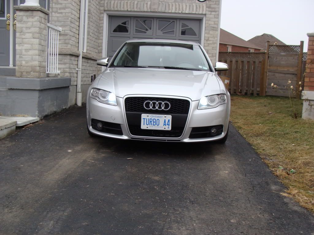

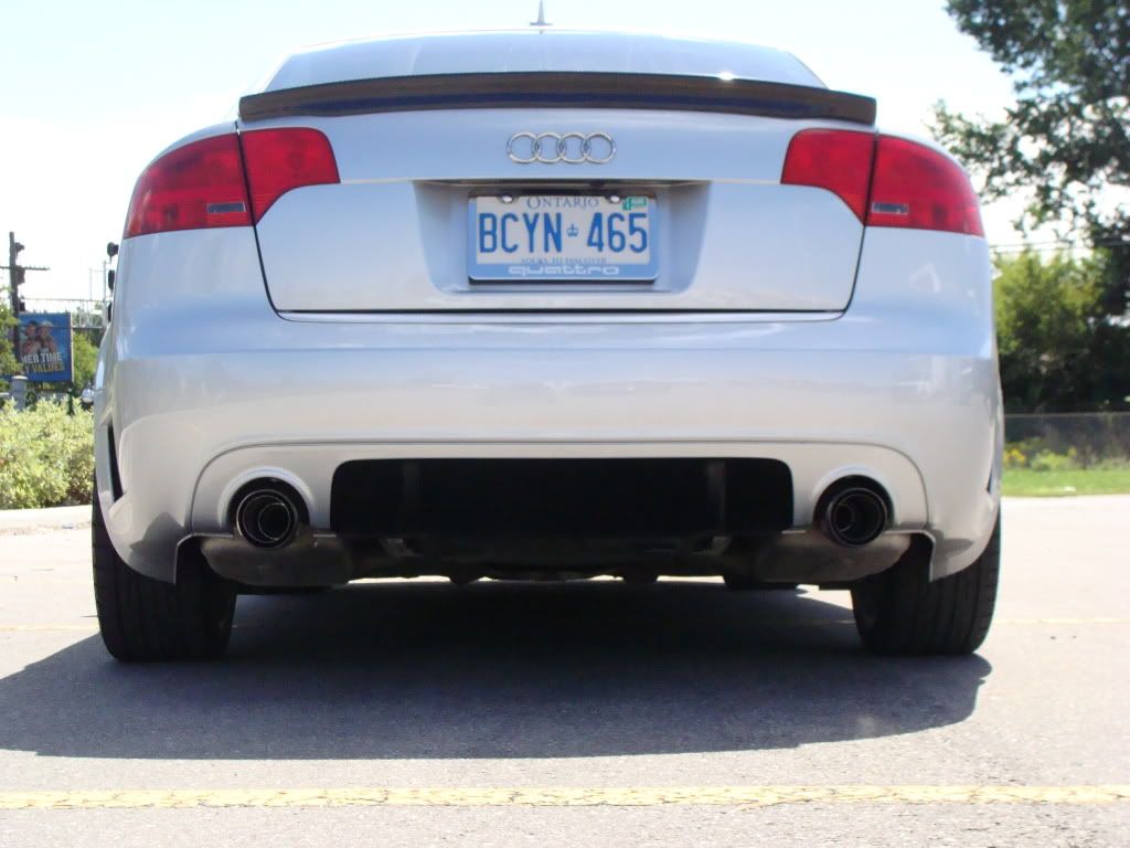

    Over 50 views and only 1 reply! wow. Maybe I should have posted a pic, lol. Sometimes I think the board is for posting pics and falming people. I am trying to create an informative thread, to help me and a lot of other members on here.
    If members post up their info, it will help people decide which DV would be best for their individuals application. Come on AZ peeps, stop being so lazy. Every single member with a 2.0T engine should be participating in this thread.
    here I'l post some pics

    p.s airbornrifle who did your clear corner on your car ??

    I did it myself with help from a friend.
