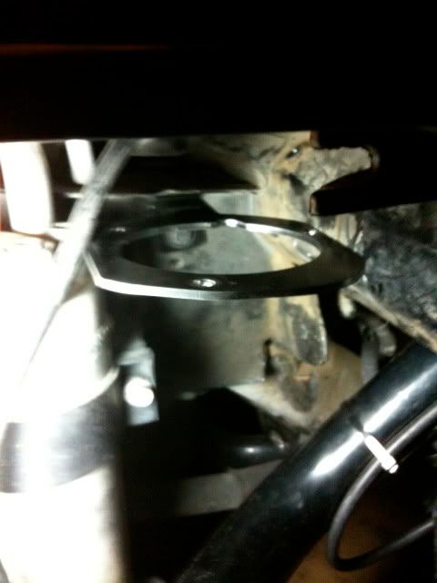

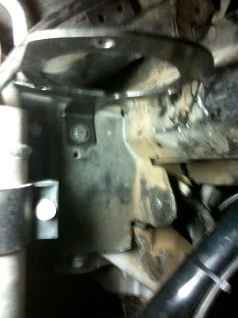

    Just got done installing the 034 HFC and ER SAI relocation bracket so I took a quick cell phone pic. More pics tomorrow.

    How much was the ER relocation bracket?

    $21 shipped to Fresno, CA. Plenty of room for the hot side pipe now.

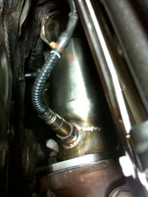

    Did you get any codes after installing the hfc? I got my 034 hfc in the mail today

    No codes, i got the APR catalytic delete file done.

    Also if you guys are planning to install the 034 HFC, I HIGHLY recommend getting the nuts(turbo outlet) from the install kit. The OEM nuts outside diameter is too big that you can't properly fit socket without hitting the pipe itself. I still used an OEM nuts though since I can't afford a down time. Only way I was able to tighten the bottom nut was with a short open end wrench which was a bitch due to no leverage.

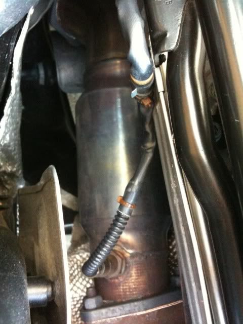

    Update on what it look like now.
