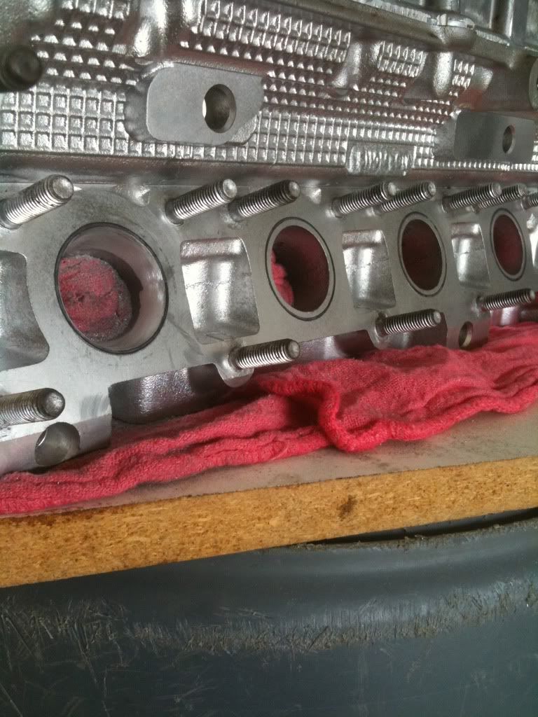

    Im assuming you mean like a "port n polish" I did quite a bit research on this and from what I read there really wont be any noticeable power gains. I was however warned not to port n polish the intake side as I could possible alter the predetermined volume of air in each cylinder. In other words each cylinder could end up with different amount of air due to turbulence and whatnot. Anyhow I grabbed the dremel and went to work on the exhaust ports. You can see in this pic the first exhaust port was opened up a little only to match the gasket. DO NOT go any bigger than the gasket. I would think that your best bet is going for a AEB head and Intake mani along with port n polish on the Exhaust ports. Sorry if im not much help.... BTW this is a AWM head.

    IDK that just doesn't sound right to me. Are the 1.8T motors real that good? For example I used to be into modding Dodge neon's (don't laugh they make excellent Auto-x cars) anyway take the 2.4 motors found in the SRT-4 for example they have a slightly larger turbo then i think a k04 stock and make around 230 stock CHP, if you take and just Port and polish the head you gain like 30CHP. Thats about what i would expect on a turbo car. I have seen pics of the intake ports on the AWM motor there really small. ( can't see the pics you posted from work but i will take a look at them later) Guess i will have to do the math myself. I just figured someone would have done this work already. Guess i will try searching Vortex too.
