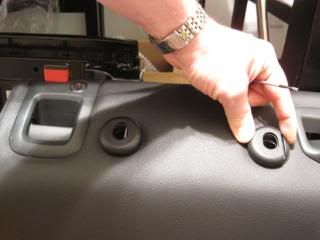

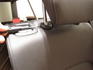

    help on removing rear head rest?
    Do any one here know how to removed rear head rest?
    T-Audi
    Veteran Member Four Rings DavidB8's Avatar
    Nov 06 2009
    50351
    Oakville, ON, Canada
    Yeah, there is a button on one side and a small slot hole on the other. Pull the head rest all the way up and then insert something small into the slot and push. It moves the retaining pin. Then you have to push the button on the opposite post and pull up. I know you need 3 hands but you can do it it's not that bad.
