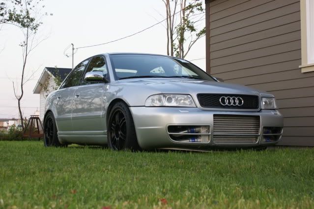

    here's pics of the car right now

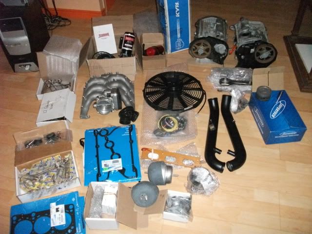

    And here're the parts I have in stock that are going on the car soon.
    B6 3.0l crank
    Supertech 82.5mm piston, 8.8:1 CR coateds skirt and designed to go with a 3.0l crank
    Rosten rods
    GURUMAN agtronic GT2860RS turbo kit
    GT28RS Vbanded turbos
    Agtronic tubular manifold (Vbanded for the wastegate and ceramic coated)
    3" stainless downpipes (Vbanded)
    Tial 44mm external wastegate
    dump tube
    inlet pipes
    034 anti-friction coated bearing (all of them)
    2.8l heads (34 000 km on them, ported to match gasket)
    2.8l HG
    supertech inconel exhaust valves
    Supertech titanium retainers and springs
    Devil's Own methanol injection kit
    RS4 intake manifold with TB port ported to 80mm
    034 DBC throttle body and conversion kit
    034 80mm TBB
    ARD coated bi-pipes ( 2"1/4 and already tapped for Meth)
    Vast high flow electronic fan kit
    Vast oil catch can kit
    Ferrea stainless intake valves
    Vast phenolic intake spacer
    Energy suspension bushing for the DTS
    Clutchmaster sprung FX850 twin disk clutch
    USP metal salve cylinder and stainless steel lines
    RNS-E
    Tilton proportioning valves for running with no more ABS
    Moroso catch cans with breather
    lot of seals and gasket...
    Parts bought after the beginning of the build:
    034 fuel rails, 034 fuel lines, bosh 044 in tank pump, walbro in line pump, aeromotive FPR, 034 fuel pressure gauge, poished HRE 540R in 19", raceware man stud, 034 non stretch head bolts
    So I think that's it for now
    Mike will also change the fuel lines and do the tune and I'm waiting for 034 fuel rail from Issam but that's it for now. Once it's done I'm going to get the car painted audi "brown teak metal" and I'll put the car on nice wheels (just had a deal from a guy here with mint 19" HRE 540R )
    big thanks in advance to GURUMAN for being such a nice guy always glad to share infos with us, who did me a great price for his turbo kit and who did bring the B5 platform one step further(IMHO). And thanks to Mike Rombotis who'll surely do a great job on my car, I think he's one of the main reason for the succes of Guru's builds, I wouldn't want anyone else to take care of my car
    more info to come as the build start, sorry for the weak english, I'm not 12 years old I'm just french ;)

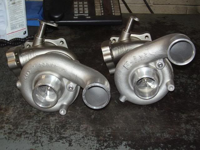

    sherif, what will you be doing with the 2554 kit?????
    Senior Member Three Rings Sherif's Avatar
    Sep 22 2006
    11892
    Brown B5
    Quebec

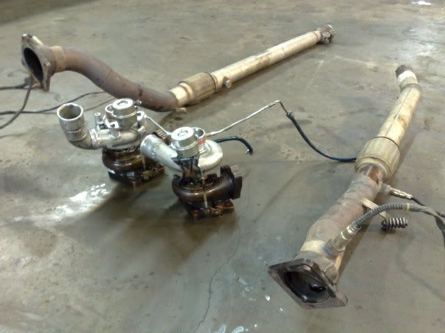

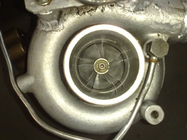

    I'll verify they have no shaft play (24 000km on them) and if they are still good I'll sell them.
    Asking price will be 2500$ for the turbos and inlet, but already 3 persons interested here... if none of the 3 take them they'll end up in the classified

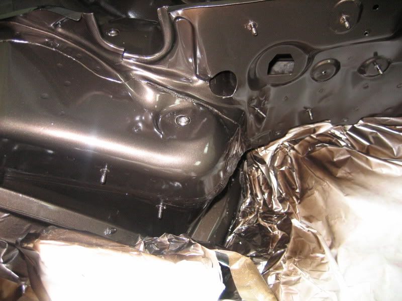

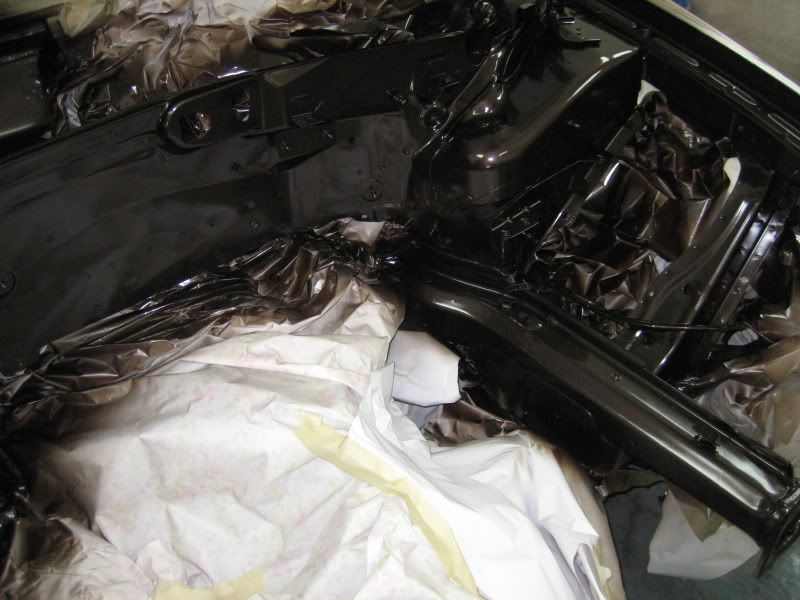

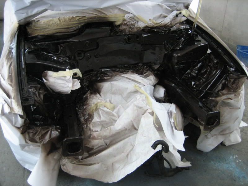

    Car is now in good hands, Mike should start to work on it today. I'll keep you updated with pics and more details as sonn as I get somes
    Sep 22 2006
    11892
    Brown B5
    Quebec
    Things are mooving way faster that I expected. Engine were removed monday, yesterday short block was disassembled and sent to machine work... who's supposed to get it done for friday! tuesday in the worst case.... so we will be waiting for the heads for sure.
    should have some pics for you tonight ;)

    juste received some pics of the car that were taken last monday
    turbos that went out
    not that bad I guess... here they are when I received them from Tial
    thanks to Ben and Mike for the pics
    Mar 01 2007
    16067
    2003 996TT, B6 A4 2.7t
    Montreal
    Hey Seb, here are a couple of pics of the painted engine bay... the color choice is AWESOME!
    Mar 24 2009
    40293
    New York and Toronto
